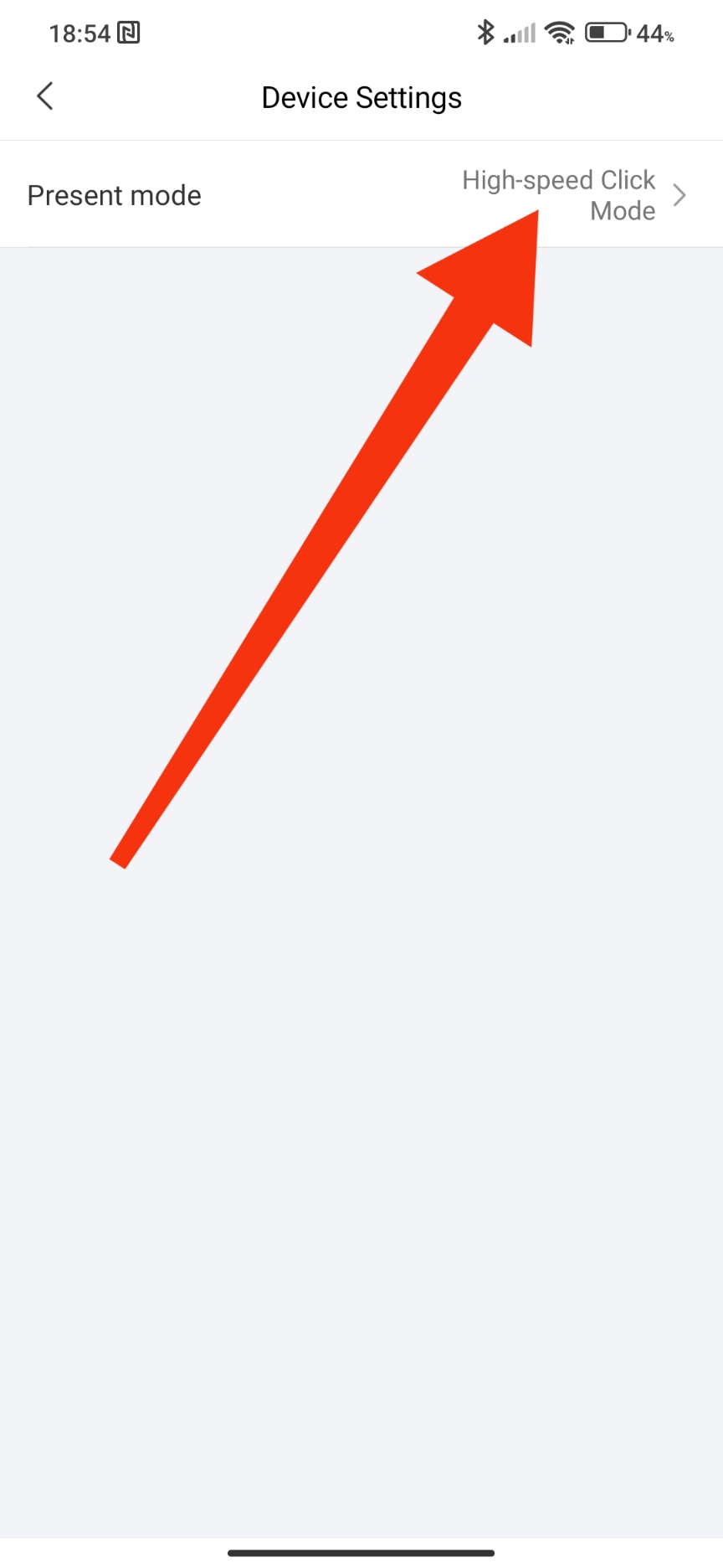

Maybe you need to disable the quick response function, in this mode everything is as different as one click.

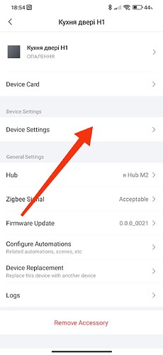

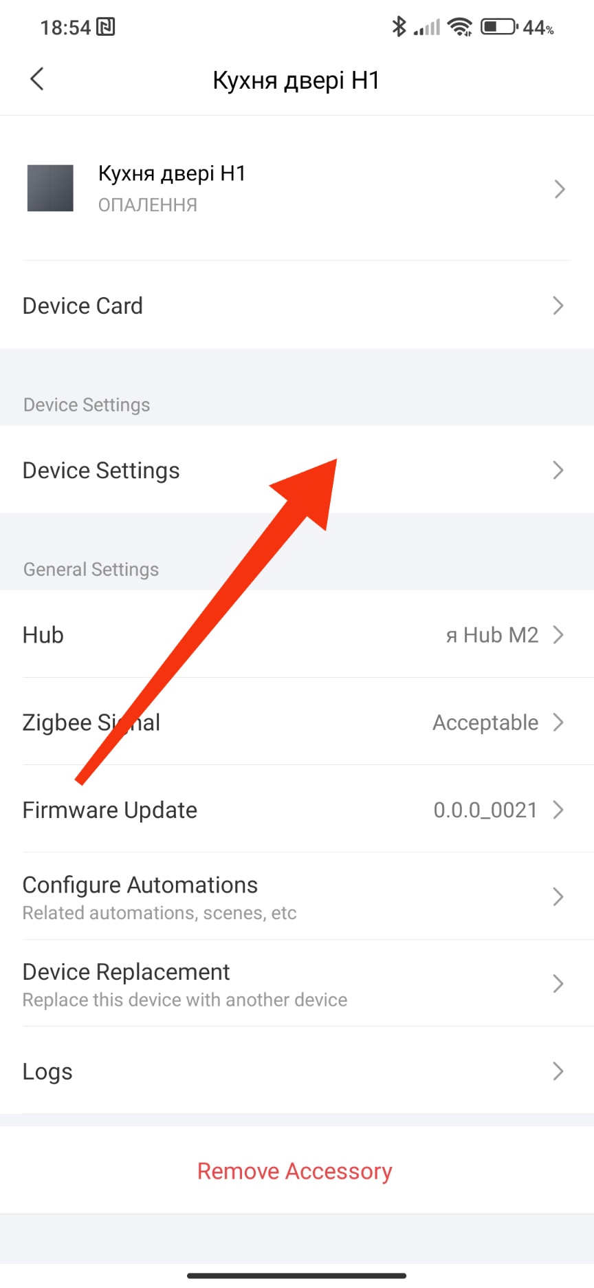

I have an H1 switch, look, you have this setting.
I found my answer in the switches settings. Both buttons 3&4 were configured with simple switch settings. Activated the multi-use and everything works now. Thanks for your quick reply gafich10.
Sorry Multi function not multi use is what needs to be selected in the switch’s settings
