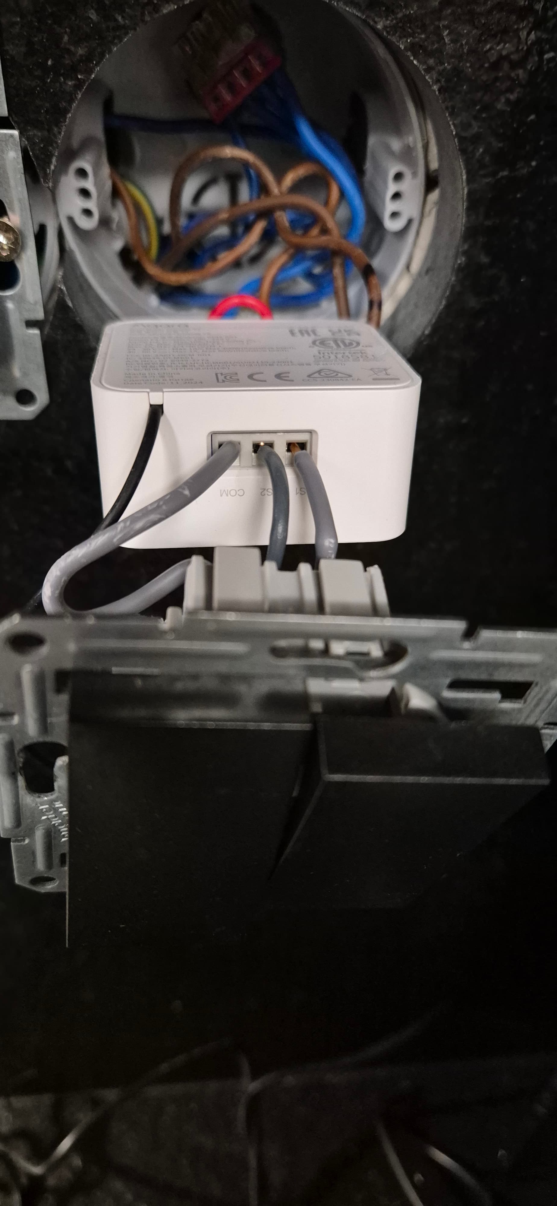

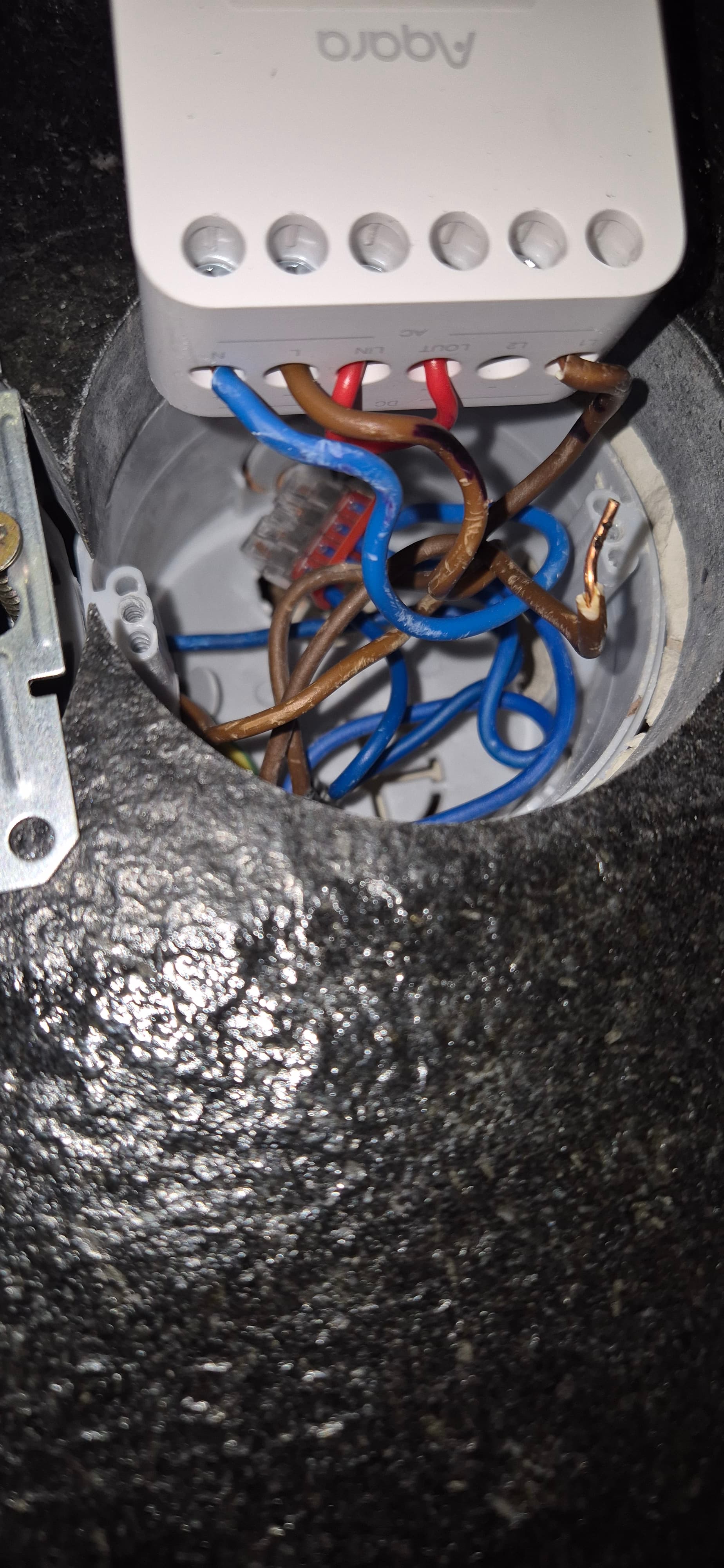

@gafich10 yes, the module is behind the wall switch, connected to 230V, with a neutral wire. After switching it power up 230V->12V LED adapter, which then powers up the LED strips.
@tupshall T2 relay is powered by 230V with neutral and each circuit has one LED adapter behind it.
The disconnect brown cable belongs to L2 (it is out because it would be permanently on)

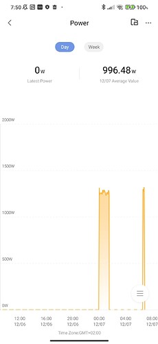

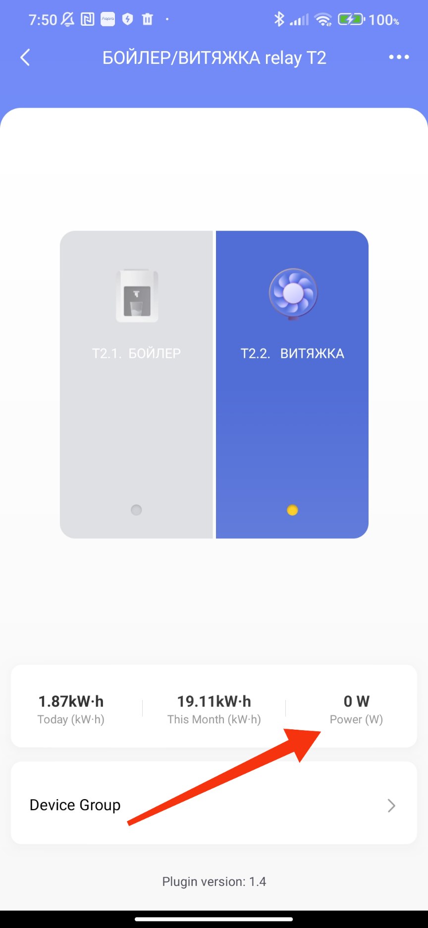

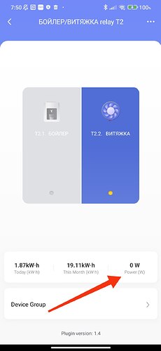

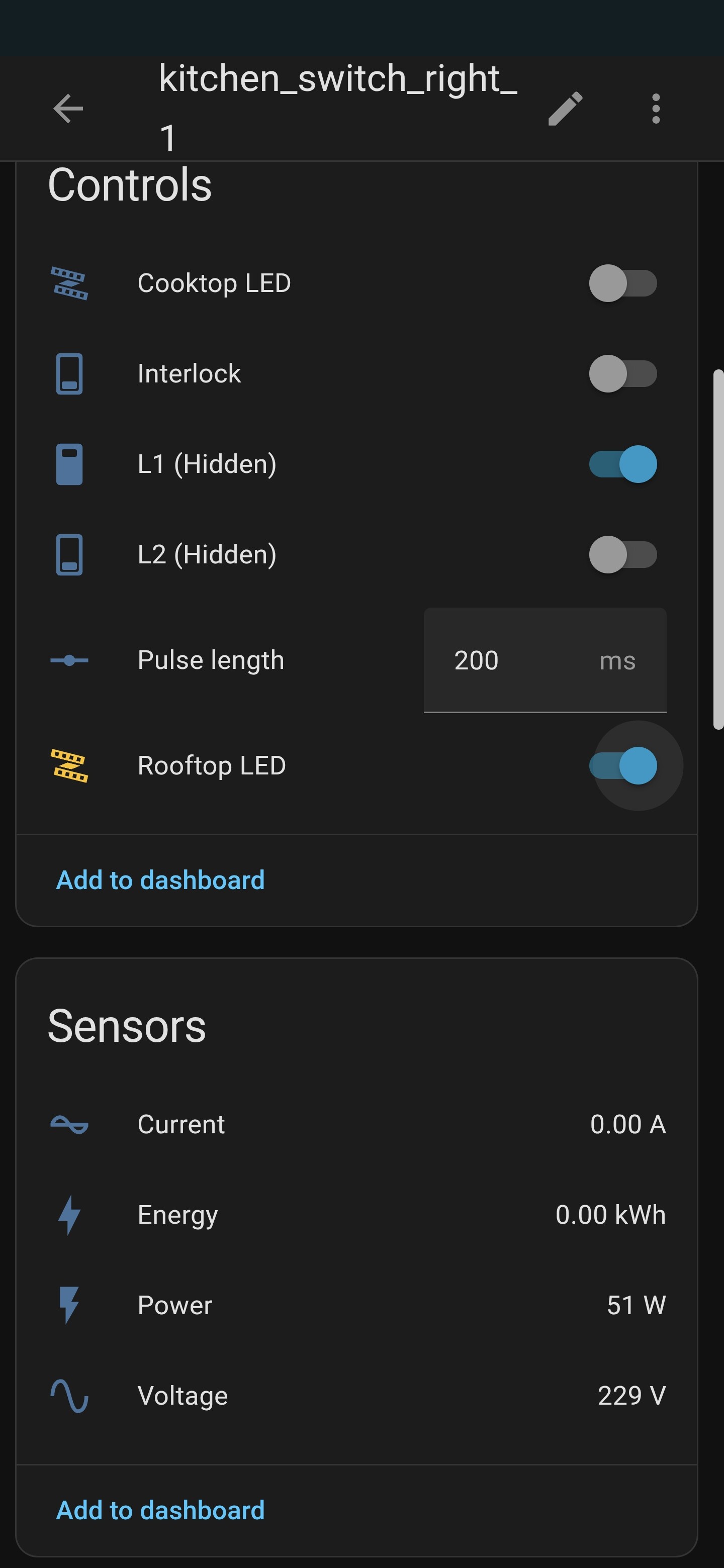

For reference load, all four combinations.
For reference, “Cooktop LED” is the stuck circuit. It is showing 0 power even though the light is on.
Conclusion, you are out of luck again, change the T2 relay under warranty.
