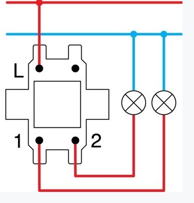

Hello, please describe your electrical connections. I converted the wire to neutral in the box where the lighting is controlled. Describe your assignment. relay.
My connection now is with a conventional switch. Connections: one wire is entring in conventional switch, and two wires exit from switch to the two lights on the ceiling.
Hi, I saw it, I’ll reply with the diagram later.

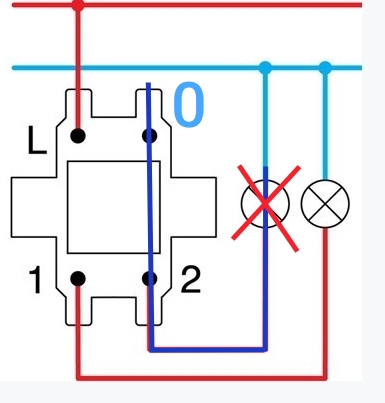

Hello, I connected near the lamp, sent zero to the box with the switch. After that, a full zero and phase appeared in my box for the Aqara smart switch. I replaced the T1M smart lamp on the ceiling, which does not require two wires with a phase (as is now in your diagram). My lamp on the ceiling had two lighting modes lamp + lamp.

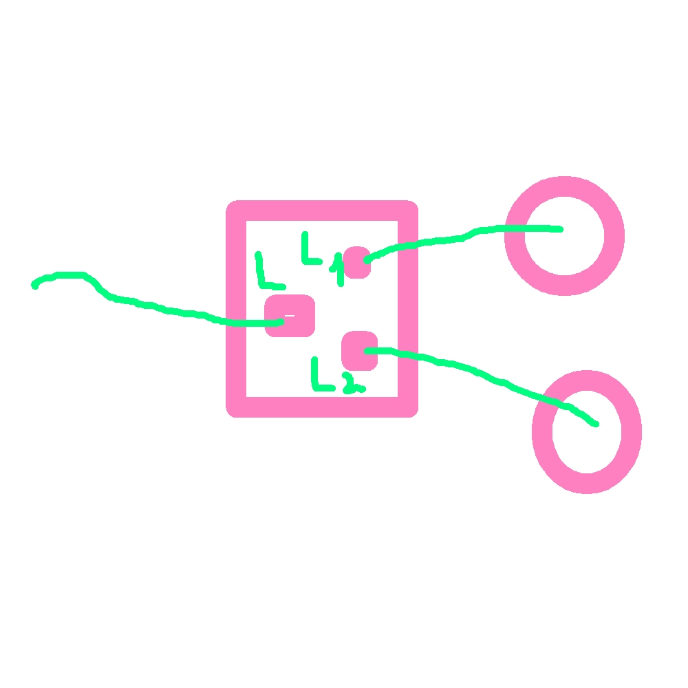

(I cannot put T2 near the lamp, because, well, I dont have lamp). Just to be more precise: my ordinary switch comands 2 lights: one in a room and one outside the house. The wall-box of the switch has, as I said, 2 wires: one it comes from the general panel and 2 wires goes to the 2 lights.
Then only the H2 EU switch will suit you, it has two channels and works without a neutral wire.
