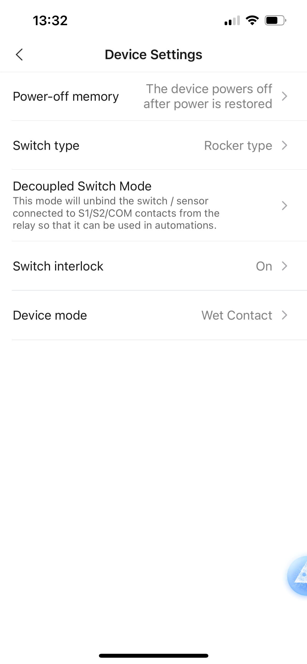

Hello, is the self-locking mode between T2 contacts enabled? I don’t have it, I checked it myself.
By the way, maybe you chose pulse pressing. Then you need an additional check after operation. If so, write back, I will check.
I’m talking about this setting.
Yes, switch interlock is enabled. The switch connected to S1 and S2 is working as expected. The button on the relay itself is switching on/off both L1 and L2 contacts when pressed.

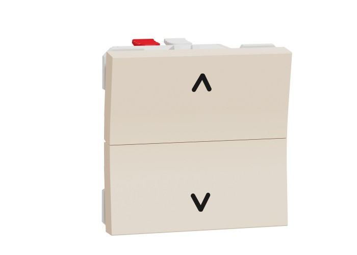

Are you using a “push” button or a “switch”?
Another possible scenario is when there is conflicting automation, reset the automation screen.
I’m using a shades switch:
It is push type. Contact is on while depressed. But the switch doesn’t matter. It works fine. If I press down direction and then while the shades are closing I press the up button the switch interlock works fine and it stops L1 before enabling L2. The problem was happening while I was installing the relay and while trying to mount it behind the wall switch I pressed the button on the relay itself. There are no conflicting automations. I have only automations to switch the power off after a delay.

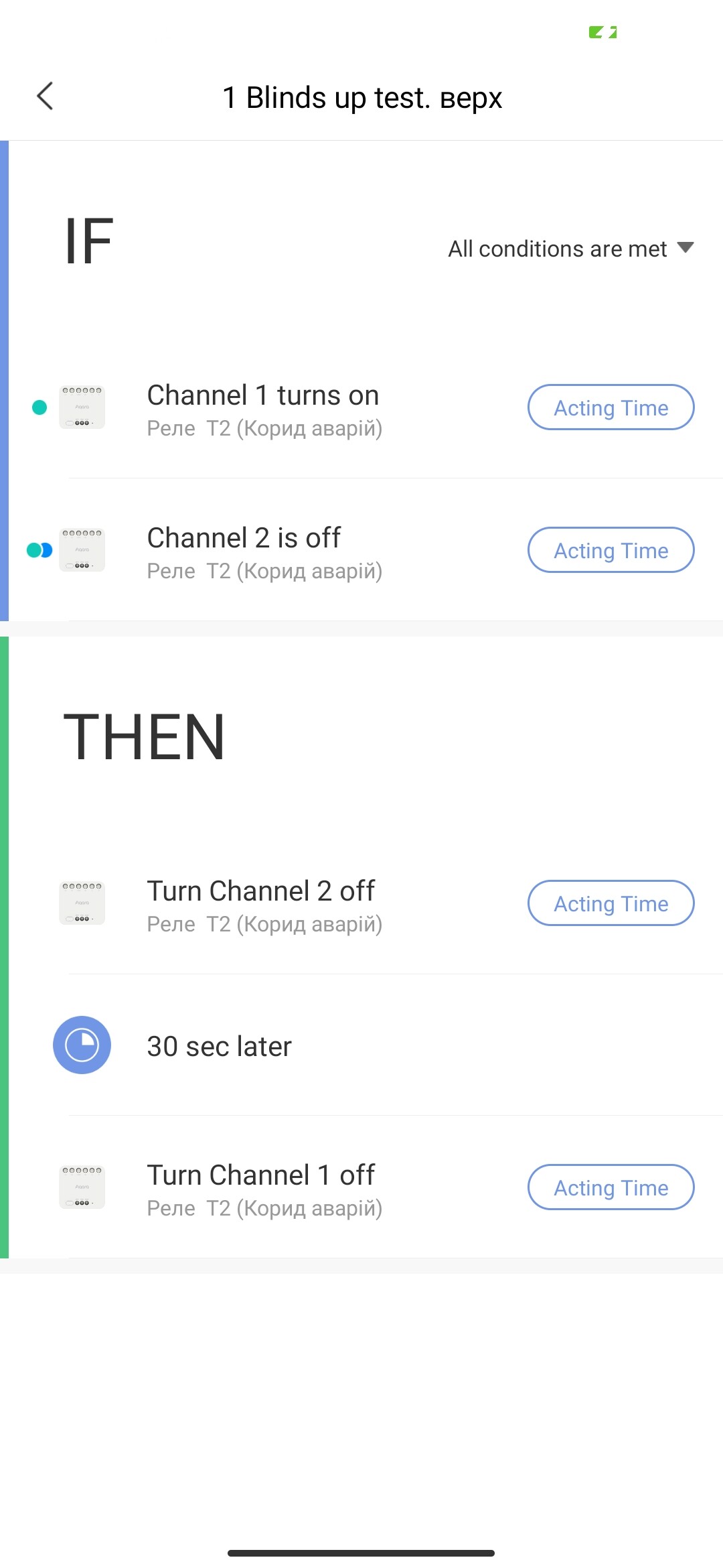

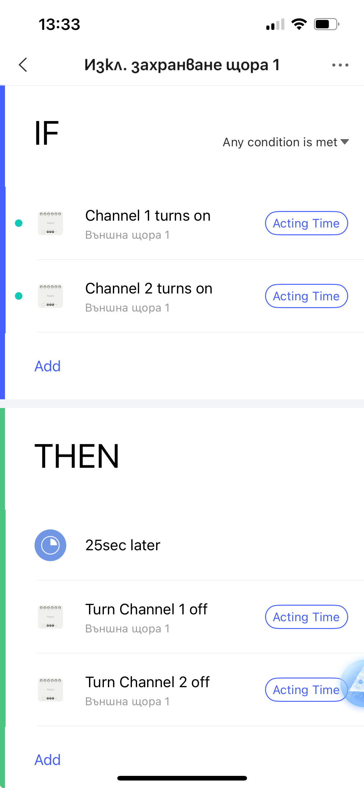

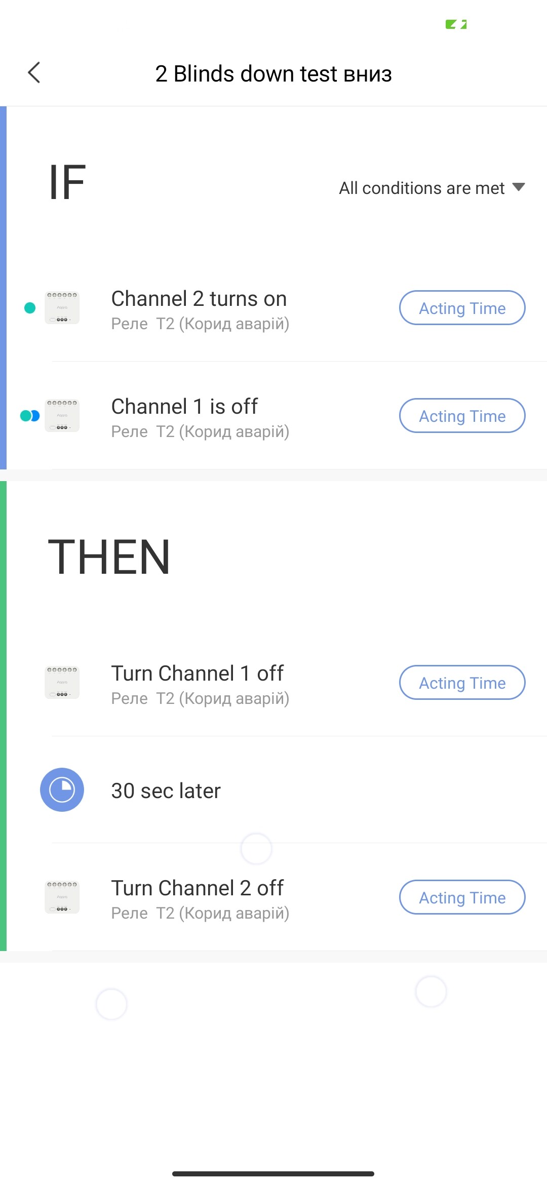

Once again, please give me a screenshot of the automation. For information, the T2 relay in push-button mode has its own characteristics, especially in interlock mode.
This is the configuration.
This is the only automation I have so far.

I checked and made sure that the button on the relay is not intended for controlling the relay, it is only for switching the state (control).
The main function is performed by automation.

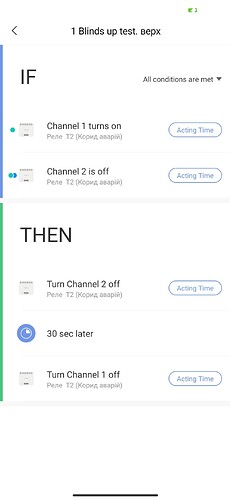

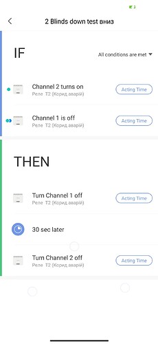

I suggest you make three automations that will secure the operation of your motor.
1- blinds up. In this automation, a control state for the interlock is made. In the THEN command, we duplicate the shutdown of the unused contact.
2- the same as in the first, only for the second contact.
3- Emergency shutdown of contacts (if two are turned on simultaneously by accident).
I also want to emphasize that the Aqara company is not responsible for an incorrectly connected device to an external load. I emphasize once again that the button on the relay is a technological button, and if the above automation (3) had been registered, the motors would not have burned out.
The interlock command in the setup is only an additional function to the main automation.
