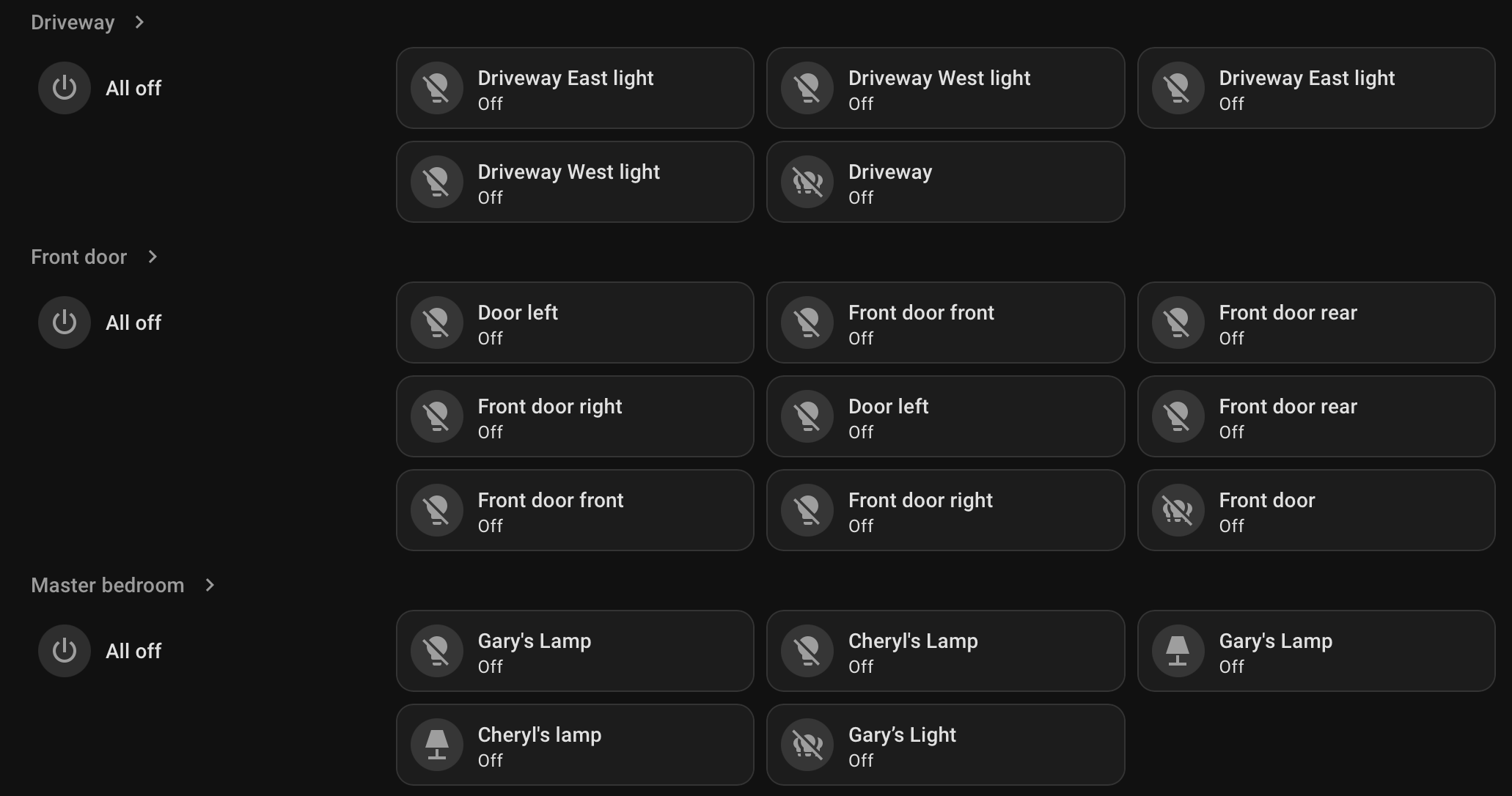

All of the lights in my home show up once in Apple Home but they all show up twice in HA. I’m using Hue lights and bridge. How can I remove the duplicates in HA? Or, is there a reason they show up twice in HA that I’m not understanding?

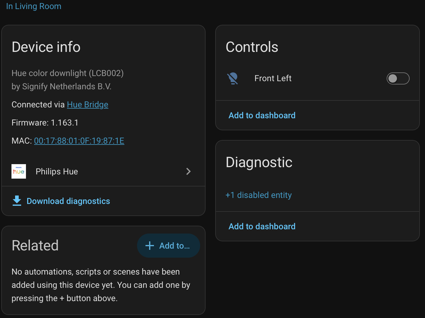

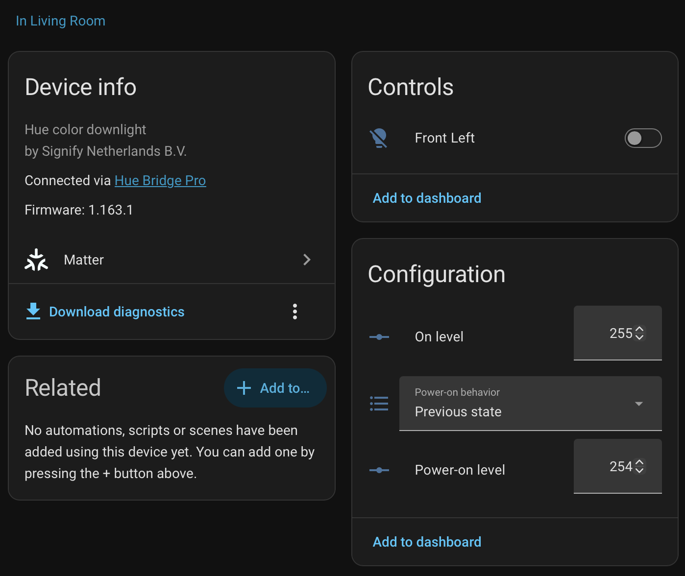

Try clicking on a light and then on the gear icon at the top. What do you see under “Entity ID”?
I clicked on two of the duplicates.
One has an id of: light.front_left
The other has id: light.living_room_front_left

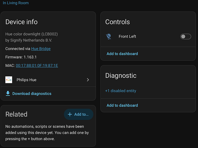

Then try looking up these IDs under Settings → Devices & Services → Entities → search for the ID → click on the entity → three-dot menu in the top-right corner → Device info
It looks like you’ve set up the Hue Bridge using both Matter and the Hue integration.
