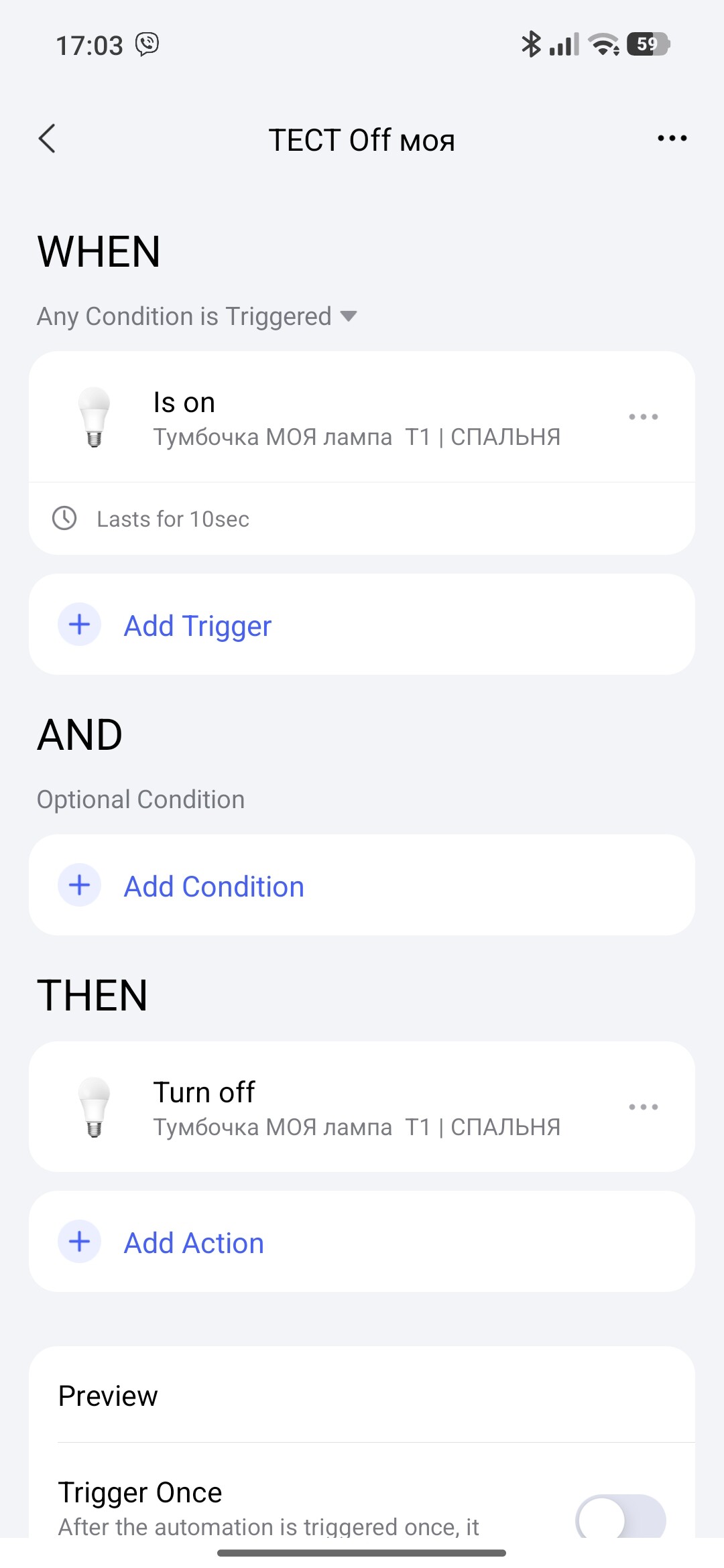

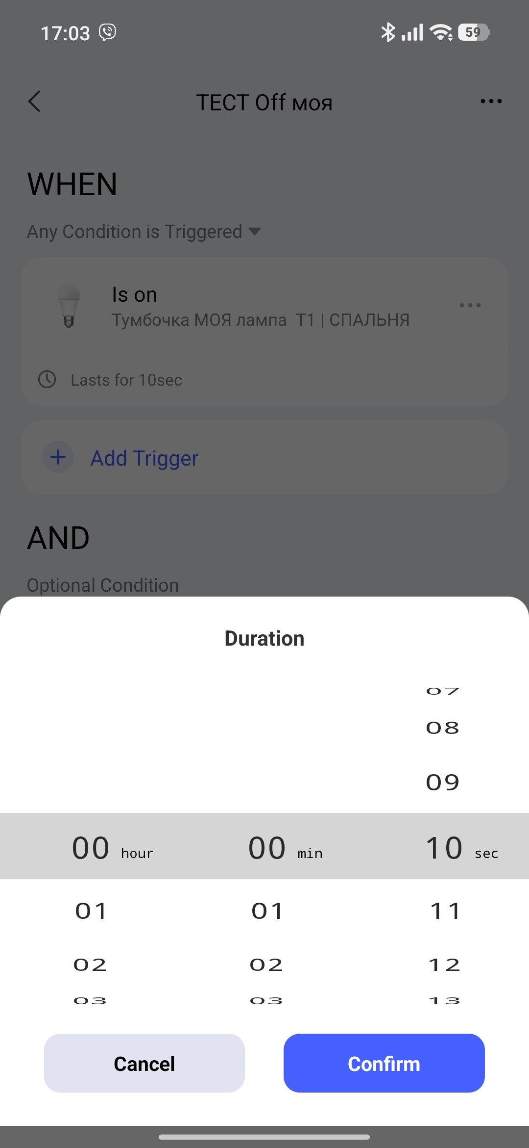

Hello, welcome to the forum. The difference between these conditions is important for automation 1.0. In automation 2.0, all conditions in the WHEN section are target (instantaneous), the condition (sensor state) is used in the IF section. Here I described the entire process of triggering triggers for automation, you can read it. Automation 2.0, lesson 1 (continued), description of the algorithm for transitioning automation 1.0 to 2.0
To control the lamp operating time, you need to use the parameter I provided in the example (in my example, 10 seconds).
