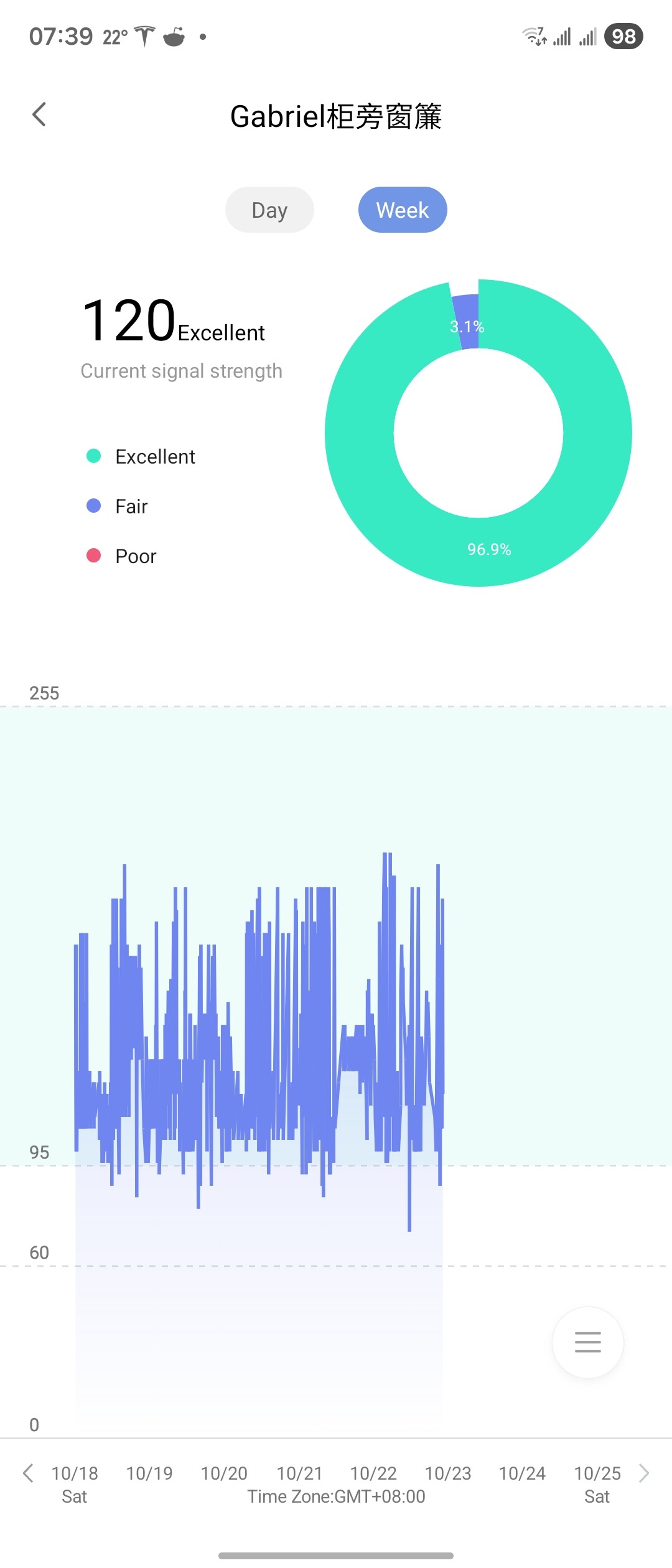

Moving the M3 Hub closer to the E1 curtain bots does not solve the problem. One of my E1 curtain bots started going offline again after 21 days… The attached image shows that the logged signal strength was good to excellent before dropping offline…
