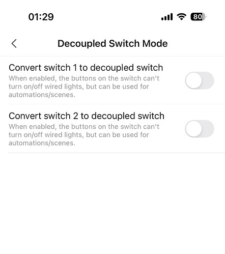

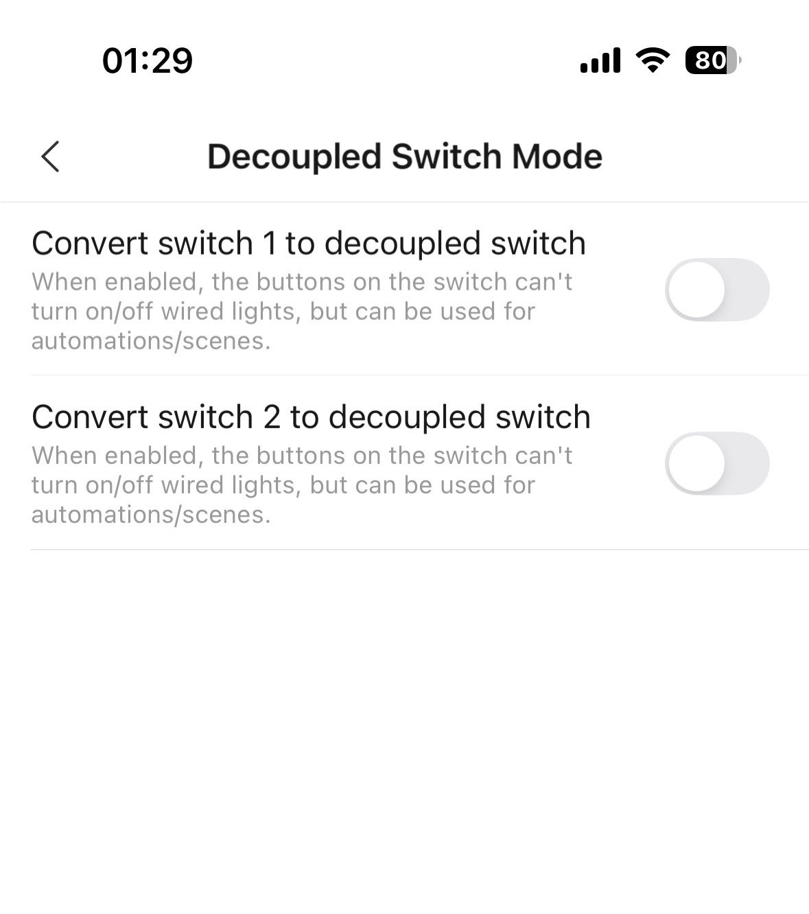

Hi @ihsack87 , you can unbind the keys from the relay and make them wireless (logical) and then set up automation

That’s what I want to do, but I understand that since I can’t connect it to the light bulb, I need to buy one with a neutral wire to power it and be able to decouple the relay. Thank you very much.
