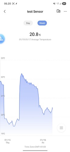

I am having problems with my aqara thermostat e1. It is like they are sleeping and do not open the radiator valve when the temperature falls below the setpoint. However if I just increase the setpoint by 0.5C and thus “wakes” thermostat it reacts and opens the valve correctly. The problem is there both when I use an external temperature sensor and when I’m not.
Picture1 shows the problem. I placed a linked sensor close to a window where it is colder than the 22C setpoint. The temperature drops to below 20C but the thermostat does nothing… It is dormant for 10hours until I actively “wake” it from the app by changing the setpoint. This time I activate by actually decreasing the setpoint by 0.5C – it just needs to be woken up… However, it goes back to its dormant mode after reaching the setpoint. I have been in contact with aqara support and they say the thermostat may be faulty but don’t want to do anything since the thermostats are three years old…

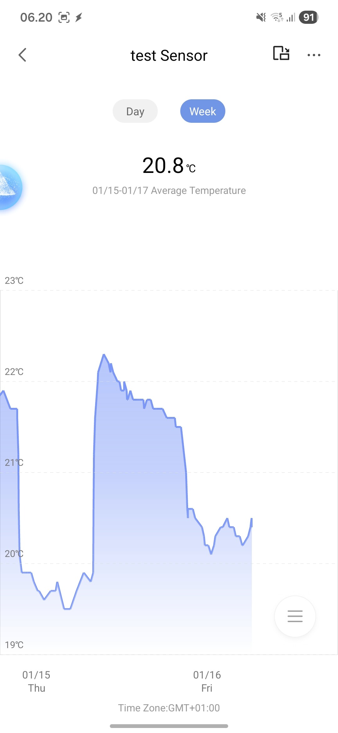

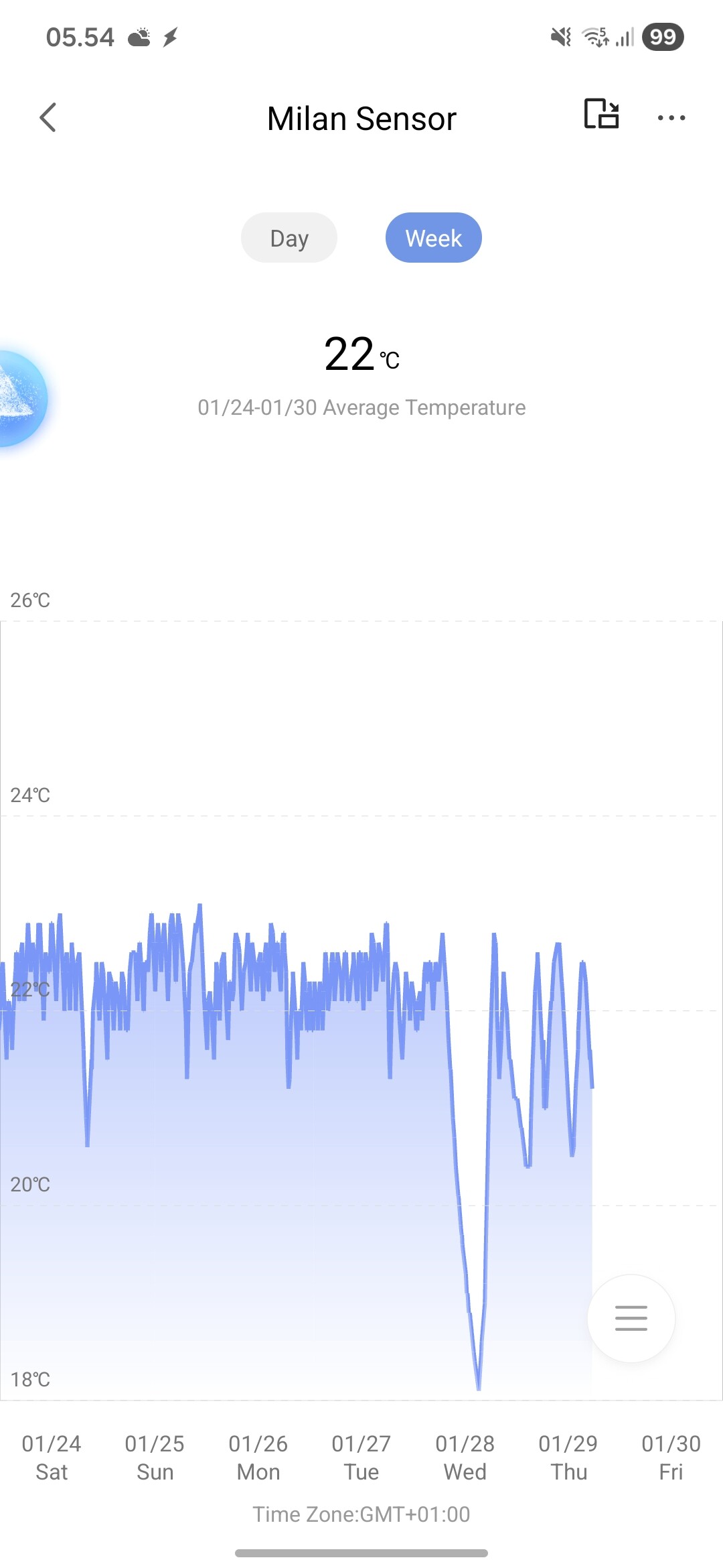

Now two days ago, my second thermostat also started behaving weirdly. It had given a low battery warning, so I changed the batteries, but after it is much worse at regulating the temperature – see picture2. After the battery change and valve recalibration it basically behaved like the other thermostat and did not heat until at woke it up by changing the setpoint (big temperature dip in picture).

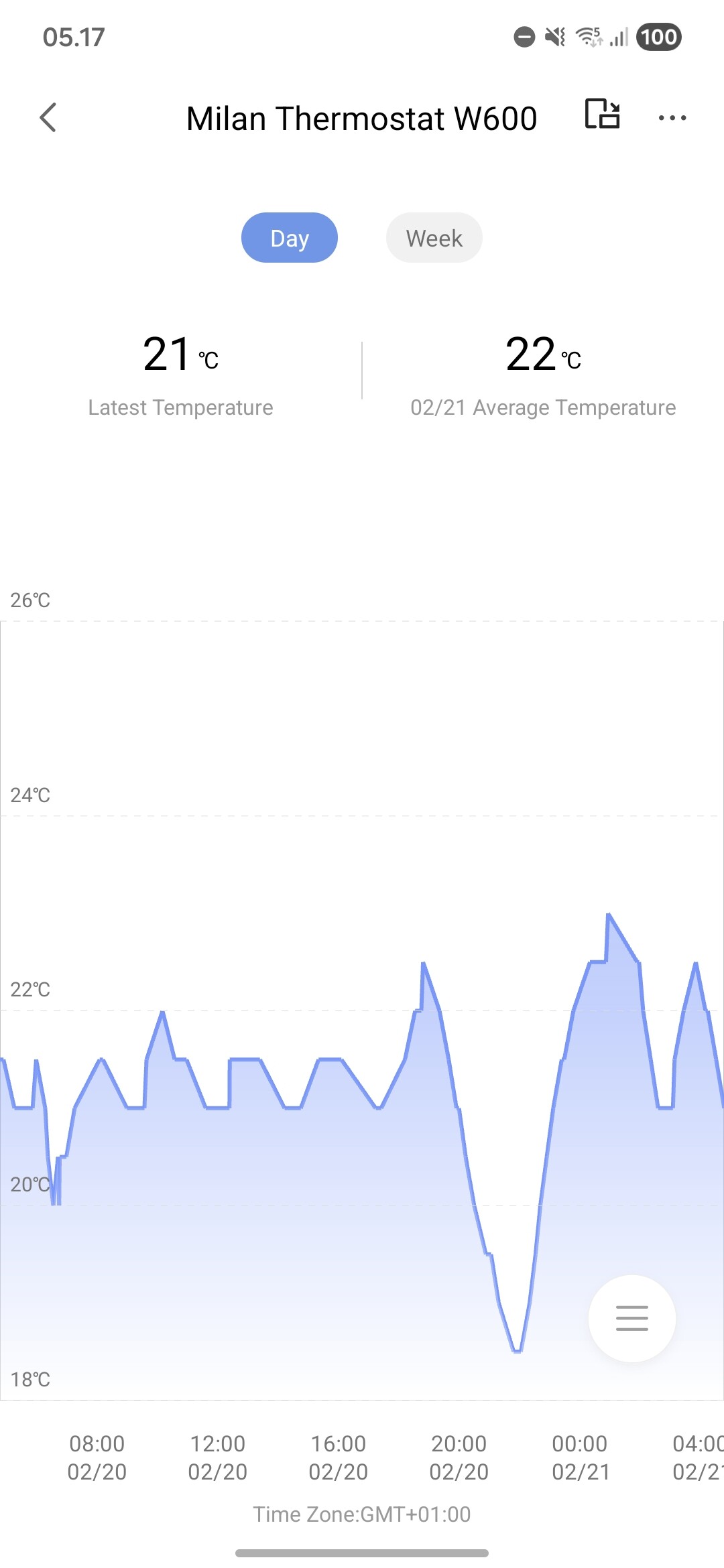

Aqara reached out to me and offered to send a free w600 replacement for my faulty E1 thermostat. Unfortunately, as many others it seems, I find the w600 quite unstable and not really fit for market yet. I installed it as Zigbee (running firmware 2644). I have tried it both with an external temperature and humidity sensor (old version not the w100) and without. In both cases I need to set the setpoint temperature to 20C to get an actual room temperature of 23C??? However what is more worrisome, I also with the W600 experience issues where the temperature drops way below the setpoint and the W600 does nothing - see the big temperature dip in the picture (here the w600 was running without external sensor). I increased the setpoint and then lowered again which “woke” the thermostat. Very unhappy that I cannot trust the w600 to keep the temperature - especially since the thermostat is in my kids room and finding his room cold in the night is very unsettling:(

Thank you for the reply and the suggestion - I have now implemented a fail-safe automation where if the sensor temperature falls below a given value the W600 setpoint temp is shortly raised to “wake” the thermostat and after a delay the setpoint is returned to its initial value. I will monitor how it goes but assume it will work. However, still dumbstruck that this is necessary.
