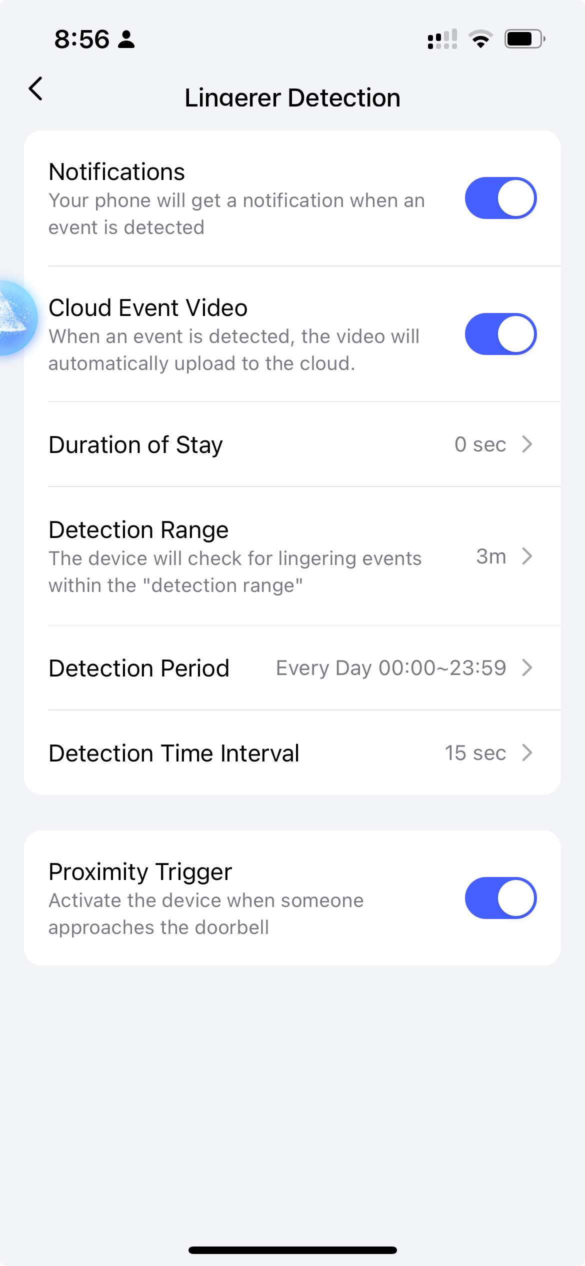

Does anyone else have the issue that the events that are recorded by your video doorbell that they are to late?
Like i get the face recognized message, but all the videos are about 1 or 2 seconds to late
So i almost never see actual faces.

Hi @kylian_overdijk welcome to the forum! Are you using G410? If you turn on the AI detection, you can tweak the settings under “Lingerer Detection”. Make sure the proximity trigger is enabled, increase the detection range, and lower the duration of stay.
