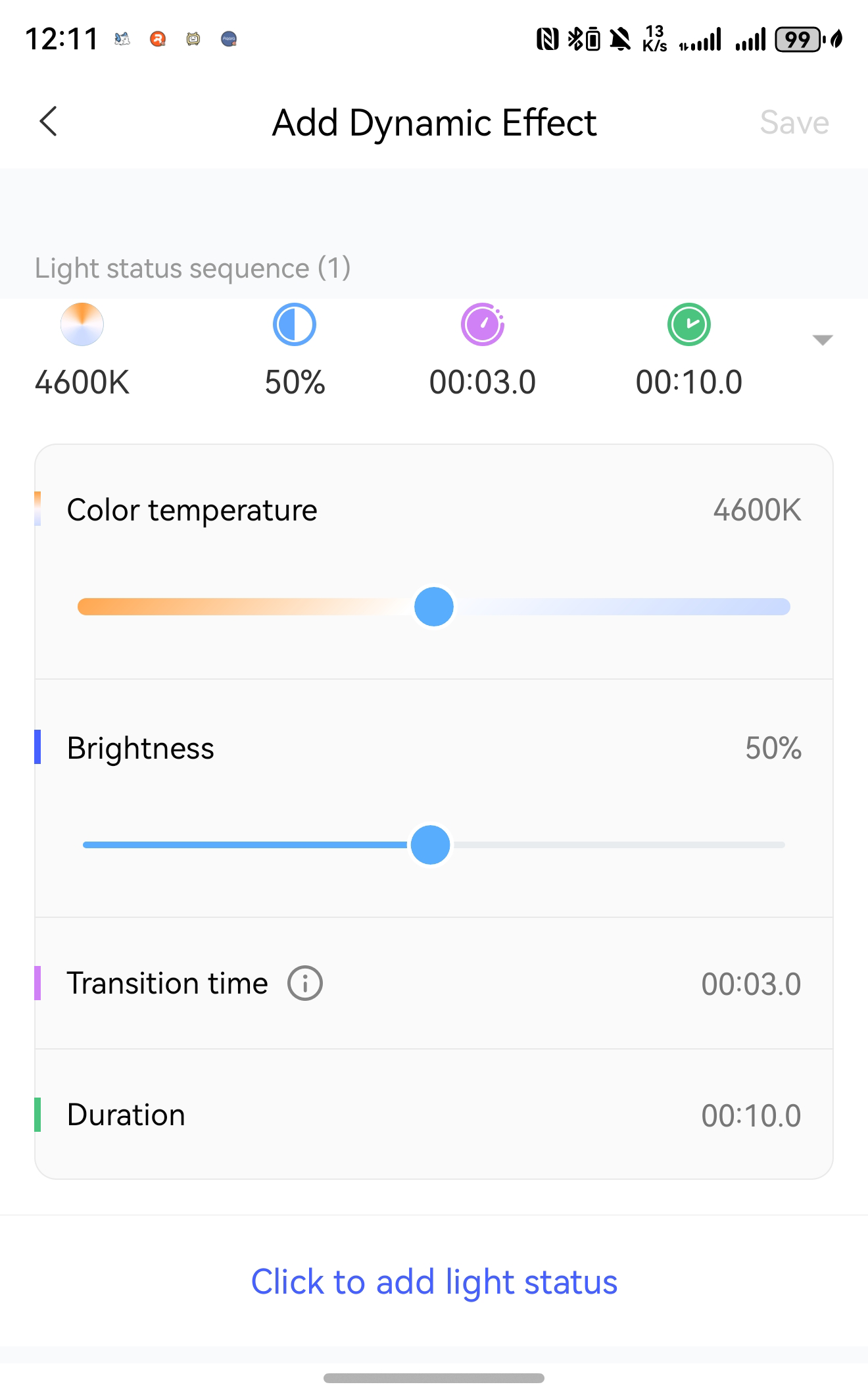

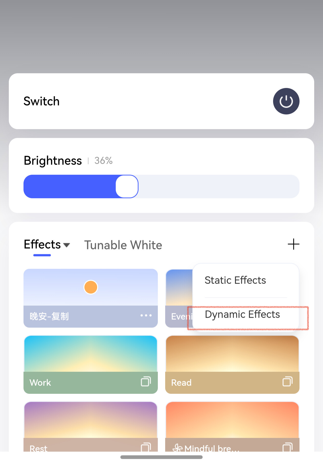

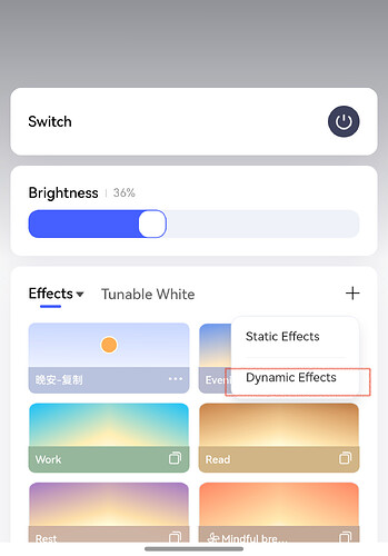

pls follow the steps as below:
  1. Open Aqara Home APP (This is a private function of Aqara and cannot be used in other apps.)
  2. Enter H2 dimmer device page
  3. Enter “Dynamic Effects”
  4. Set Light status sequence as you need
