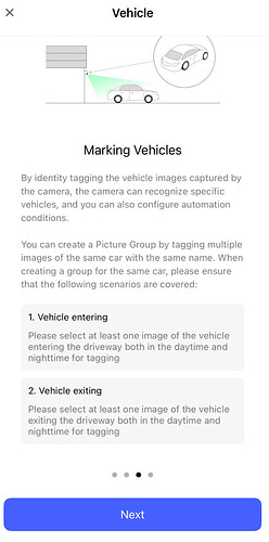

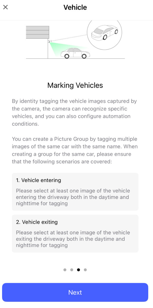

I can’t test it myself right now, but the instructions suggest that, if set up correctly, the recognition should be able to distinguish between all of these.

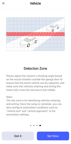

With the help of the camera image, you must also draw or remove recognition zones (blue squares) so that it works correctly. And you can’t park in the red zone.

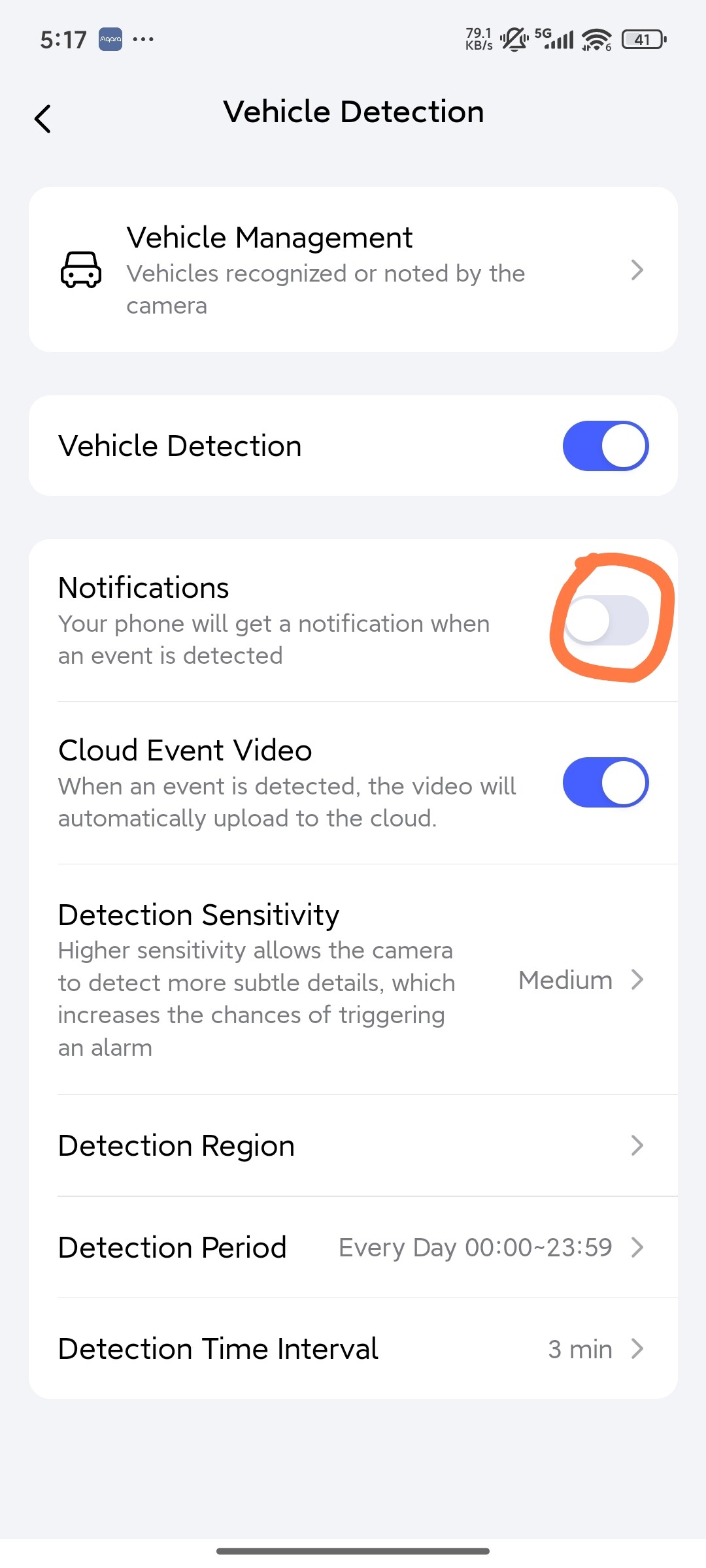

I offer a solution, please confirm if it meets your usage requirements:
  1. Please turn off the notification push for vehicle detection first.
  2. Create automation to push app messages when a specified vehicle is detected.

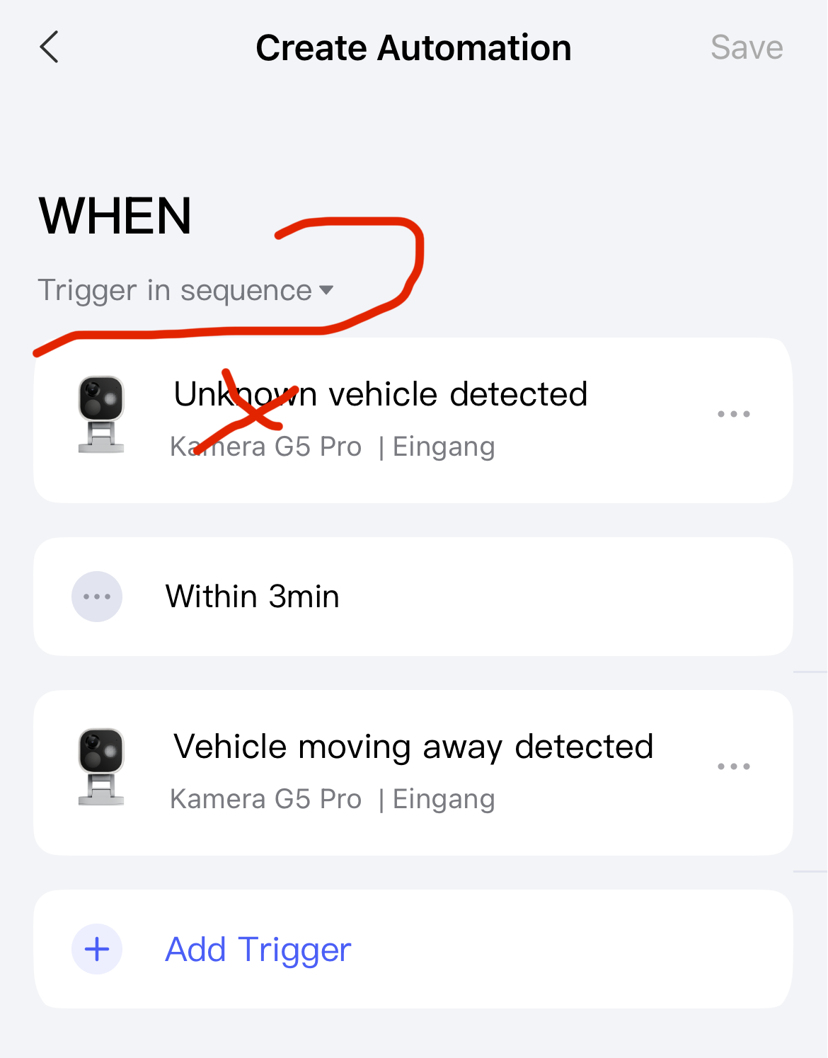

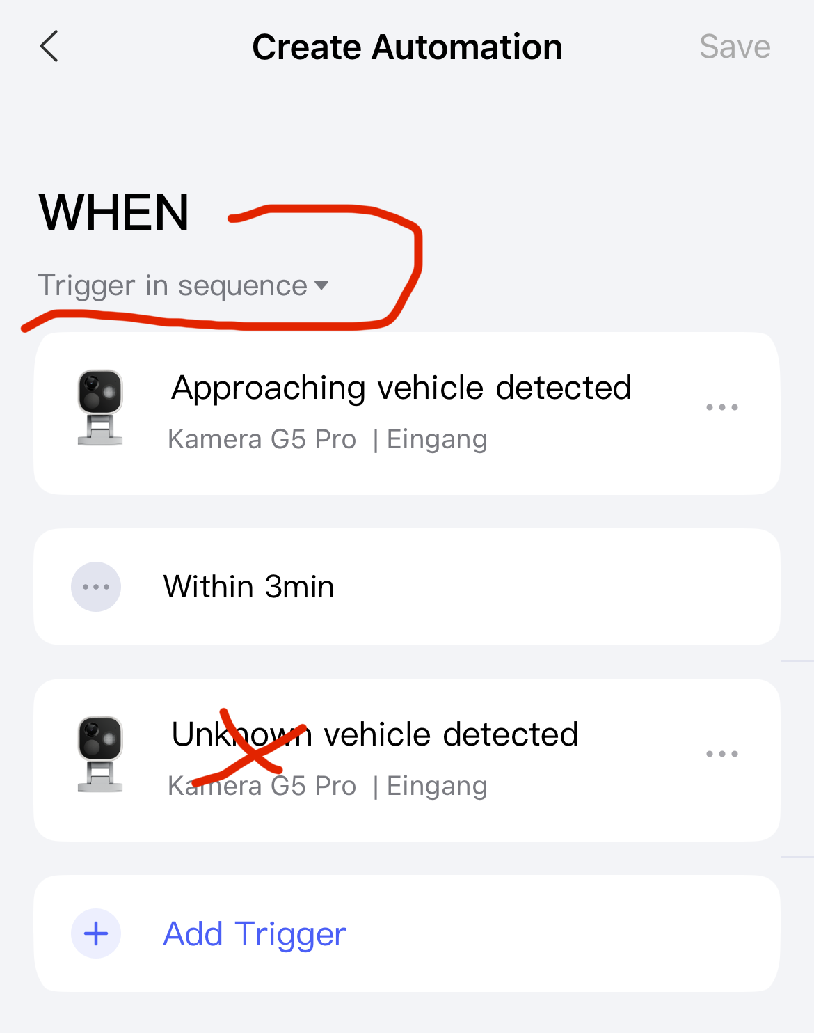

Does it work with a “Trigger in sequence”?
I just can’t select a vehicle right now, so instead of “Unknown vehicle” you have to use “Specified vehicle”.

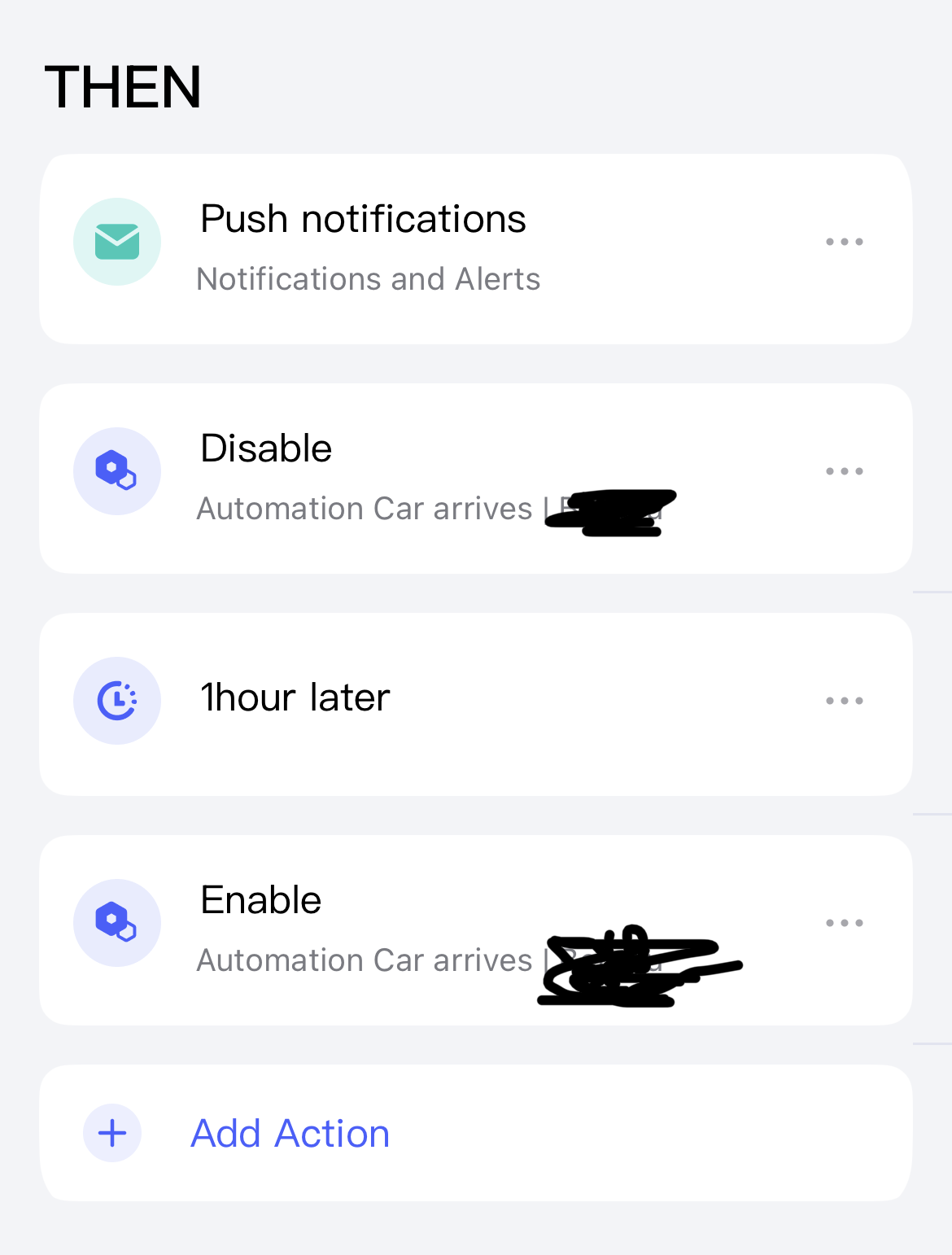

If multiple messages continue to be triggered, you can also deactivate the automation itself and reactivate it later. However, to do this, you must first save and then edit the automation.
Thanks for the suggestion!
I actually already tried it the other way around (reversing the steps in the sequence), but that didn’t work on my side.
However, I’ll give your exact order a try to see if it behaves differently.
I’ll report back once I’ve tested it.
