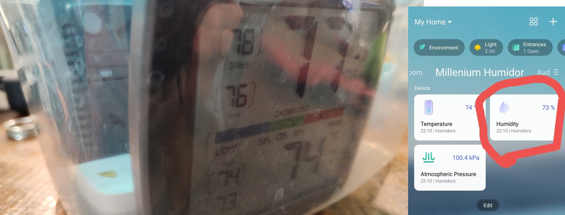

My Aqara Humidity Sensor has drifted to 4% away from a calibrated sensor (see attached). There should be a way in the software to re-calibrate the humidity.

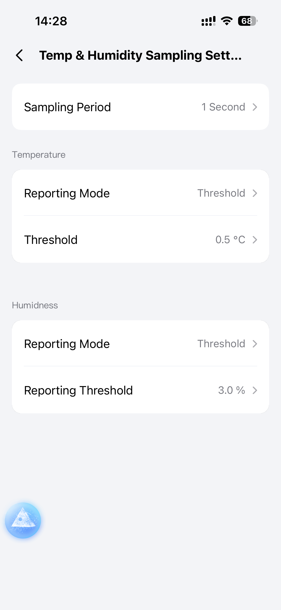

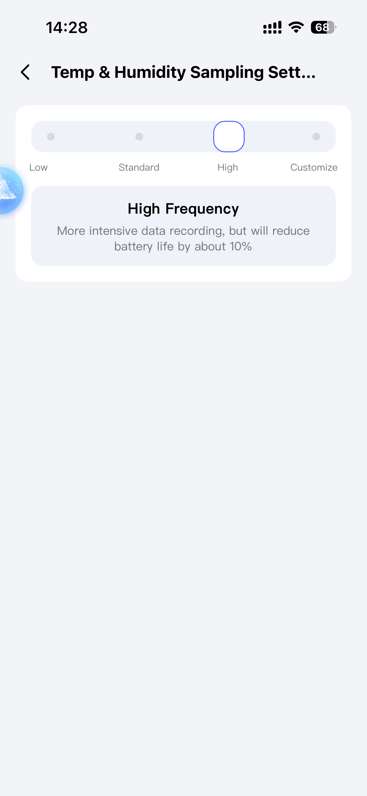

If you use W100 in the settings, you can change the frequency of changing the readings and configure the sensor properly.

That’s disappointing and honestly unacceptable. Even a cheap analog hygrometer is +/- 1% with the ability for recalibration. Aqara should be ashamed to sell such a worthless piece of hardware.

I have two dozen such sensors, they show humidity relatively normally, I compared them with the W100.
