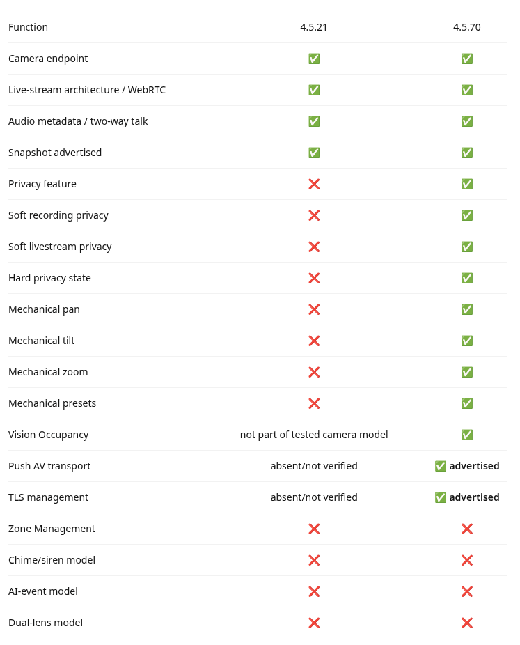

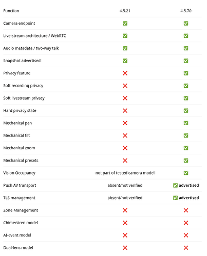

Firmware 4.5.21 does not appear to be a major Matter feature update. It does not add the missing G350-defining features such as PTZ, zoom, presets, privacy mode, zones, siren, local recording, AI events, or dual-lens/4K exposure.
What changed most in our tests is that the newer logs and patched driver make the existing Matter camera model much clearer. The firmware now clearly shows — or at least we can now clearly verify — snapshot capability, audio capability metadata, allocated audio/video streams, accepted command lists, and stream metadata.
Category Changed with 4.5.21? Notes
Firmware version Yes 4.5.204.5.21
Endpoint/cluster topology No Same basic Matter camera structure
PTZ / zoom / presets No Still missing
Privacy mode No Still missing
Zones / AI events / siren No Still missing
4K / dual-lens model No Still exposed as 1080p camera model
Snapshot capability visibility Better verified But maybe already advertised before
Snapshot command function Broken Advertised but SnapshotStreamAllocate returns INVALID_COMMAND
Stream quality in SmartThings Improved Due to driver patch, not necessarily firmware
Default viewport Still broken in firmware Driver workaround fixes UI state
Audio stream metadata Better handled Mostly driver-side improvement

Update: new firmware version available! Here’s the first report from my Matter inspection / device interview:
Looks much better now.
Here is a complete report and review of the new firmware:
https://community.smartthings.com/t/aqara-g350-and-smartthings-matter-cameras-have-come-a-long-way/310676
As you can probably see: I’m impressed!
Thanks a lot for the detailed, updated report @andreas_roedl!
