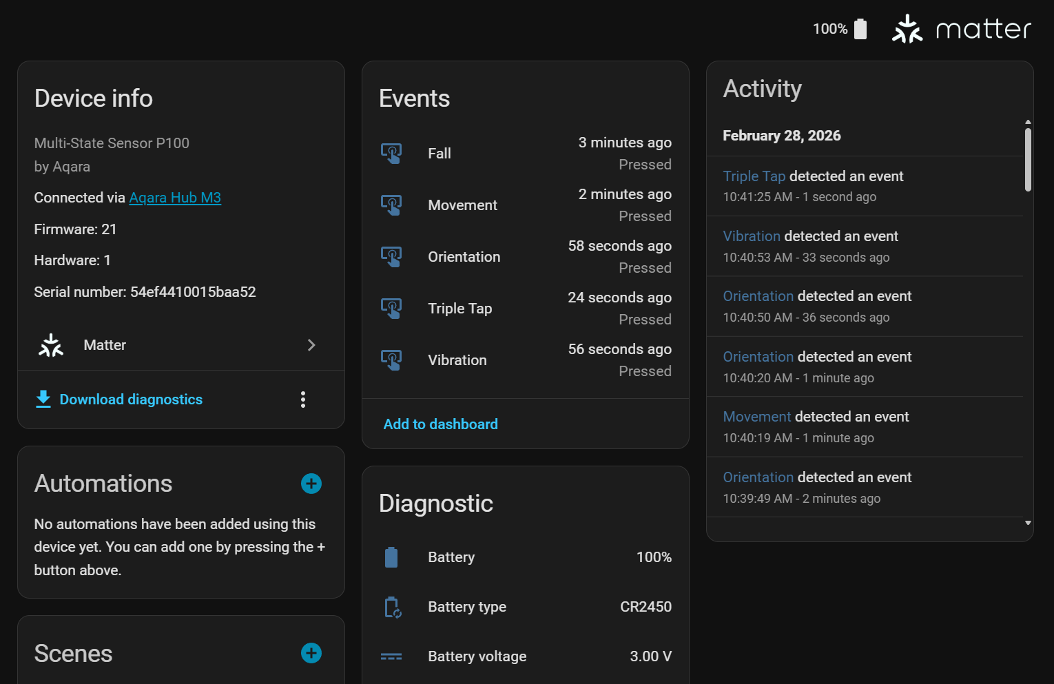

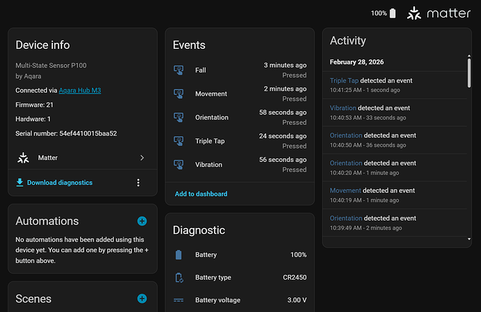

I have my P100 installed on my office chair, which helps to keep the lights on versus relying just on a PIR motion sensor. I have it paired via Zigbee to my Aqara M3 Hub, and then via Matter to Home Assistant. On the Home Assistant side, I had to rename the entities to properly reflect each of the P100’s detection capabilities.
Multi-State-Sensor-P100
Thank you for sharing. It can be said that I have seen the best guiding practice of HA at present. You are welcome to post specifically to share your detailed configuration, which can help more users with the same needs as you.
