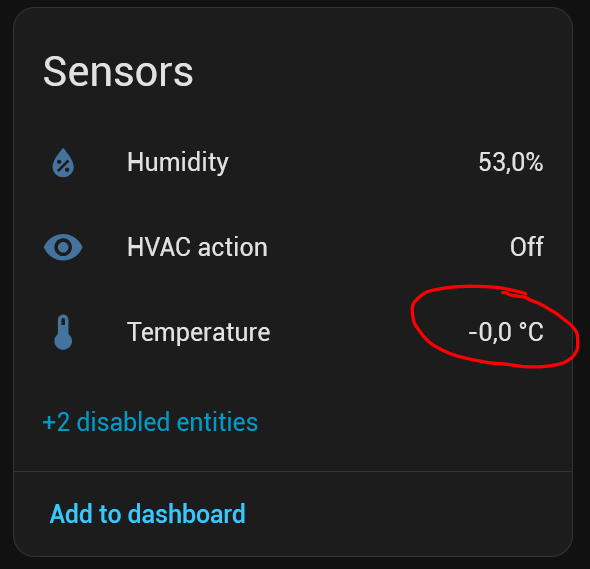

The floor sensor (NTC) doesn’t show any temperature value in Home Assistant, just the 0.0 °C. I have tried different models of the Thermostat and different floor sensors. Can anybody help to fix this in Home Assistant?

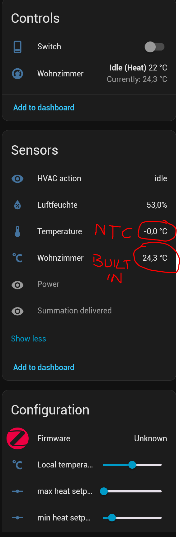

Do you have a chance to look at other temperatures in the W500? If you see a built-in temperature sensor, then perhaps my version is correct.
The built in temperature sensor works fine out of the box. As some other values like humidity. Not sure what you suggesting (please consider that I am a HA beginner).

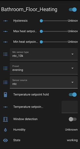

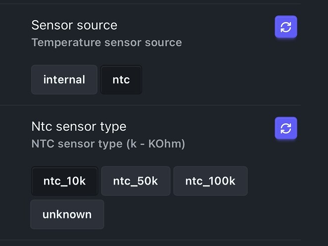

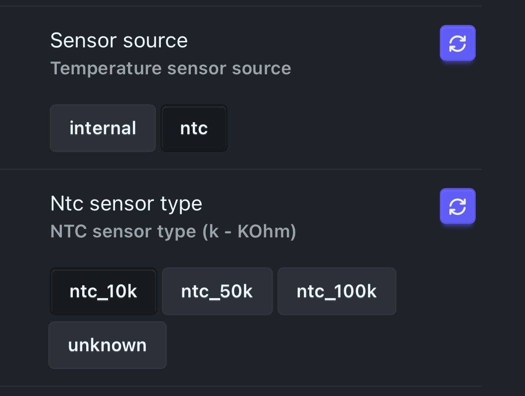

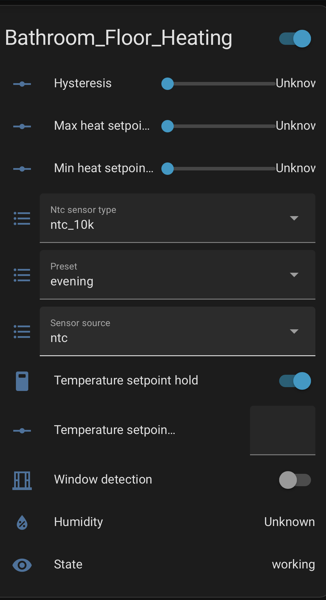

Not sure how you have setup your W500 via Zigbee with HA, but Zigbee2MQTT now supports the W500 and you can select the NTC temperature probe.
I’ve just updated mine this evening, and can now see floor temperature.
