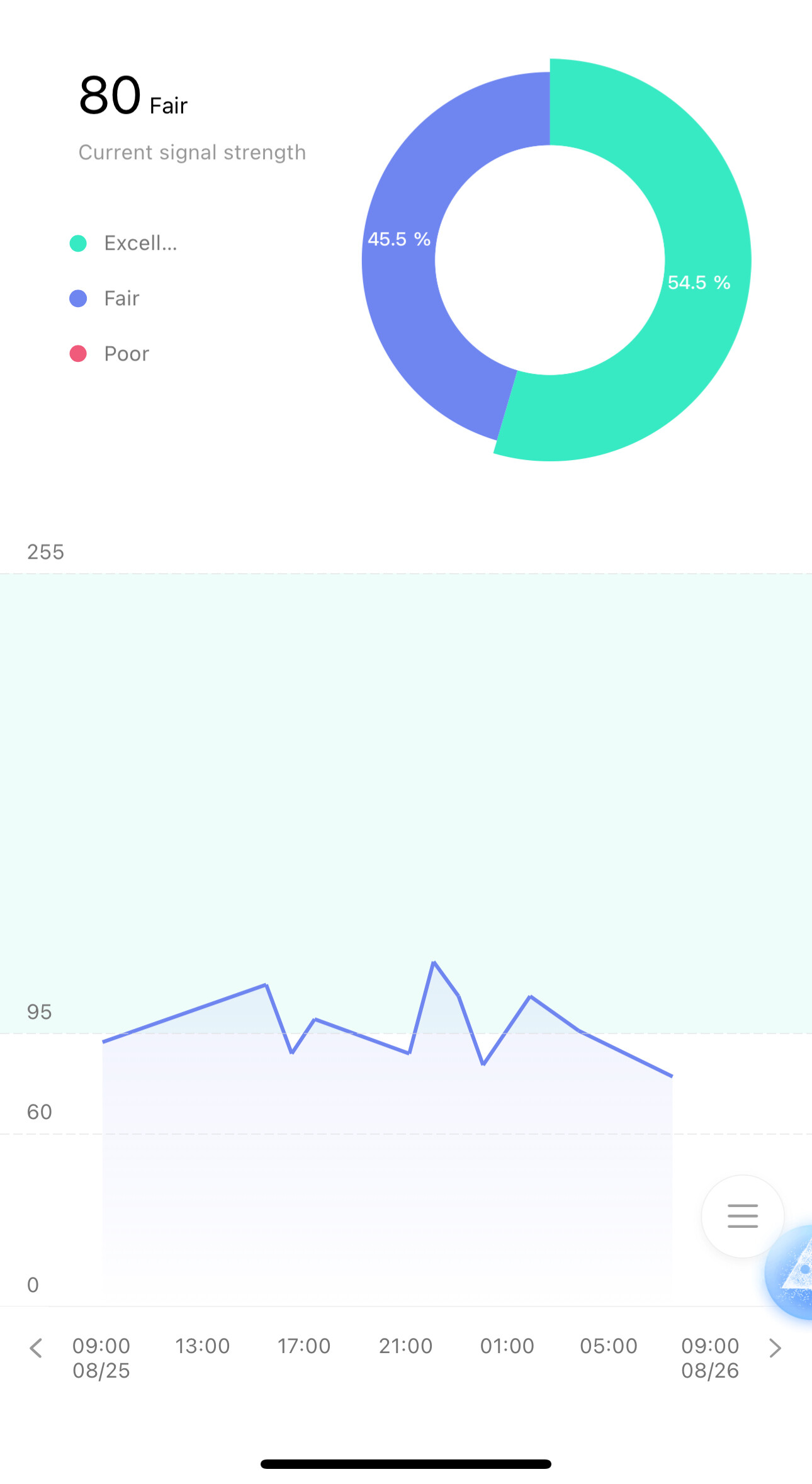

But I appear to have been to impatient. Checked again this morning and the sensor is at 100% green/excellent signal strength. So it did fix itself!

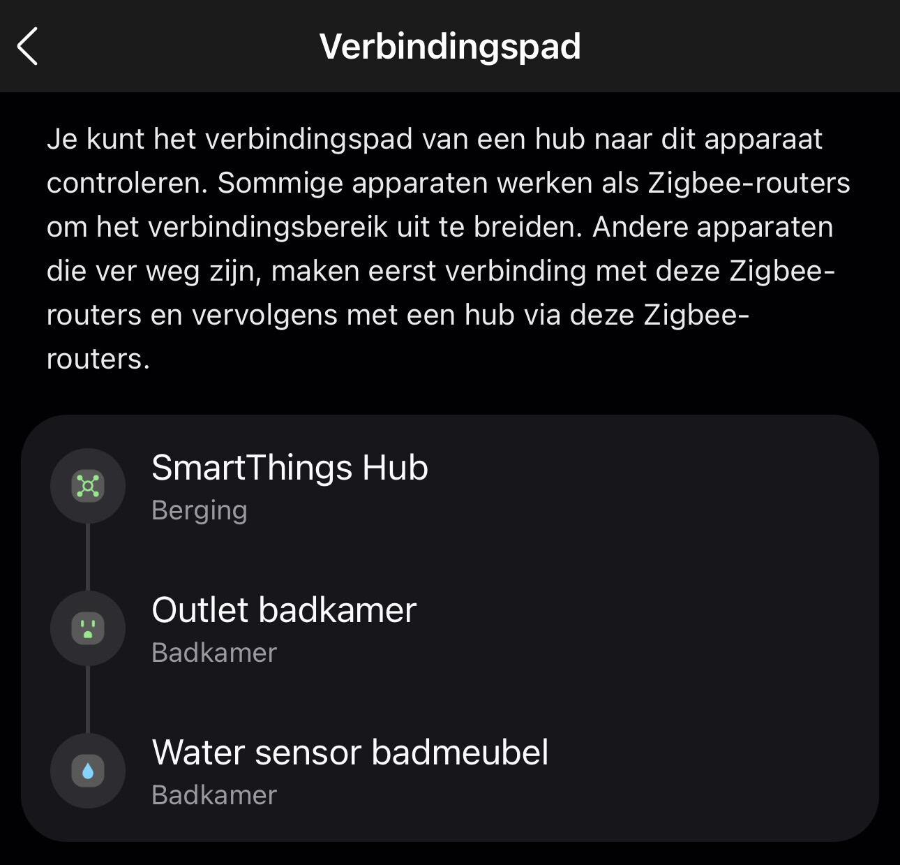

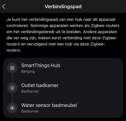

SmartThings path:

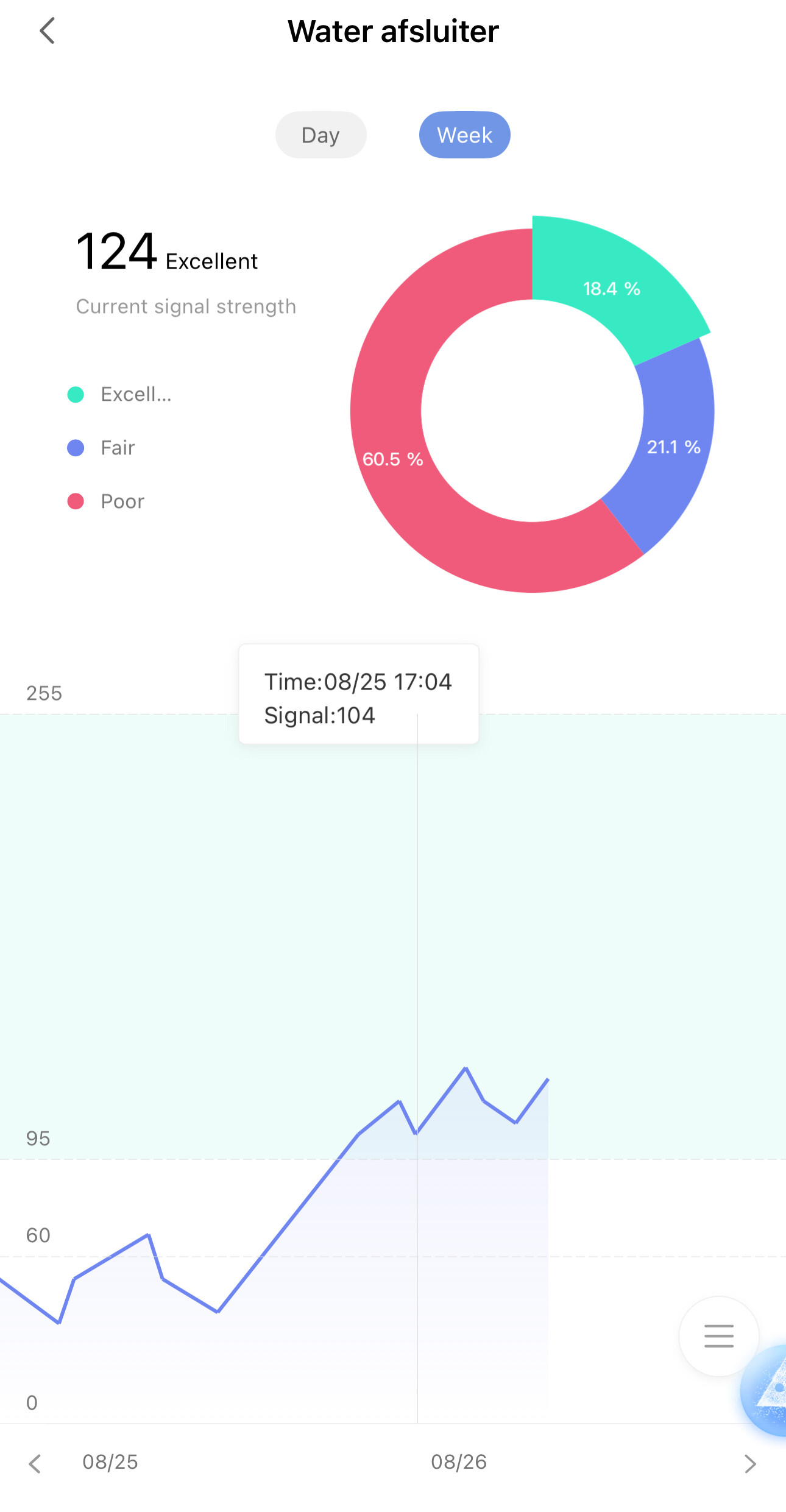

This watervalve is maybe 6m away from the hub but was always poorly connected. Now the outlet in the mix and around 17:00 (like the sensor upstairs) it went in the green.
I’m guessing because the signal can get to it easier from above (wooden plank, outlet is upstairs) then the hub that is to the side of it with concrete surrounding it.
