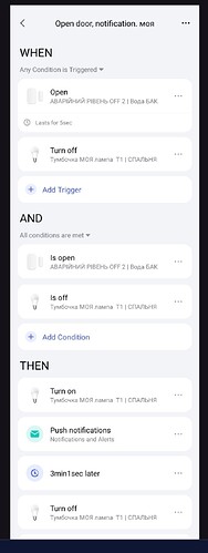

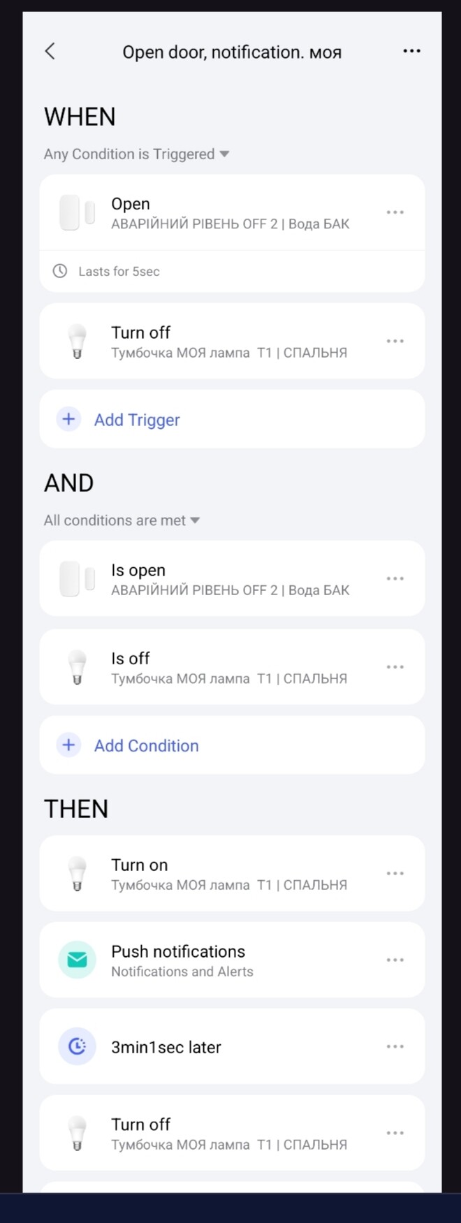

Hello, I disagree with you. Later I will write an automation where there will be a cyclical notification (you can set the time you need). It’s just that this automation will have one additional Aqara smart lamp.:smiling_face:

The lamp is an additional signal about the open door. You can use any unused contact of a relay or switch instead of the lamp.
You choose the interval and content of the message yourself.
By the way, @JohnD, you once wrote to me about cyclic Off/On automation lamp: “Interesting automation, but where can it be used?” Here’s a clear example, any automation has its application. :smiling_face:

The “stop” signal appears if the IF conditions are invalid (doors are closed). I have tested this automation. Also, in the WHEN section, I recommend setting a delay period (delay) of 5 seconds for the lamp. This condition ensures a 100% start cycle with the door open.
That makes the stop behavior testable. I would add one negative check: close the door during the five-second lamp delay and confirm that the first notification never starts. That separates “the cycle stops after it has begun” from “a pending start is cancelled before the cycle begins.”
