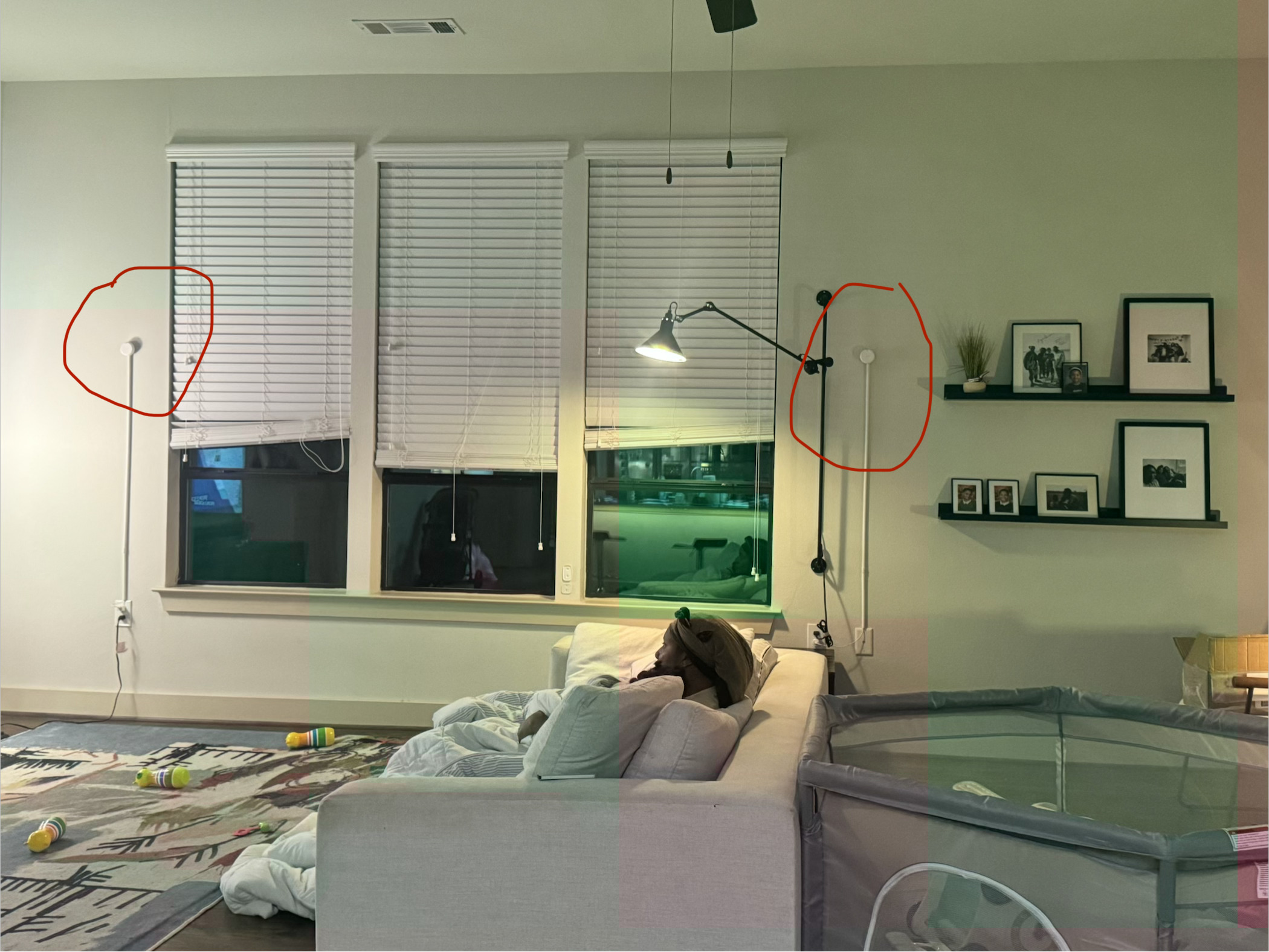

I got an FP2 a few weeks ago and trying to use it for light automation. It’s sitting on top of a fireplace mantle about 5ft high in our living room. There’s a table in front of it with a glass top but most of the glass is covered with junk. However it keeps seeing two people in the room when it’s just me. I put a sticker of the table but it doesn’t seem to help. Any suggestions?
Thanks,
Q
put an interference zone where the table is or maybe move the FP2 to another wall
