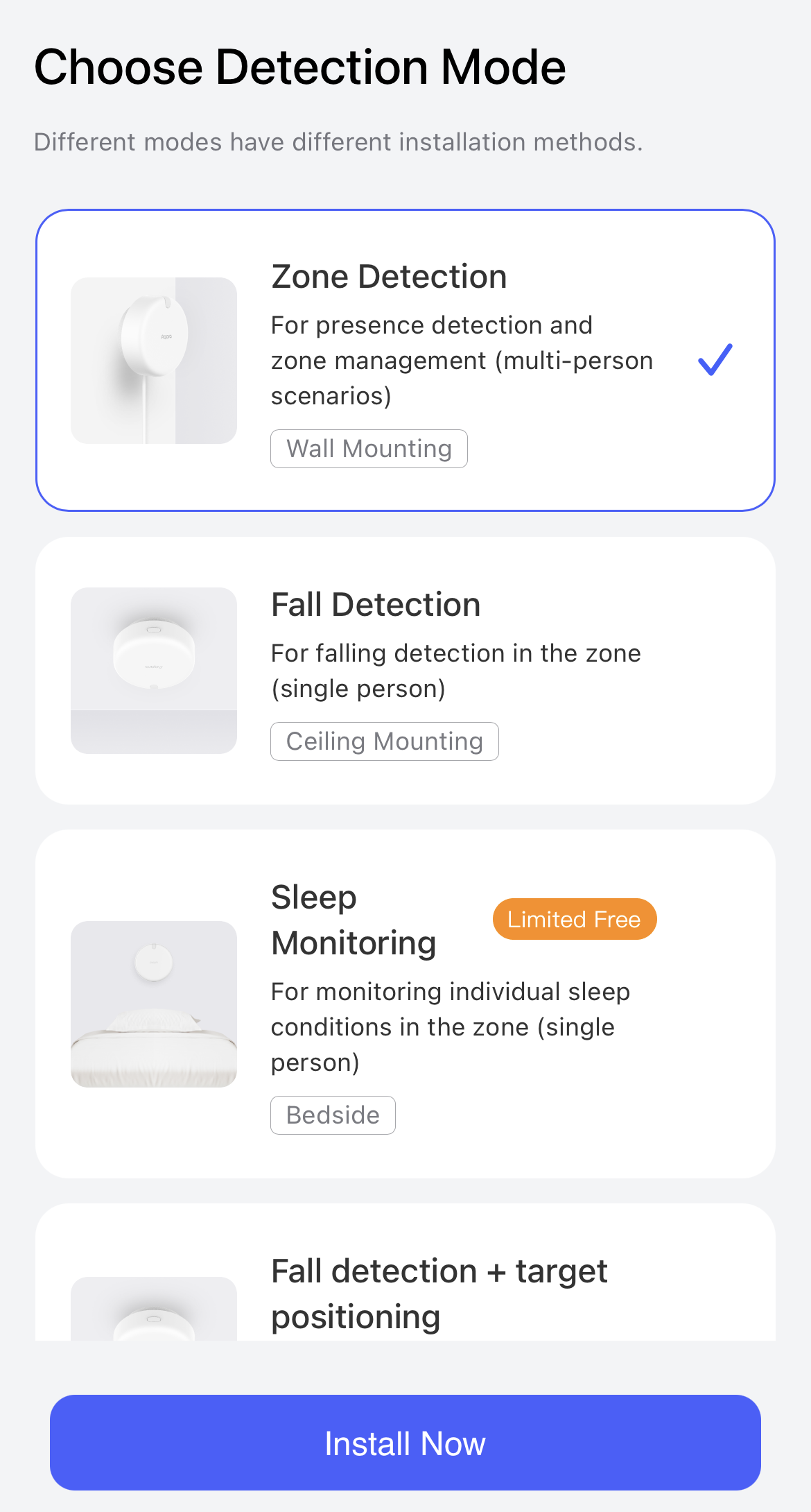

I’ve just remembered that you can set the FP2 to different detection modes.
However, it seems that sleep detection only works for one person, and you can no longer set up zones. I haven’t experimented with this mode, as I previously mentioned. But I found this interesting video here
@siobhanellis Have you set Zone Detection or Sleep Monitoring?
And there in lies (Pun intended) the problem. Single person.Means I’ll need 2 FP2’s for my bedroom.
