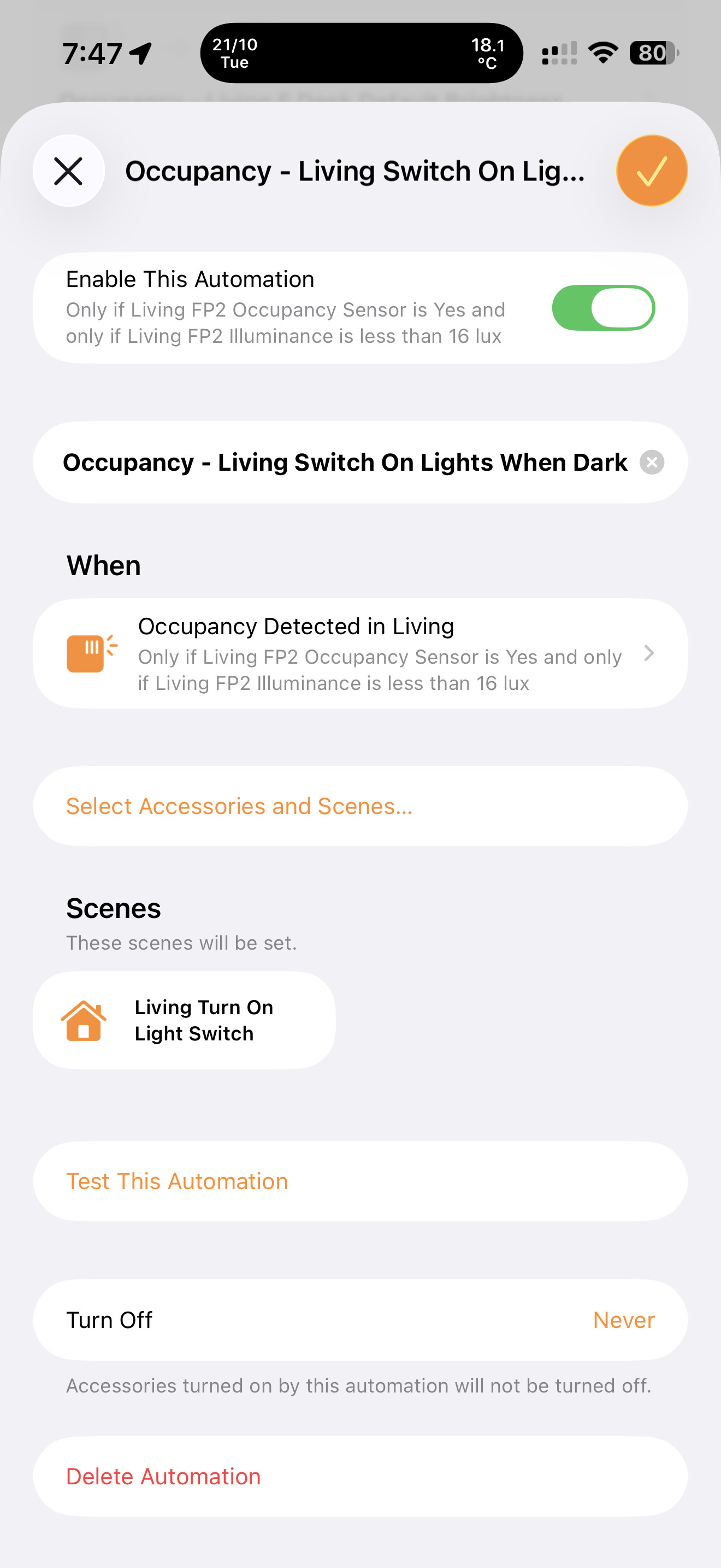

I have a two FP2 (latest firmware) and setup automation to only switch on the light when it’s occupied and lux is low. However, the automation still runs when it’s very bright in those two rooms.
Does anyone have the same issue? Is it a known issue? Any fixes?
Hello, show a screenshot of the automation related to your question.

It looks like you’ve set up the automation correctly — I use similar conditional setups myself. The key question now is whether your lux readings are accurate. Is the automation actually running when the sensor reports more than 16 lux?
What I’m getting at is whether the light sensor’s placement reflects the true lighting conditions of the room. Could it be partially blocked or facing the wrong direction? Pictures would help if you can share them.
Here’s a quick way to test: when you feel it’s not dark enough (the situation you’re troubleshooting), check the lux reading before walking into the room — so you don’t trigger presence. See if the reading matches what you’d expect.

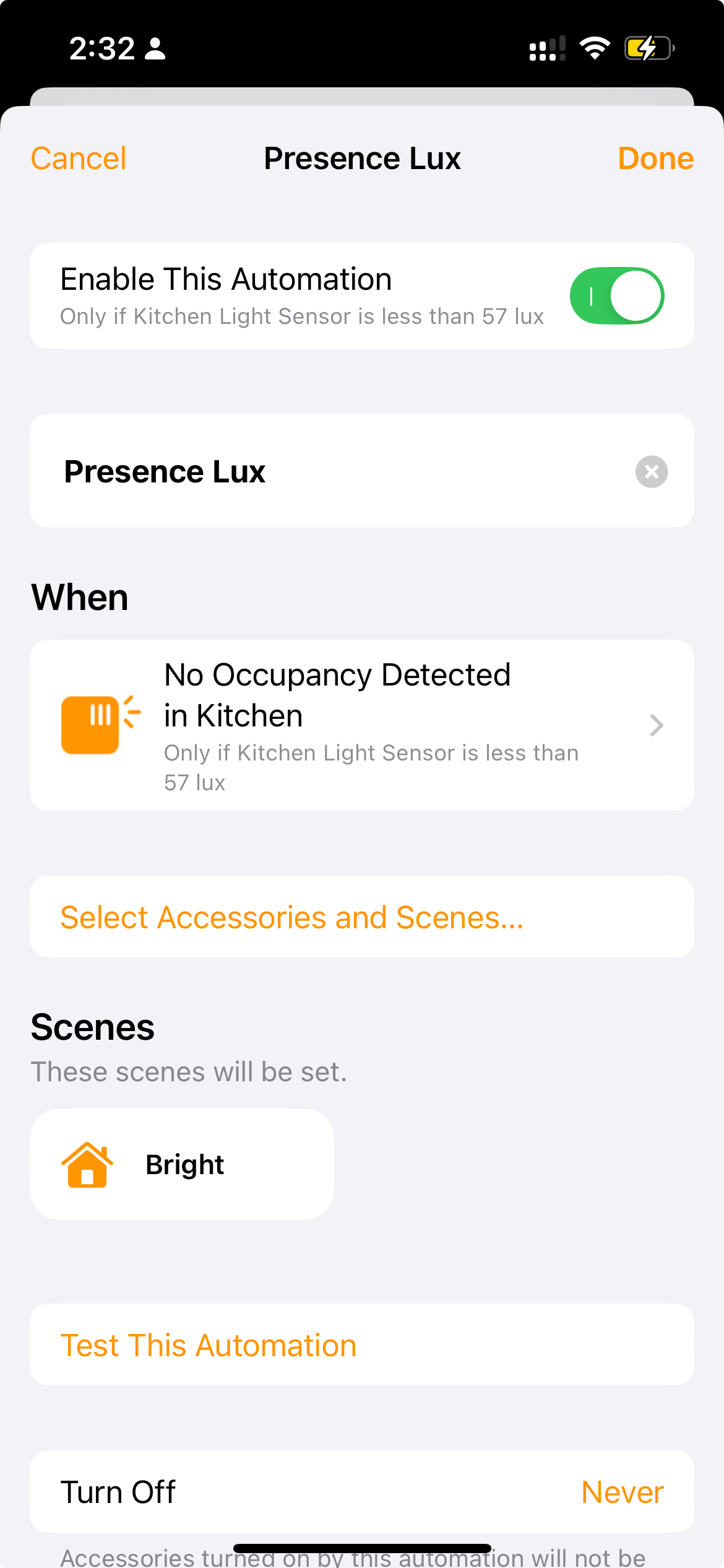

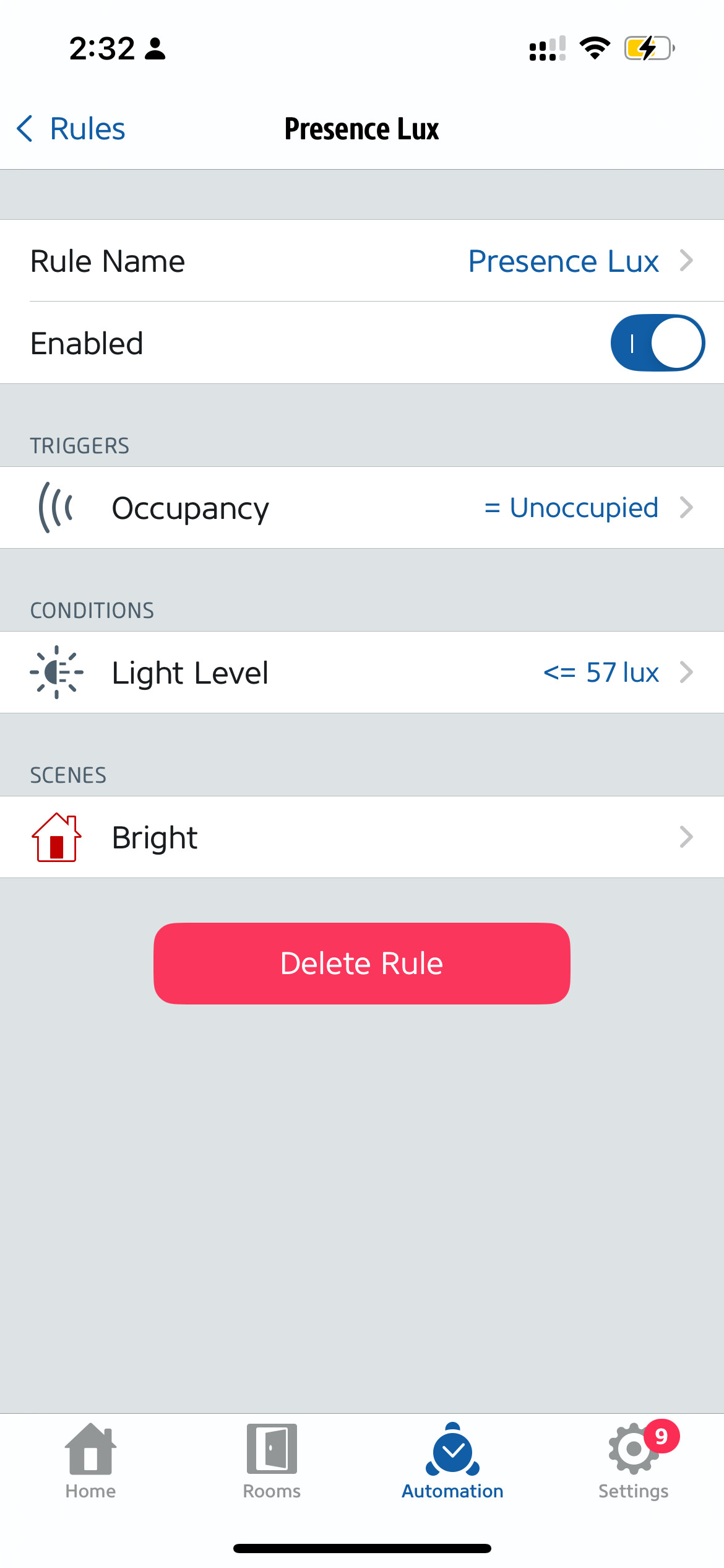

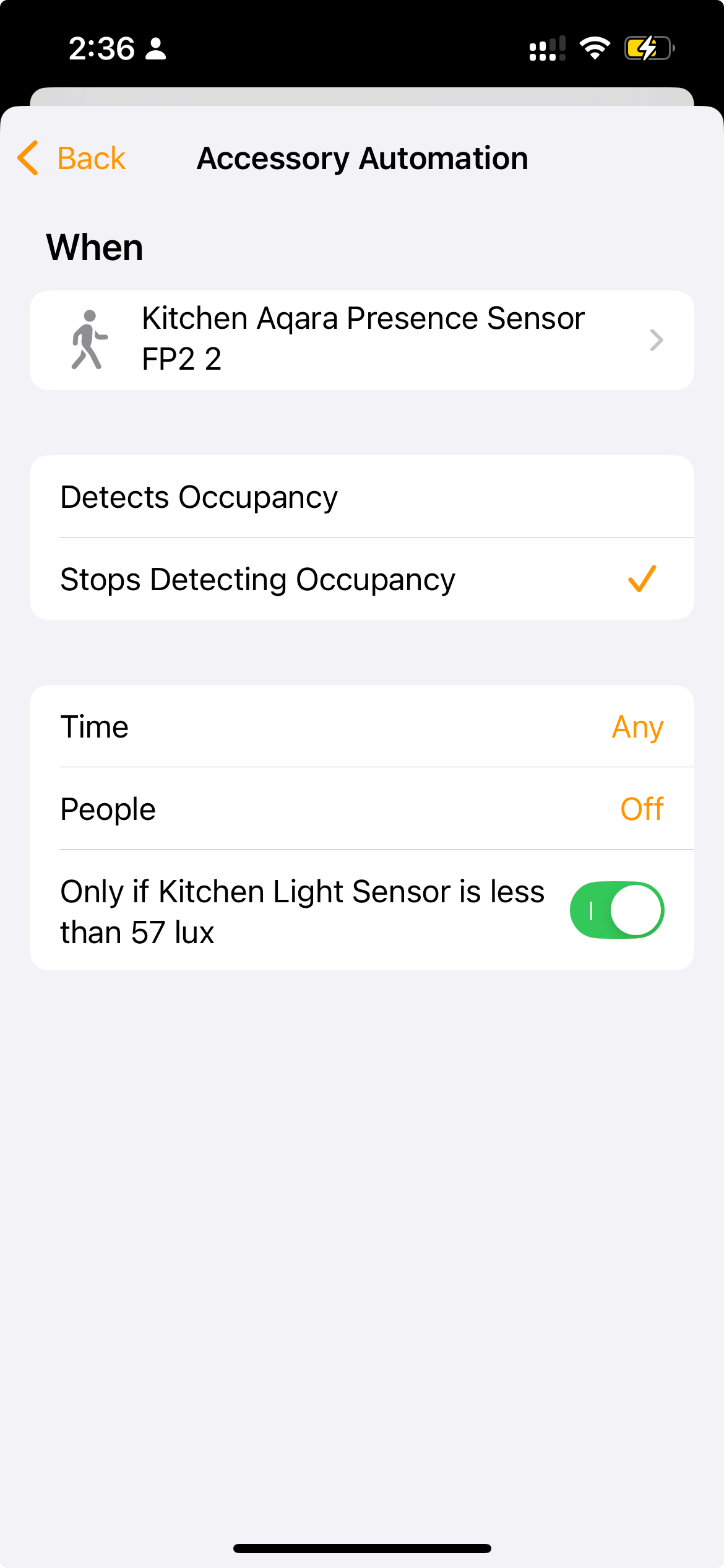

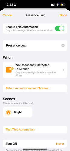

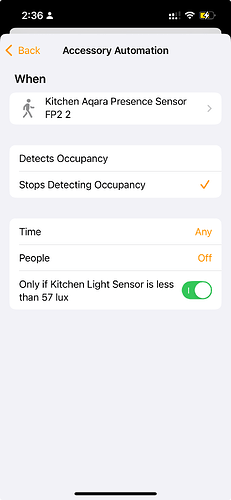

HomeKit is a framework, and Apple Home is just one app that uses it. You can use free apps like Eve or paid apps like Controller to build these automation with conditions for HomeKit specifically. Based on OP’s screenshot I’m guessing this is what he did.
Indeed, I’m aware. Apple is strategically retiring the more technical “HomeKit” name. As of iOS 26, they are emphasizing “Apple Home” as the unified brand for the entire smart home platform across all user menus.
Do you know a way to set the two conditions for light intensity and presence using the Apple Home app?
I think you may be missing my larger point. You can’t do this in the Apple Home app, but you can do it in 3rd party HomeKit apps as conditions are part of the framework [this is different than if you were to build the automation in the Aqara app]. And OP must know this since he has shown he has the automation properly built with Presence as a trigger and Lux as a condition.
Yeah, that’s exactly what I meant by “My conclusion: It doesn’t work without an additional app.”
Wait a minute… how did he define Lux as a condition?
There are 3rd party HomeKit apps like Eve (Free) or Controller or Home+ that expose the full HomeKit framework.
Let’s take Eve as example.
When you build your automations you first choose the trigger (Occupancy Yes or No), then the Condition (Lux <= x), and then the action (turn on lights, trigger scene).
Then you’ll see this saved in Apple Home.
Why doesn’t Apple utilize their full framework in their own app? Great question with a not-great answer.
Yes, thanks! Unfortunately, I missed that in the screenshot and was completely off track.
