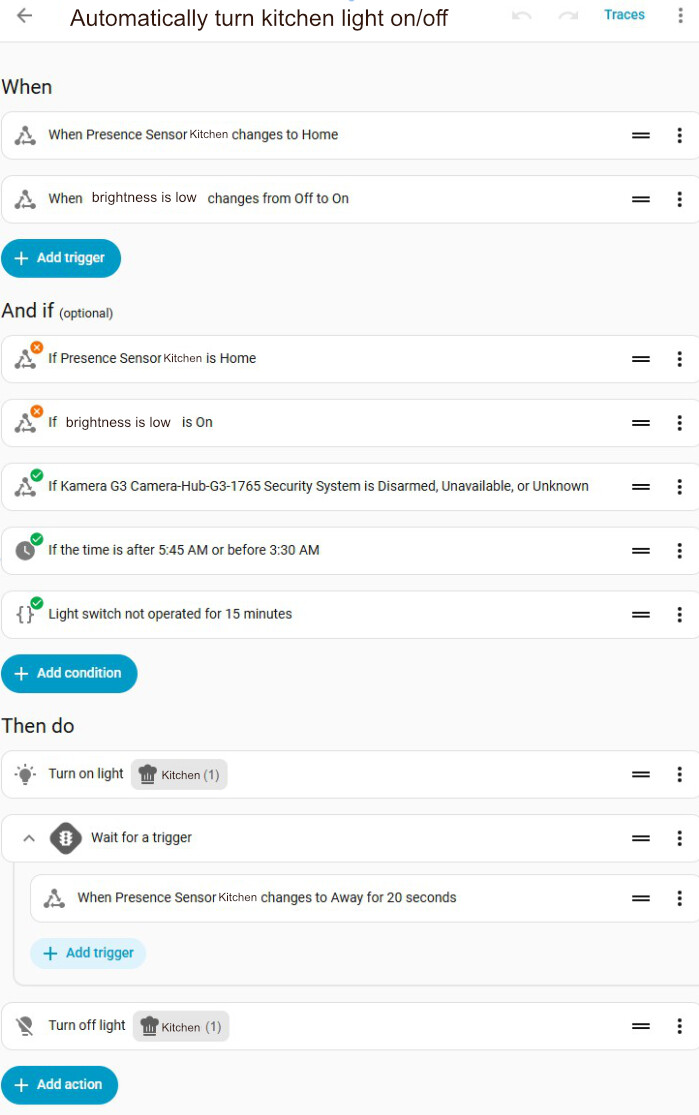

Cool. Yeah, I did something very similar! I just added a few extra things:
  • A sensor helper that triggers if any light sensor labeled “illuminance_sensors” hits the threshold in the kitchen and the hallway to the kitchen (< 15 lux in the morning, < 25 lux from noon).
  • Alarm system integration (the lights won’t turn on automatically if the night alarm is armed).
  • A fixed timeframe when the lights should never turn on.
  • A manual override so the lights stop switching automatically if the physical wall switch was used.
  • I also set the mode to restart. Since we use a delay before turning the lights off, this makes sure the countdown just resets if the sensor triggers again.
Screenshot from Home Assistant
YAML for Home Assistant

alias: Turn the kitchen light on/off automatically
description: ''
triggers:
  - trigger: state
    entity_id:
      - binary_sensor.presence_sensor_fp2_ae68_presence_sensor_2
    to:
      - 'on'
  - trigger: state
    entity_id:
      - binary_sensor.lux_threshold_met
    to:
      - 'on'
    from:
      - 'off'
conditions:
  - condition: state
    entity_id: binary_sensor.presence_sensor_fp2_ae68_presence_sensor_2
    state:
      - 'on'
  - condition: state
    entity_id: binary_sensor.lux_threshold_met
    state:
      - 'on'
  - condition: state
    entity_id: alarm_control_panel.camera_hub_g3_1765_security_system
    state:
      - disarmed
      - unavailable
      - unknown
    enabled: true
  - condition: time
    after: '05:45:00'
    before: '03:30:00'
  - alias: Light switch not operated for 15 minutes
    condition: template
    value_template: >-
      {{ ( as_timestamp(now()) -
      as_timestamp(state_attr("automation.light_switch_on_off","last_triggered"))
      |int(0) ) > 900 }}
actions:
  - action: light.turn_on
    metadata: {}
    target:
      area_id: kitchen
    data: {}
  - wait_for_trigger:
      - trigger: state
        entity_id:
        to:
          - 'off'
        for:
          hours: 0
          minutes: 0
          seconds: 20
  - action: light.turn_off
    metadata: {}
    target:
      area_id: kitchen
    data: {}
mode: restart
