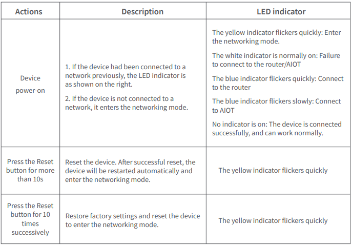

The last couple days my FP2 seems to be stuck in a restart loop.
On the app it says the network connection has timed out.
But the device keeps flashing blue, stops for a few seconds, flicks to yellow, then back to flashing blue.
Tried rebooting the device - have not reset the device or removed though as I’d seen before people were unable to readd them after and I have quite a complex automation set up tied to this in Apple home.
Any suggestions?
The FP2 connects via WiFi, so it may be stuck in something that looks like the restart loop if it cannot connect to the network (or disconnects for whatever reason).
Did you change anything in your WiFi setup? Do you experience network problems on your phone or computer?
Did you already tried to resetting it ? I would recommend and try that
Exactly! Try resetting the network first by pressing and holding the reset button. If that doesn’t help, try a factory reset – things can’t get any worse than they already are!
Image Source: https://cdn.shopify.com/s/files/1/0710/9220/7830/files/Presence-Sensor-FP2_User-Manual.pdf?v=1723628346
