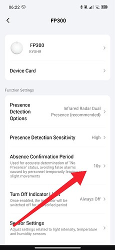

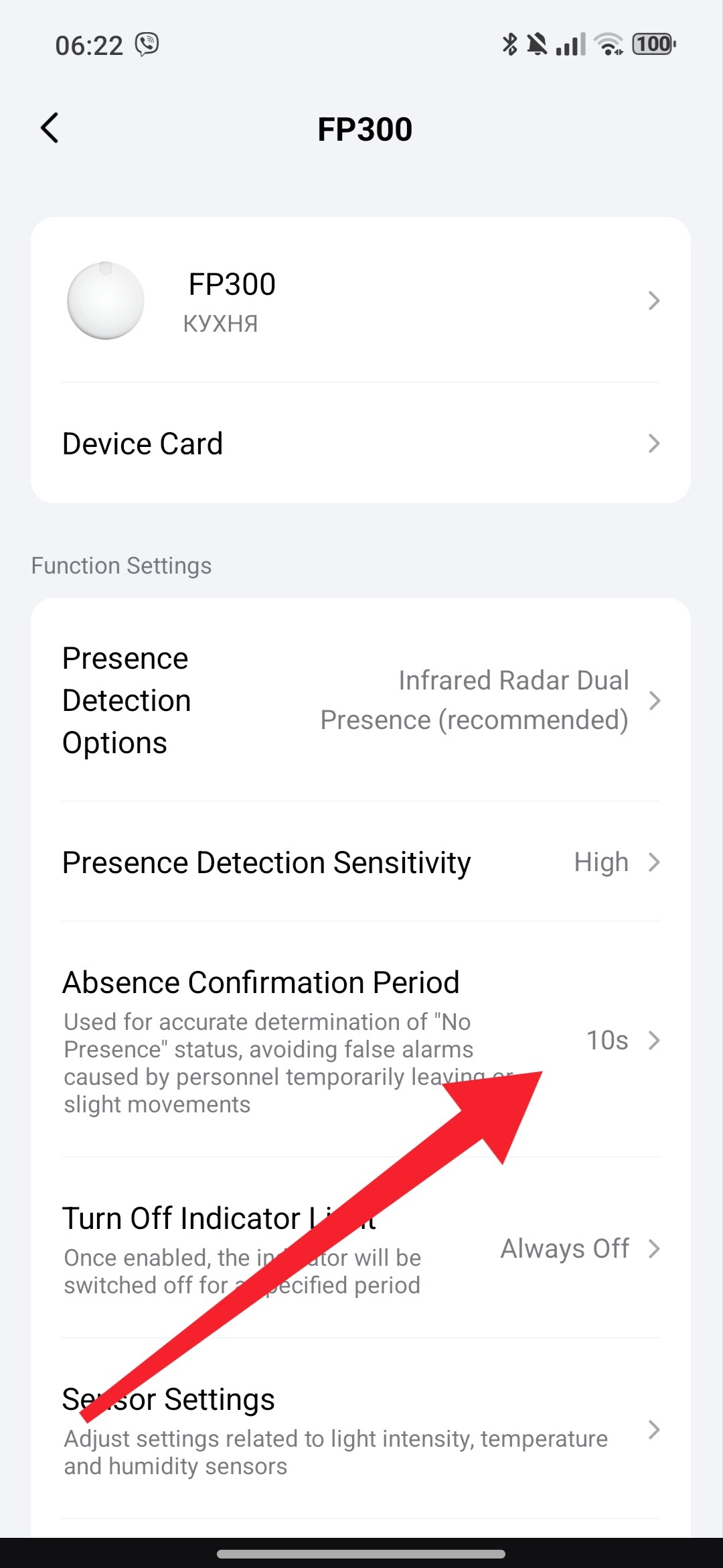

Hello, this parameter is critical for battery discharge.
Funnily enough I also have one in the bathroom and that seems to be doing fine (although the battery isn’t reporting clearly in HA so I can’t be certain of that)
Good to know, thanks! I’ll try lowering(?) that
