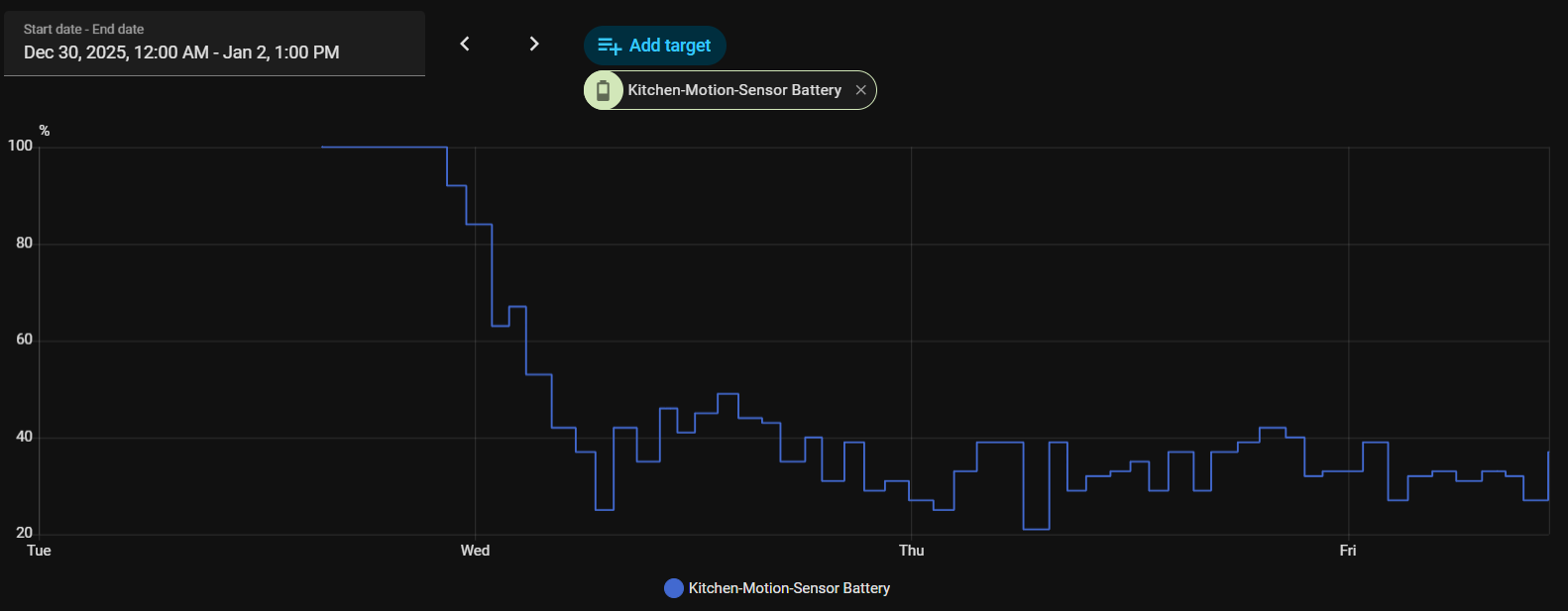

I seem to have “massive” battery drain on my FP300… installed mine on 30th December (100% battery), and it is already on 32% … and also, not sure why … but my battery seems to show up and down (from Home Assistant reports)

This is from within Home Assistant

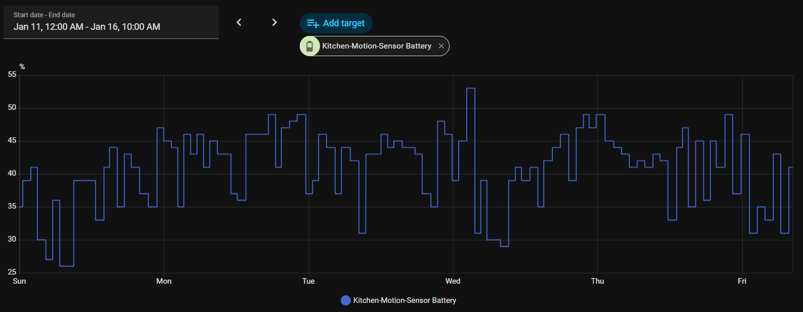

Based on that abrupt fall, my guess is one of the batteries it came with has an issue. Does the graph still show a consistent level at 32%? Also, those jitters are pretty common based on posts I’ve seen.

It seems to have stabilised … but interesting that it is now showing as 41% battery … and definitely still the ups and down

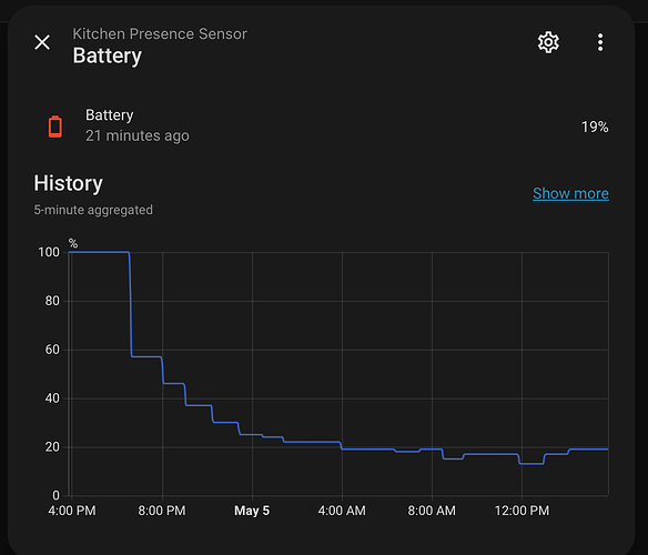

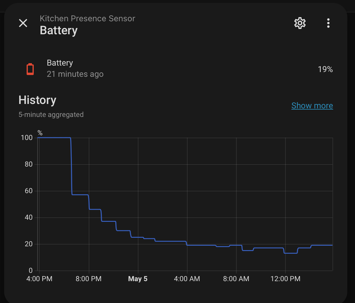

I’ve had TERRIBLE battery life from my FP300. The batteries that came with it lasted about a month, and I’ve replaced them twice. The last one I replaced yesterday and it’s now at 19%, 24 hours later.
Anyone know why? I can’t keep throwing batteries in this thing every week. I am using Energizer batteries that I bought new, so not some cheap unknown brand.
Connected via Zigbee2MQTT into Home Assistant.

Hi, thanks for the response.
The Temp, Humidity and illuminance reporting all on on low, and reporting on threshold and interval.
Have both PIR and mmWave enabled.
I have the latest version of firmware. I was concerned I had some setting messed up so before I swapped the batteries yesterday I factory reset the device, set it back to Thread then back to Zigbee again to make sure the firmware was the latest:
0.0.0_5841
20260105
