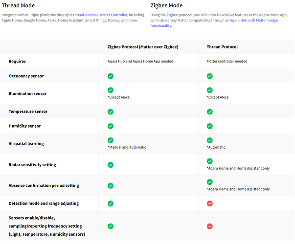

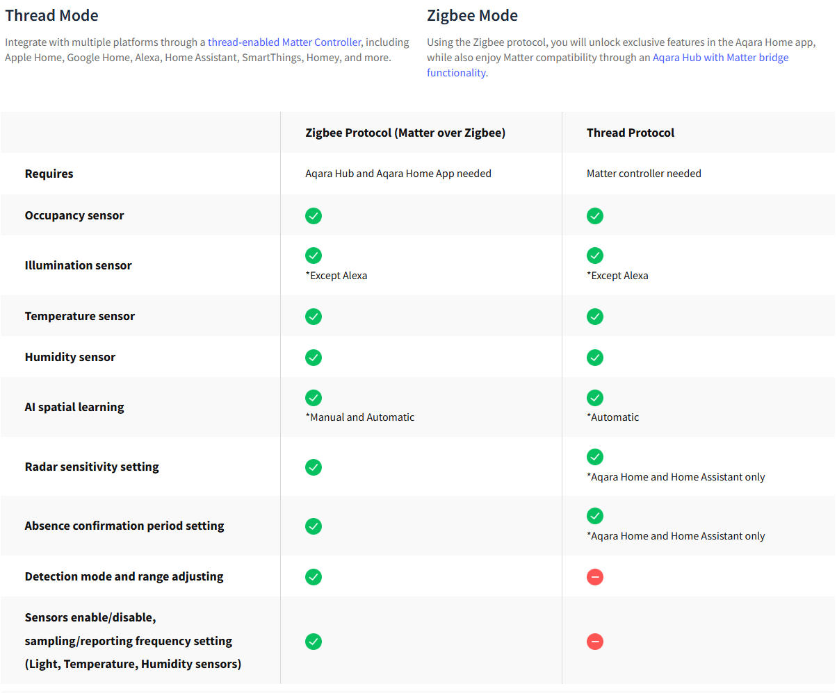

Regarding the advanced settings through Home Assistant: According to the official specifications (as shown in the technical sheet), you can adjust the “Absence period” and “Radar sensitivity” via Matter, but only if you use the FP300 in Home Assistant (with the Matter Server Add-on) or Aqara Home (with an Aqara Hub). The other advanced settings (such as detection mode, range adjustment, or update/report frequency) are not supported over Thread at all and are only possible via the Zigbee protocol.
Image Source: Aqara Presence Multi-Sensor FP300: 5-in-1 Detection
