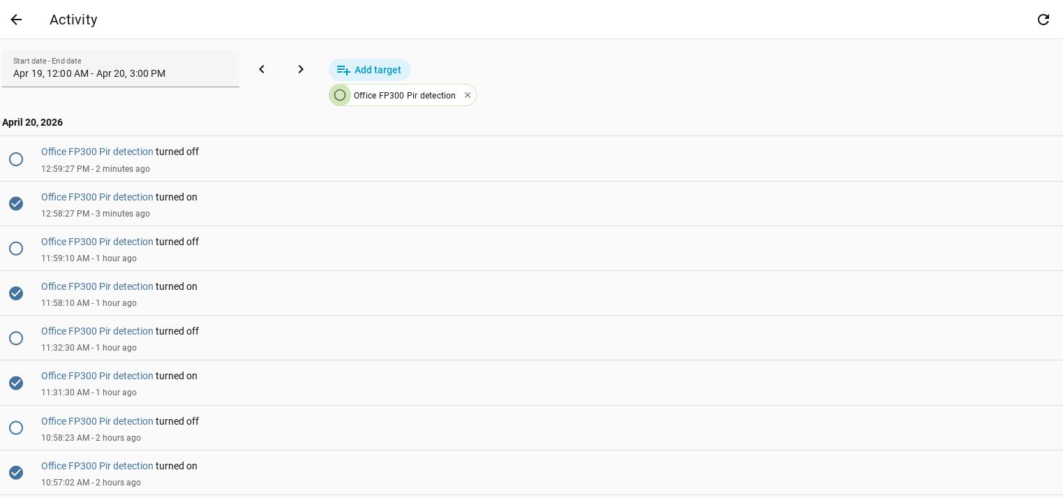

I have 2 of those I bought in november running 0.0.0_5234 wich runs perfectly well for me but just received 2 new ones with 0.0.0_5841 wich creates false positive every now and then, this is really anoying

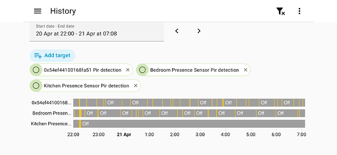

There is definitely an issue. Bought two more sensors after my kitchen one performed so well but had this issue with one of them. Have ordered a replacement which also has the issue. See image: all three sensors are in the same place, but two of them are regularly reporting false pir detections. All on the same firmware and all with the exact same settings
Early observations suggest that the new firmware (0.0.0_6542) fixes this problem
