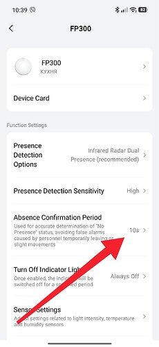

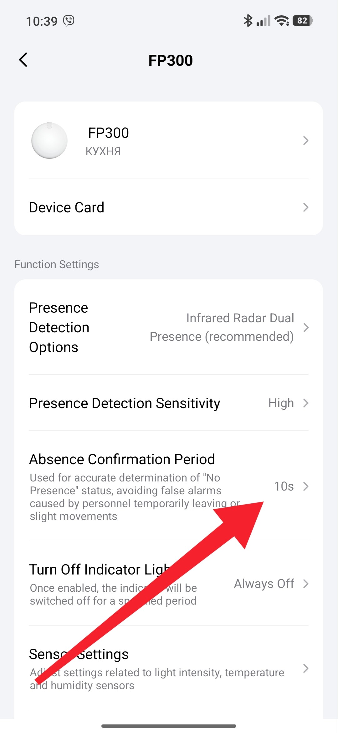

Hello, welcome to the forum. Check the room polling time settings. If it is too long, the automations may not work efficiently.
