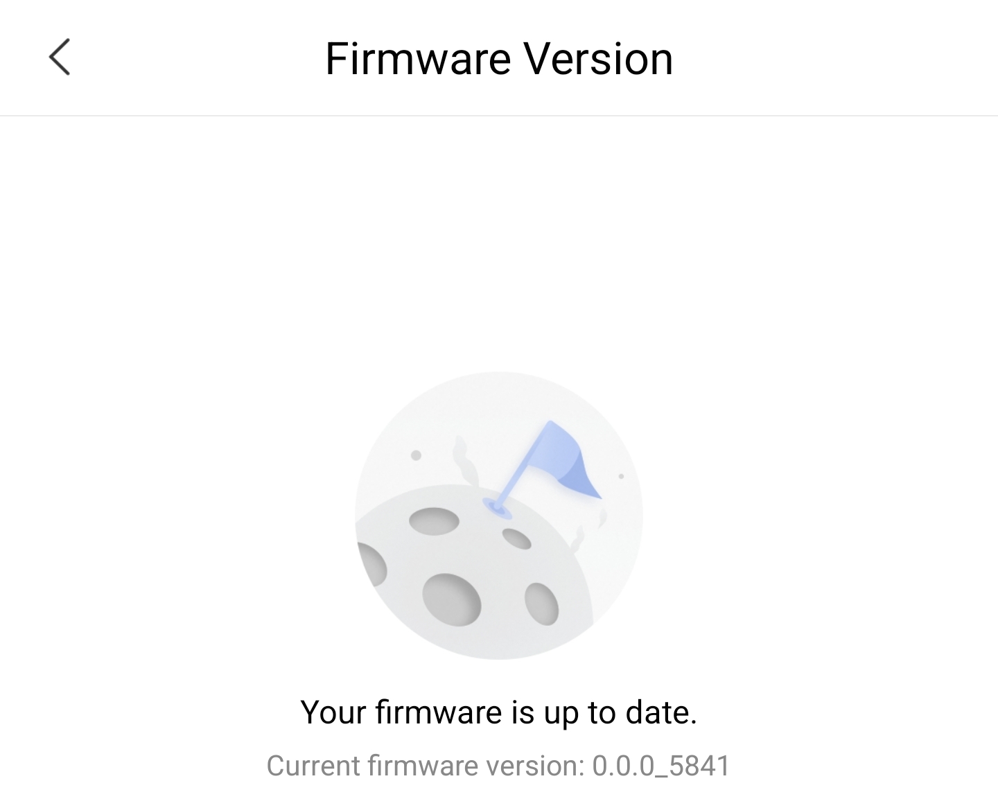

What firmware are you running on? You tried a full reset to factory settings?

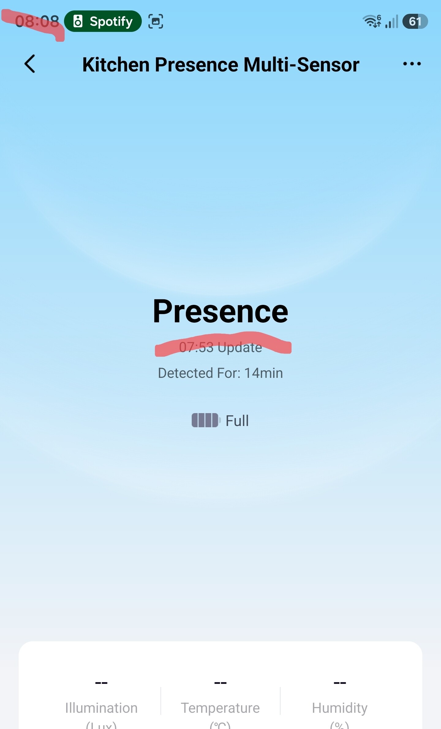

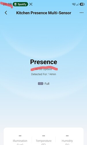

Unfortunately, after couple entries sensor stopped to respond agsin. It trigger presence but after leave it wont come back to absence.
I dont understand, it was great for months and now is not.

When I install another FP300 next to the faulty one, it correctly detects presence and absence. Falty unit detect presence from time to time and it stays in presence for hours.
I believe I have a faulty unit, and that’s the reason it doesn’t operate as it should.

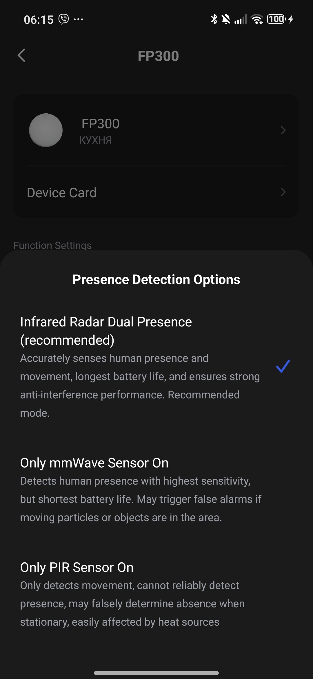

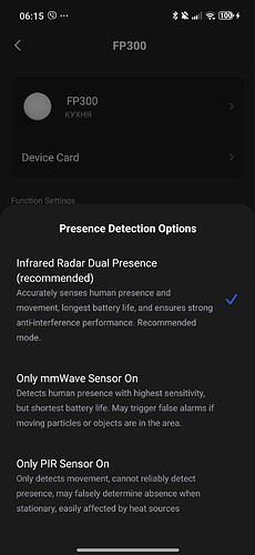

Hello, sorry for the inconvenience you are having with the FP300 sensor. I may repeat the question from the support team, do you have this setting enabled?
I‘m sure that Aqara will replace the faulty unit! But unfortunately they test and figure out if it’s still working or not - the FP devices have lots of features and through this it can be sometimes be just a simple thing to improve and make the unit working correctly again
Yes, mate.
We tried this with aqara advisers at first.
