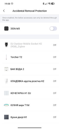

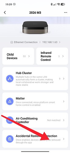

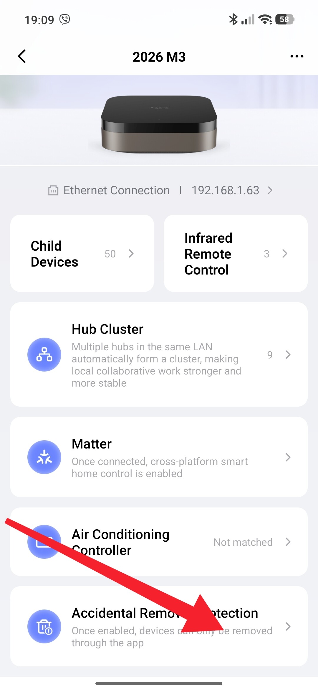

Disable the accidental deletion protection in the M3 hub settings and try resetting the sensor again; once reset, you can immediately add it to the app without needing to hold the button for 5 seconds.
This is what it’s doing when I got to press the button to add to the app
As @Raman.V said, go to the gateway settings and disable this “Accidental deletion protection” setting.
