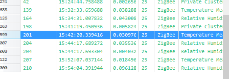

Using your identical configuration, I captured ZCL messages and found that the FP300 does not perform the division by 100 operation you described.
Could it be that the coordinator is performing a read operation on the sensor or similar?
Below are my ZCL messages, which clearly show no two data points are reported within a single reporting cycle (10 minutes).
Indeed, if such reporting behaviour existed, other FP300 units connected to Aqara would show identical patterns in their logs. To date, we have received no such feedback.

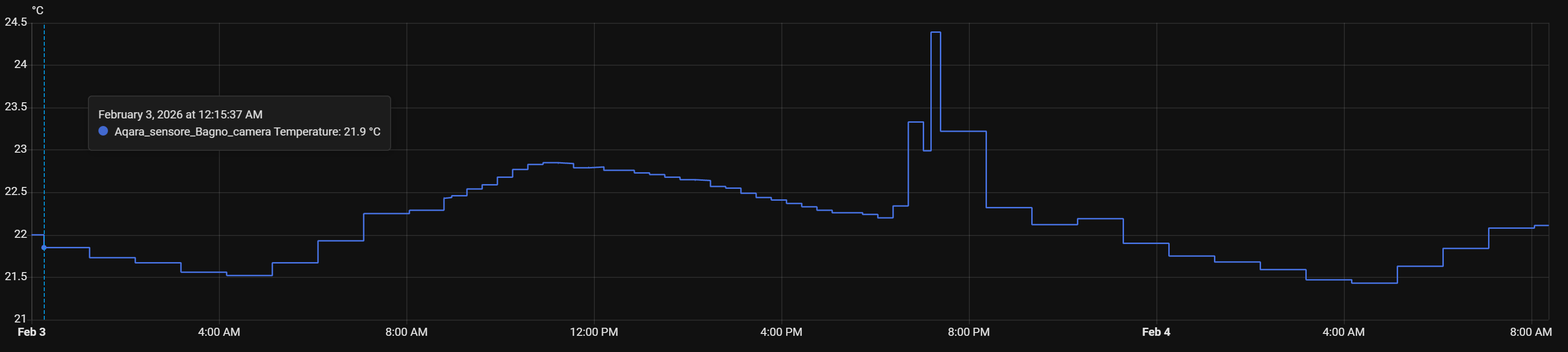

Having the same issue.
Temperature value will be sent twice, one is precise value and one is rounded value.
But this doesn’t happen on humidity.

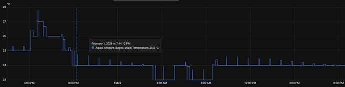

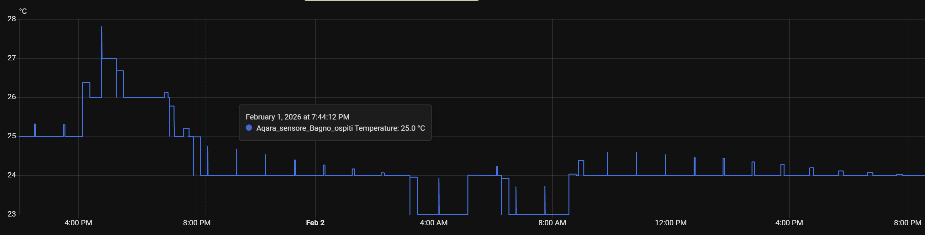

I’m having the same issue, but only with 3 out of the 4 FP300 I bought. They have all identical settings, but one looks like this:
while the others show the comb-pattern:

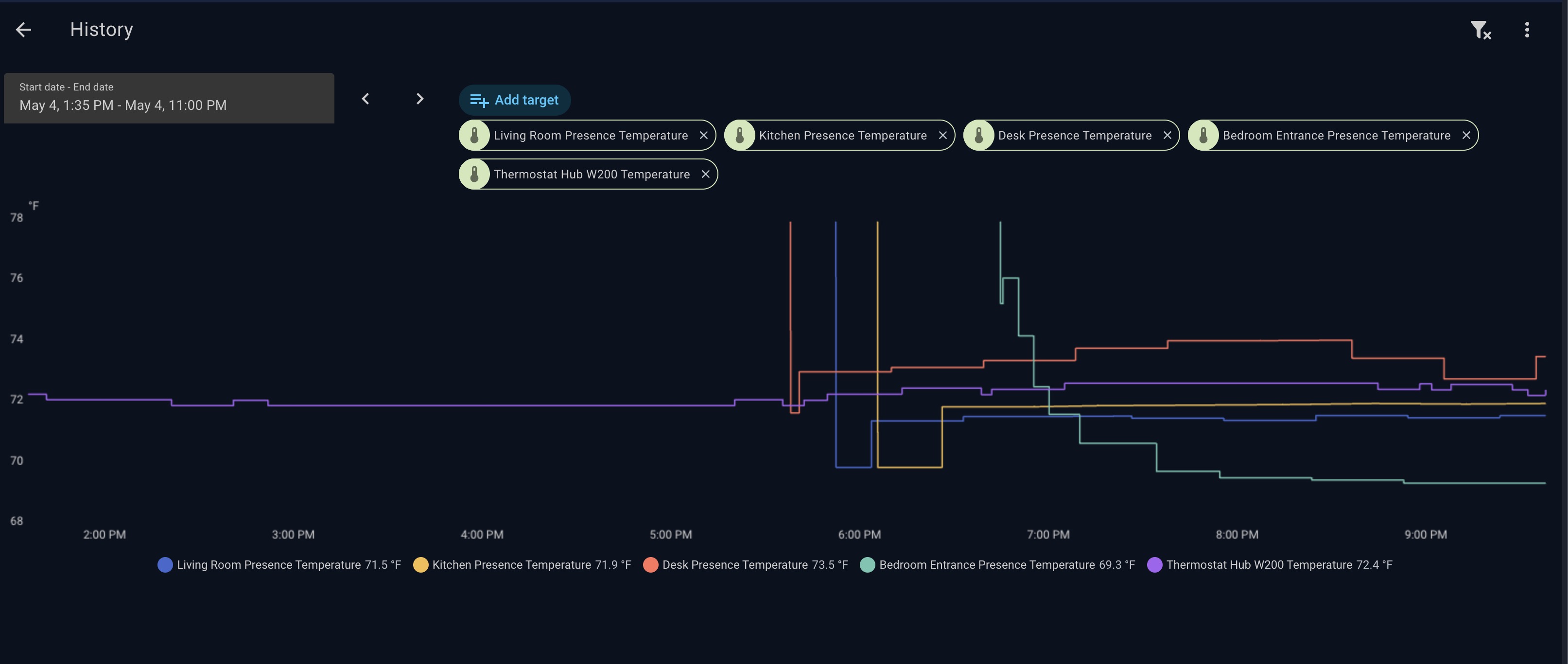

I have the same observation with my FP300 when used in zigbee mode. Is there a recommendation for the sample time setting to mitigate this comb-patter in the temperature data?
We have determined that this issue was caused by HA configuring an additional reporting cycle (resulting in the FP300 sending reports beyond the application’s control), and by the FP300 setting the data units to integers after sending the data.
We will release a fix for this issue shortly.
