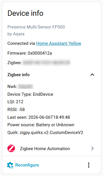

So, I updated my device to new firmware version like 3 days ago. I moved from 0.5xx to 0.6xx, I can’t remember the exact numbers in the official schematics, but my HA lists it as 0x0000412a. I connect using Zigbee network, and in the last 3 days since I updated, I’m having issues with my device. It stops responding, and it doesn’t seem to be a problem with my network itself, because the device doesn’t flash hen I press the button to wake it. It’s completely unresponsive until I hold the button for 5 seconds (even pressing the button 10+ times has no effect), when it goes into pairing mode, after re-pairing it, it works for about another day, and then it happens again.

LQI is 235-255, RQI is -50 to -40dBm and on the map, it seems to be connected to the closest light switch as usual - another Aqara, which is nearby, and it always worked. When I turn the light on, the “last seen” is updated, but when I walk in, trying to make the presence triggered, it doesn’t. Changing any settings isn’t synced to the device, even if I make it react by turning the light on and off and waiting for the reaction.

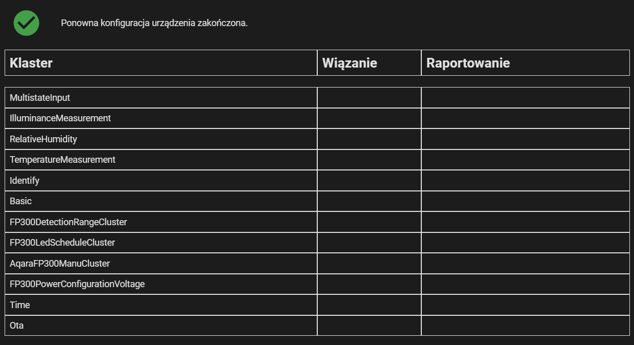

On rare occasions when it would stop responding on the old firmware, pressing the button once would fix the issue, and the device would respond to it by flashing blue, now pressing the button has no reaction, which makes me think this is a firmware issue, not quirk or coordinator/network. Hitting “reconfigure” doesn’t work either, or more precisely, it shows as “success” after a while, but the clusters aren’t populated.

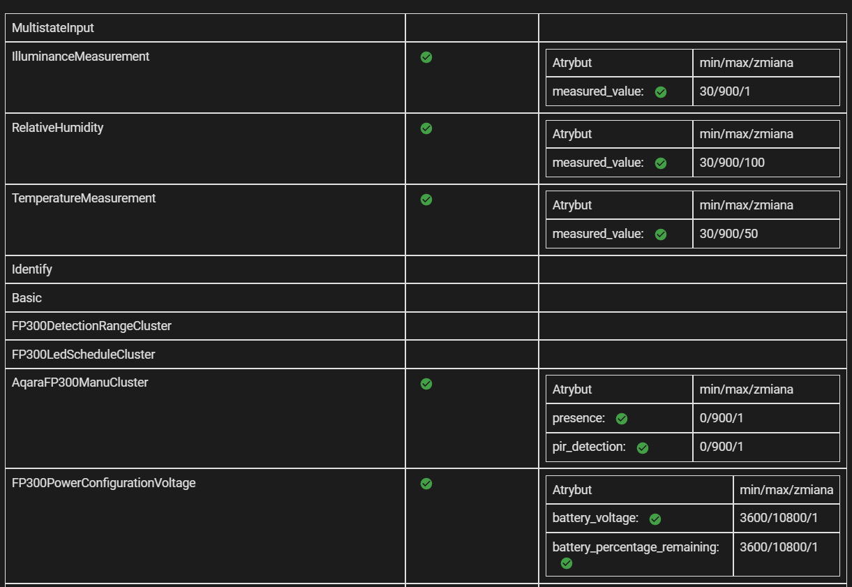

And then reconfiguring populates:
