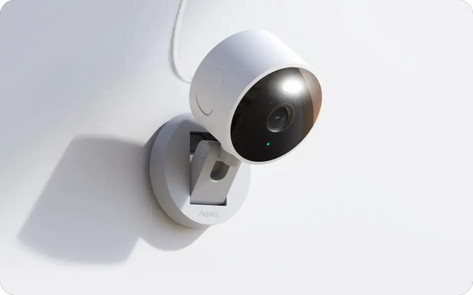

How do G100 factory reset
Hi @heliteck, welcome to the Forum!
The reset process for G100 is the following:
  1. Plug in the G100 and let it power up.
  2. Look for the small reset opening at the back.
  3. Hold the reset button with a pin for 10 seconds.
  4. The camera light blinks, then it’s reset.
You can find additional information here:
There is NO reset button on the back of my G100 camera. Is there any other options?
It’s under the rubber flap on the side of the camera.
