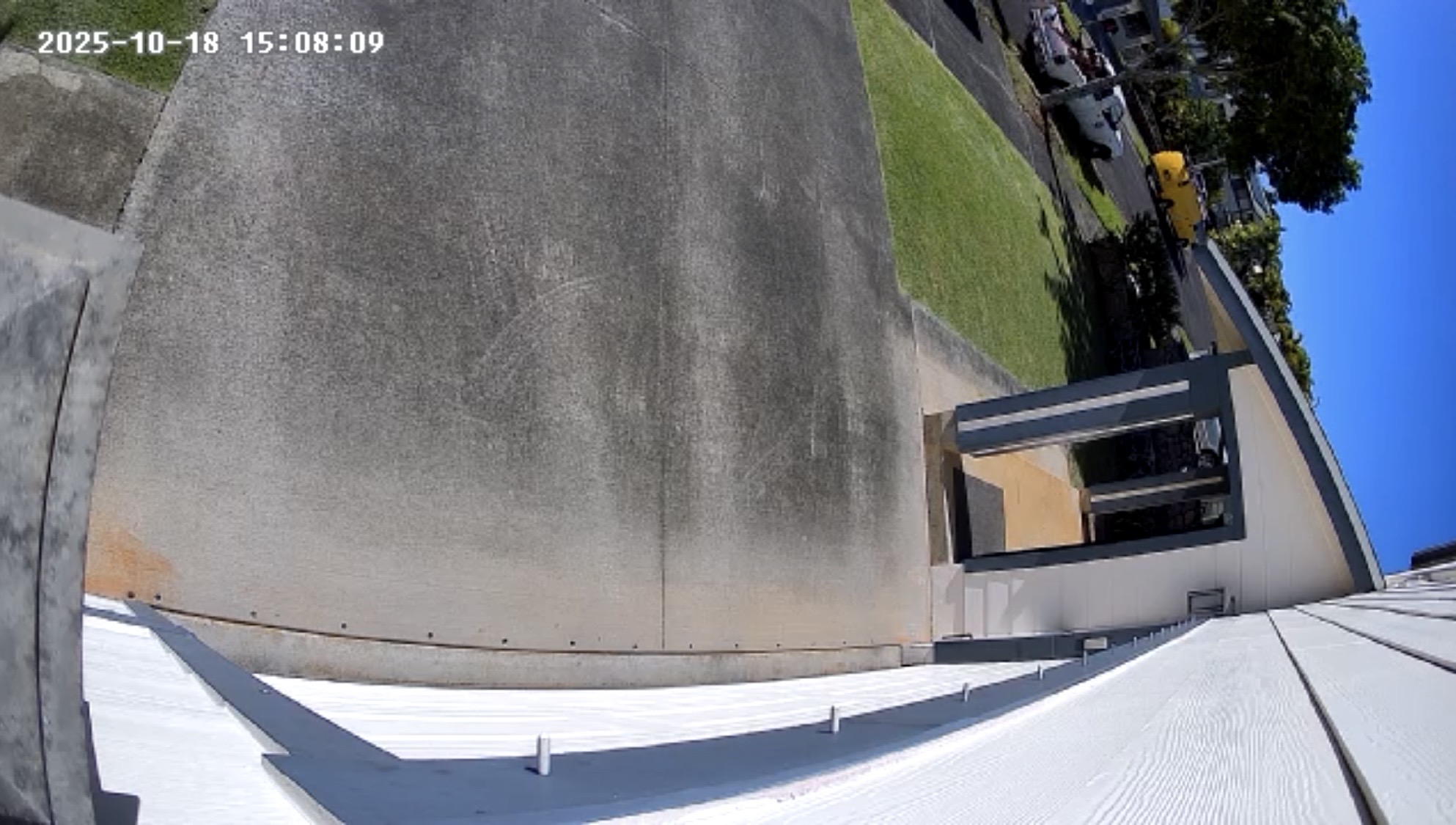

I have a G100 camera installed on the front of my home. Is it possible to rotate the image by 90 degrees?
I am unable to install the camera with a physical orientation to use the horizontal image configuration.
I have attached a screenshot showing how the camera is capturing my front yard and driveway.
Hi @jugs_hatted_6v the G100 only can rotate the pic by app 180 degrees.

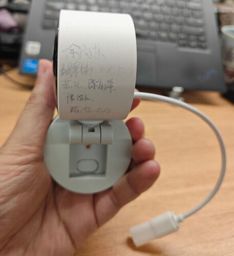

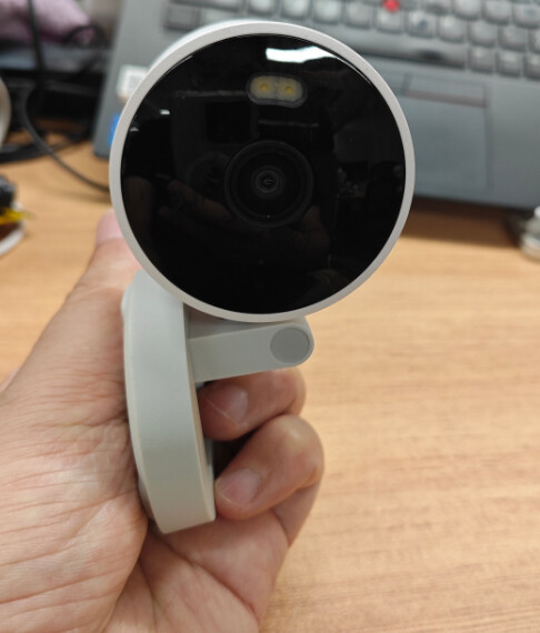

Actually, I think you just need to fold the bracket into this state to solve the video angle problem you need.

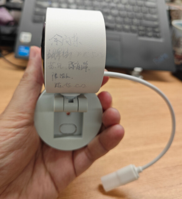

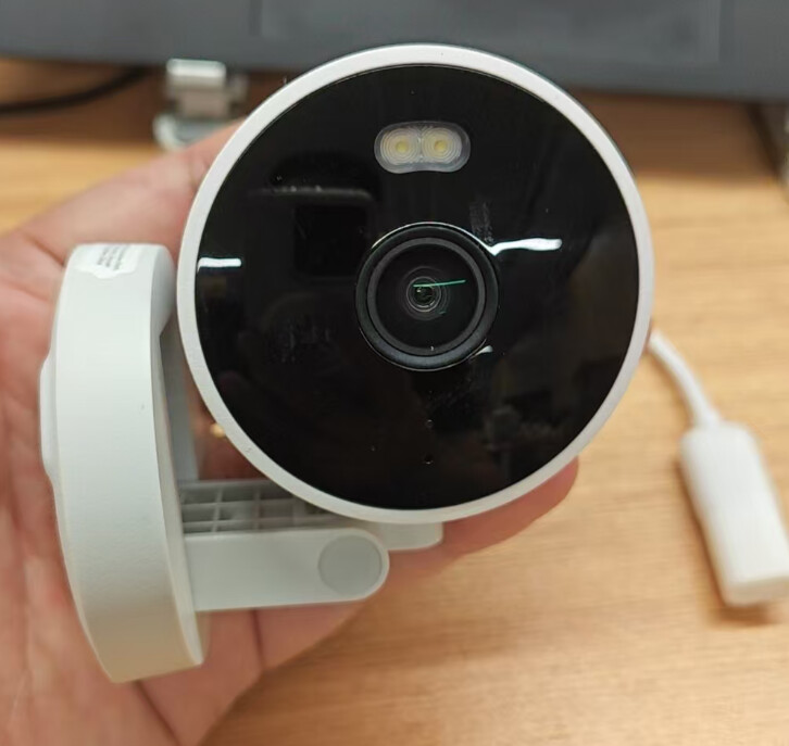

also OK for this state:
