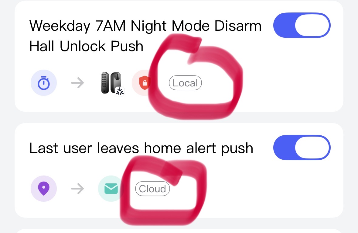

Think I managed to trouble shoot. For some reason the automations said Cloud as where they are controlled, but the once working says Local, so I deleted the once with Cloud and created them again and. Then they automatically changed to Local. Think it is an issue here you change from automations 1.0 to 2.0 that might mess some of them up.
Hope that makes sense and can help others.
@mikkelgraverjensen Thanks for sharing your troubleshooting journey! It’s awesome that you pinpointed the issue with automations being set to “Cloud” instead of “Local”—deleting and recreating them to switch to Local is a practical tip. Your observation about potential hiccups when transitioning from automations 1.0 to 2.0 could be super helpful for other community members dealing with similar time adjustment problems. We really appreciate you taking the time to share this, and hope you’ll keep the insights coming!
