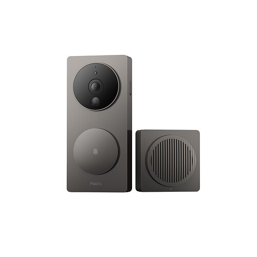

I just got and installed a G4 doorbell, and while the chime seems to connect to my network and Apple HomeKit fine, the chime doesn’t get any signal from the doorbell. The doorbell is both hardwired and has batteries in it, and no matter how close I get the chime there is no signal - I’ve even taken the chime outside and plugged it into an exterior outlet so it was inches from the doorbell. Signal says medium no matter the distance.
The doorbell does not ring the chime, nor does it light up for any reason. Is this an installation issue or is something wrong with the doorbell? Even if the doorbell is hardwired wrong I would assume the batteries would power the doorbell.

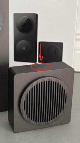

To reset the settings to factory settings, you need to press the button on the mod with a speaker (internal module) 10 times.
