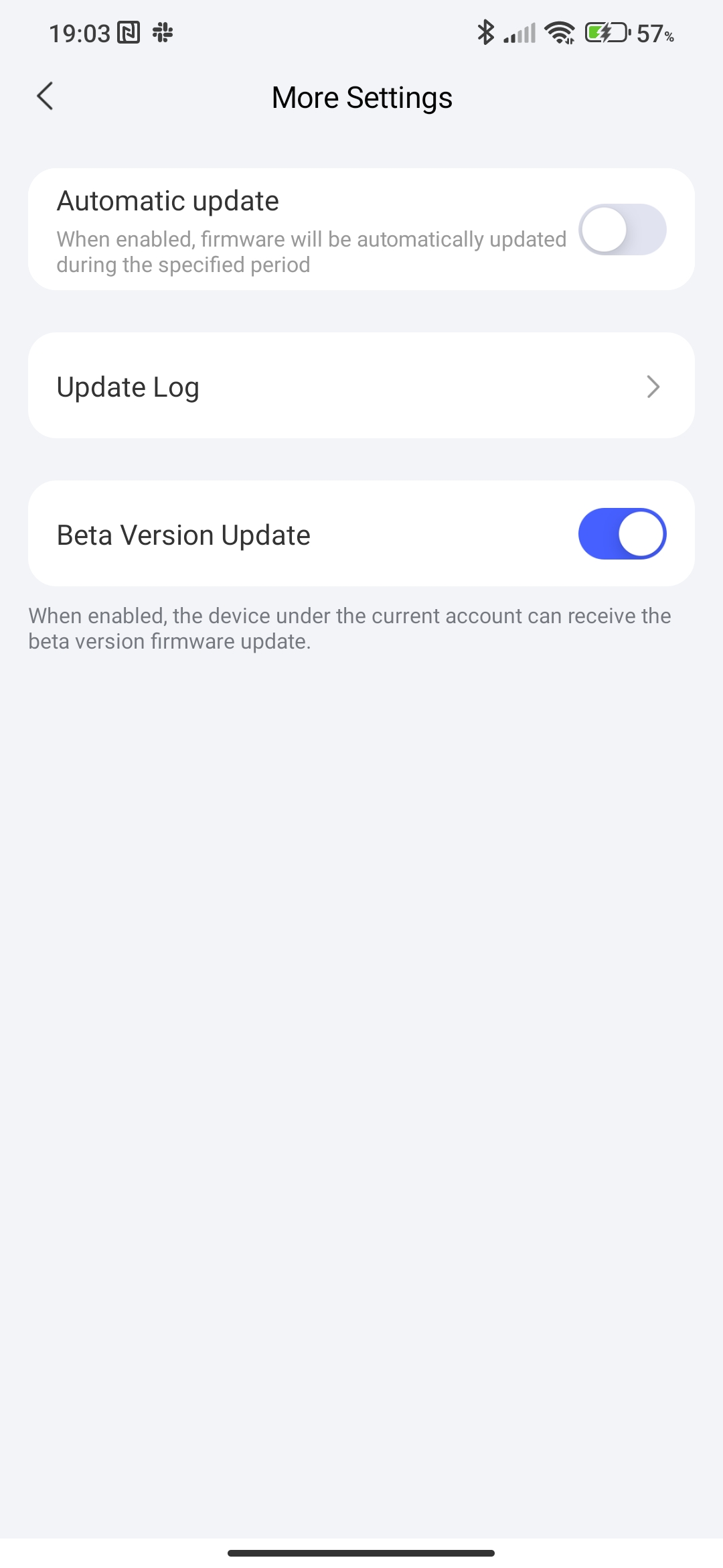

Let me just double check what you mean by the term “veto updates” as there is no such option in the app. Do you mean the option for Beta Version Update ?
If so, then note that I have already tried that previously and even tried again now and no new beta FW has been offered to me.
This works a little differently than you might think. Allowing you to veto updates doesn’t mean you’ll get updates right away. They’ll just come as they come. By allowing these updates, you’re agreeing to use updates that may have bugs (they’re not stable versions).
Thanks. I know what beta version means as I’ve been in sw development for a lot of years. So I’ll try to keep this option on permanently.
Anyway, let me ask why are you referring to it as ‘to veto updates’? Never heard sth.like that referring to enable(i.e. allow) vs. disable(i.e. disallow) beta version to be downloaded and installed
