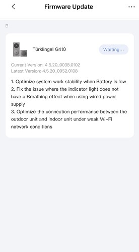

Update: This issue has fixed itself, presumably with a recent firmware update. I realised this morning that I haven’t changed the batteries in weeks, checked the level in the Aqara app, and they’re up around 60%. It’s possible that battery life now even exceeds what I was getting when I first installed it. Thanks mystery helper!
I suppose the mysterious helper was called Aqara :wink:
The batteries are still chugging along 3 more weeks later, still at around 40%. It’s actually pretty mind-blowing that Aqara can get this much battery life out of what is quite a complicated device.
