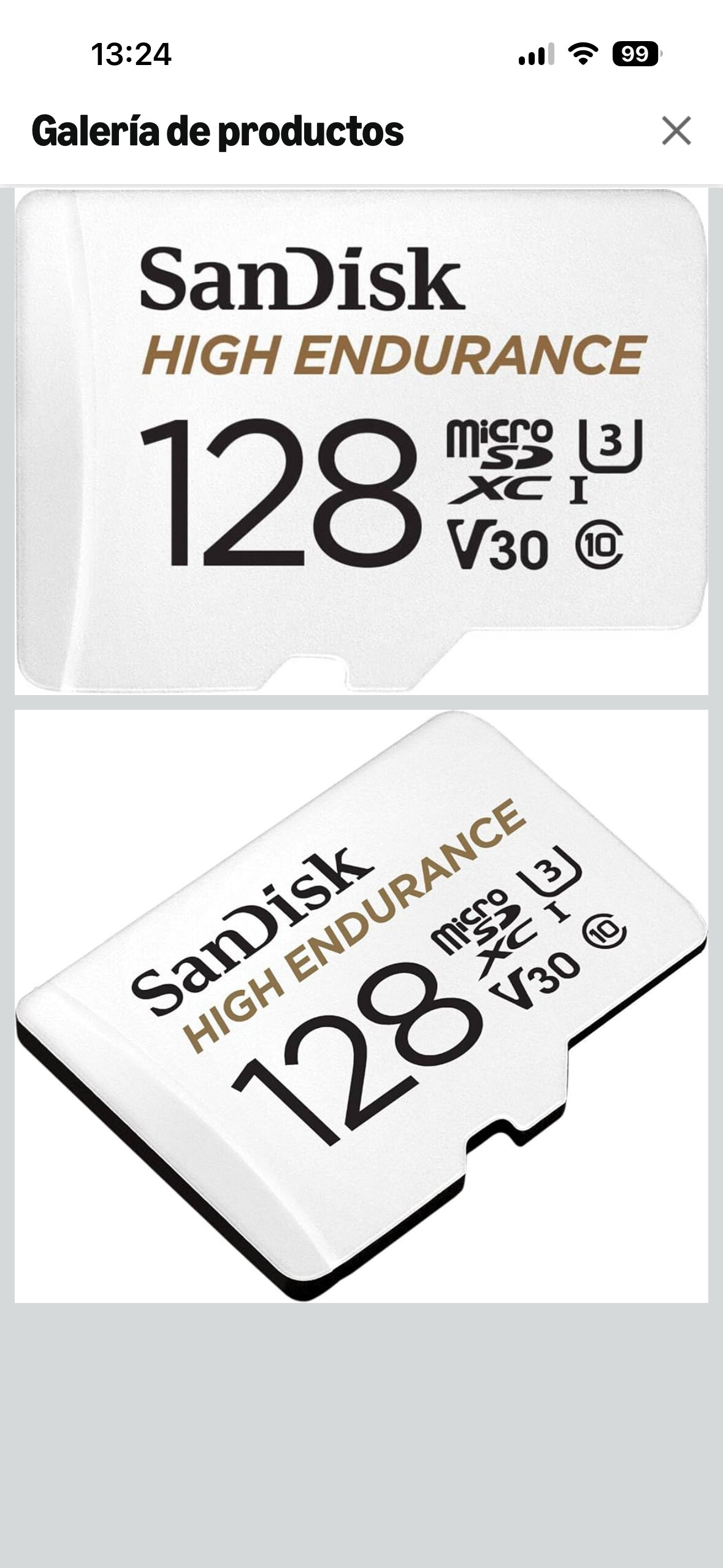

Yep I made same mistake with my G3 camera.i bought an cheap so called Xiaomi SD witch supposedly had 128GB when I got it was working but after a few day I notice that each night my camera was recording continuously but I could only see the video of the 1/2 nights ago the new one no even I add it to my iMac and see and still could see nothing and when I was checking on aqara app the SD says 128GB but on my iMac was way different like 132GB then I released that the SD wasn’t had more then 6GB and that is why my others videos I couldn’t see them sure I got refunded from AliExpress and I bought and this SanDisk one witch works great.
