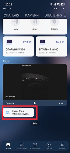

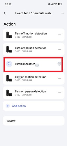

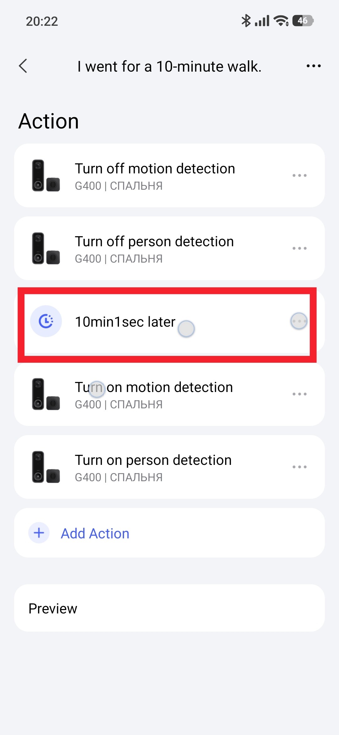

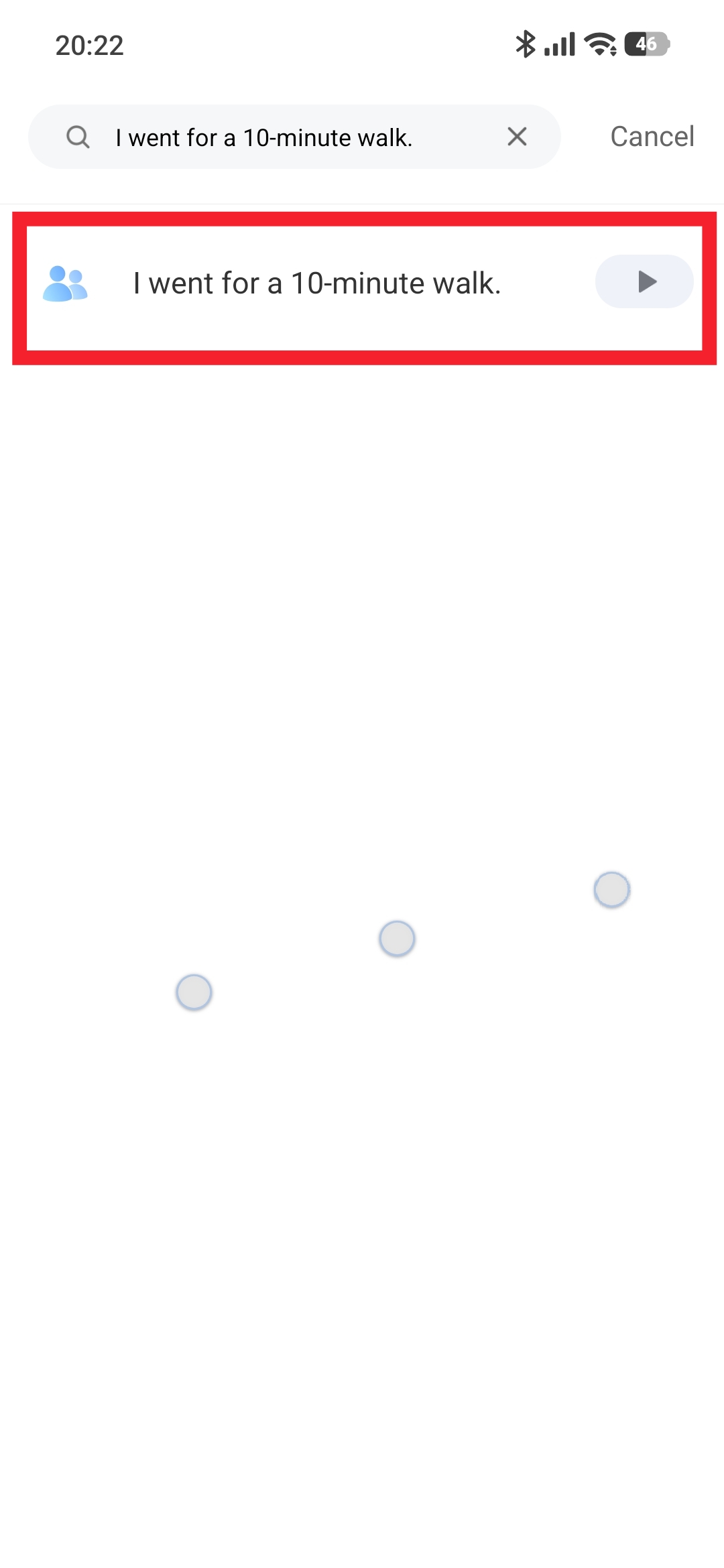

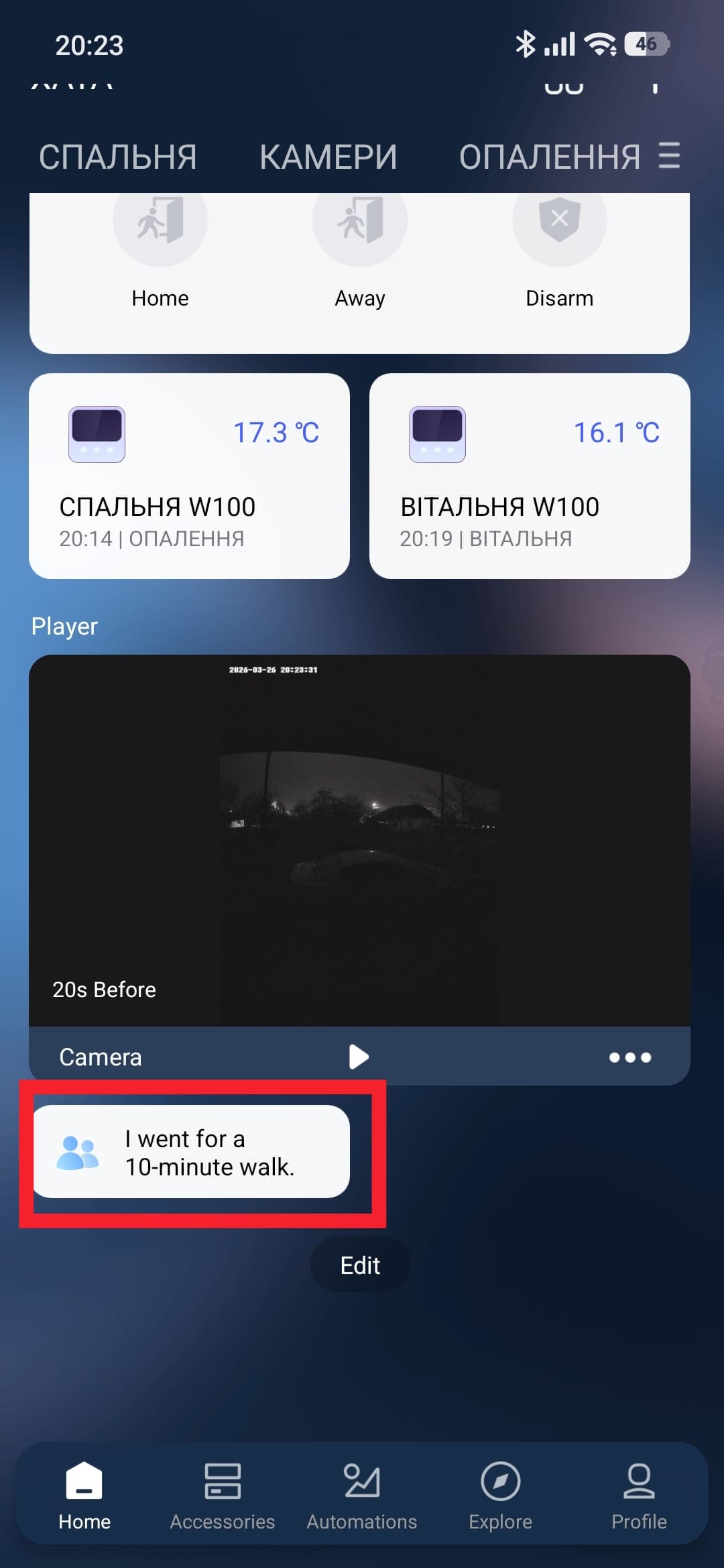

Hello, welcome to the forum. Unfortunately, in the automation on the G400 there is no option “Disable all notifications” and “Enable all notifications”. I suggest making a scene that can be quickly launched from the phone.
Fig.
Additionally, you can create an automation that will trigger a notification timeout (for example, a wireless button).
