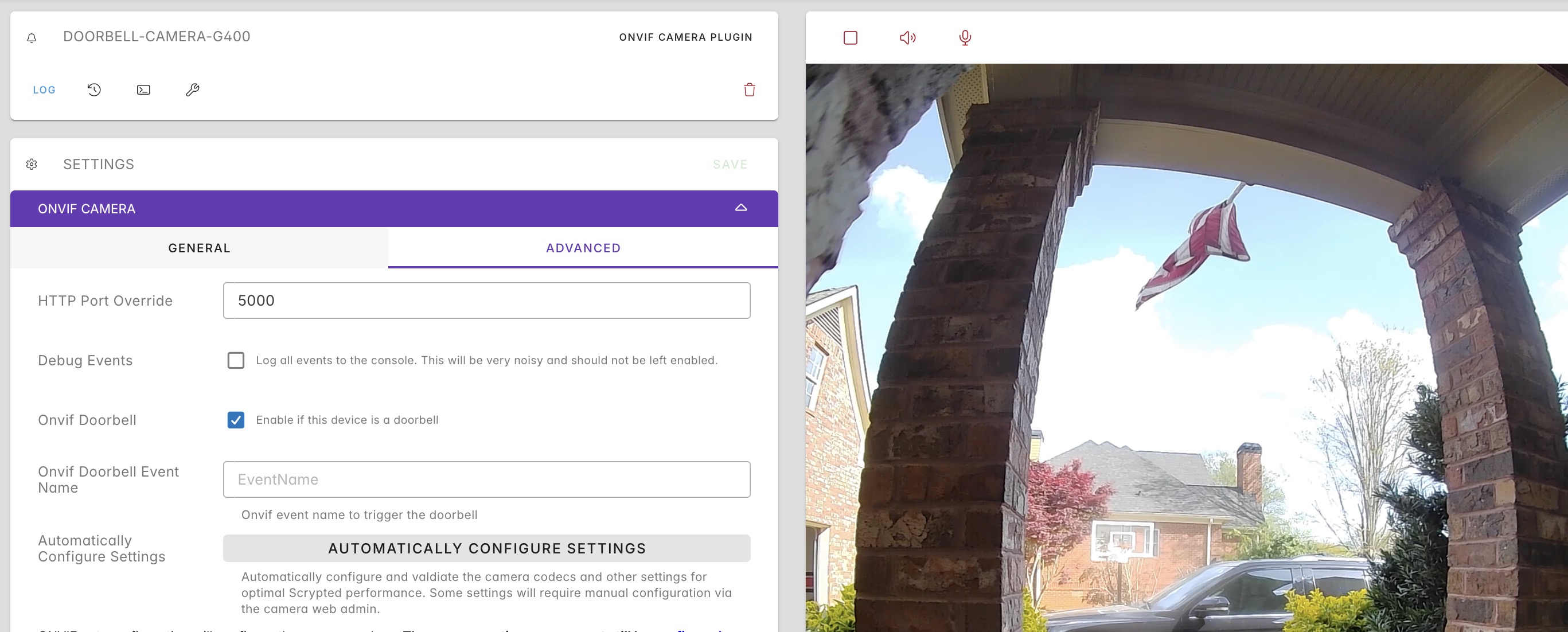

Since you want to deal with ONVIF specifically - I just tested it. Skip the auomtated configuration, then enable “onvif doorbell.” This seemed to be enough to get mine working.
