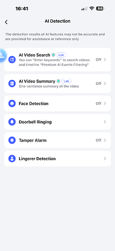

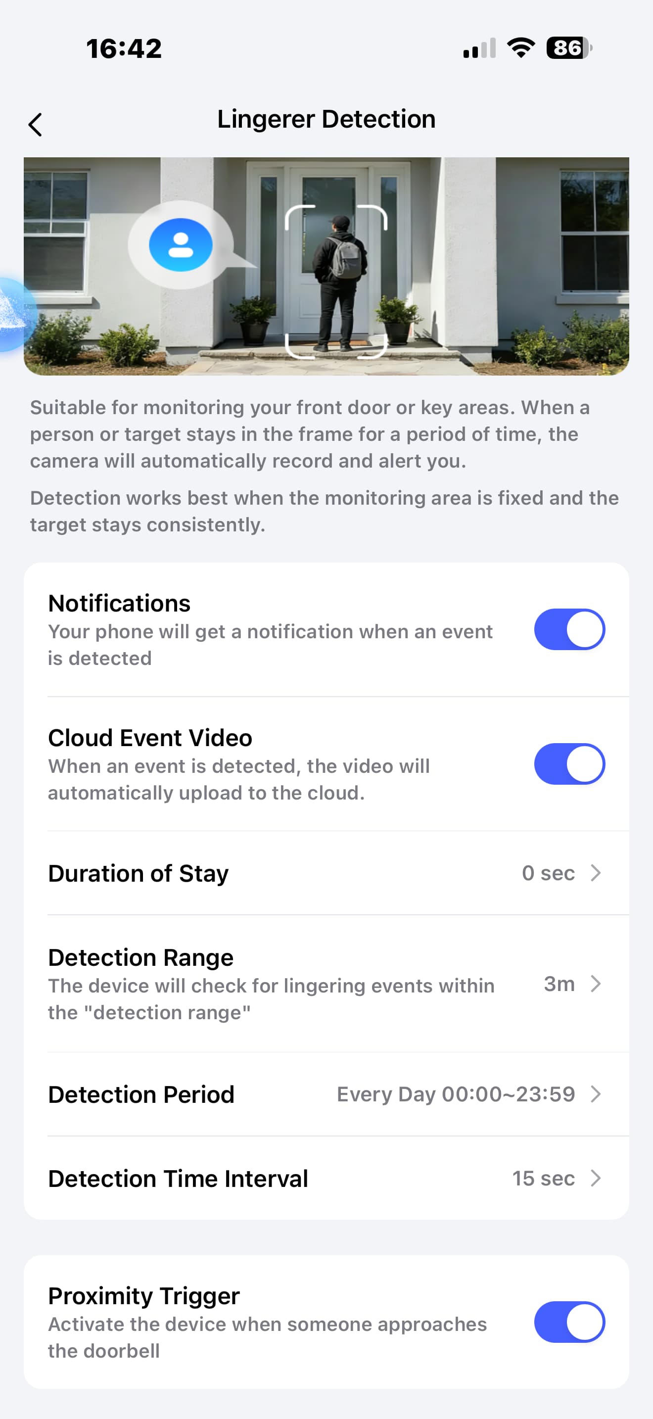

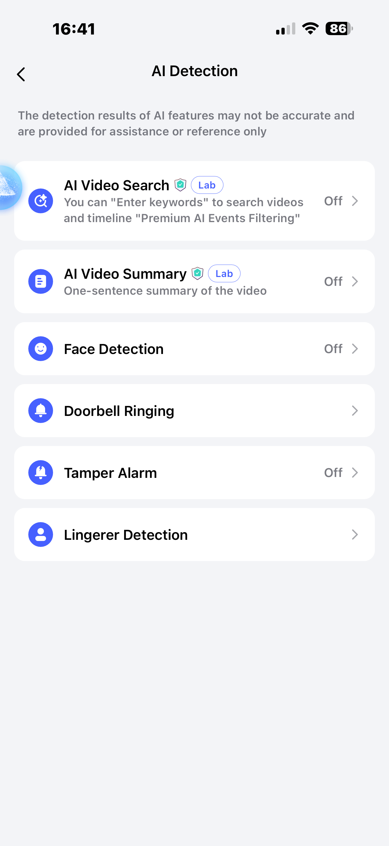

Can you please send screenshots of your detection settings under AI Detection > Lingerer Detection?
I’m trying to help you determine if this is something that can be tweaked via settings or if you have problematic hardware. The batteries should last more than a few days, but could be draining too quickly if it’s staying awake for unnecessary detections.

Looking at your pictures from earlier I see this is pointed in a fenced yard with what looks like a street behind it. The detection settings look ok, but figured I’d ask anyway… Is it somehow picking up a lot of activity behind the fence keeping it active when it shouldn’t?
Either way based on the configuration you shared I don’t think it should behave this way and you should ask support for help.
