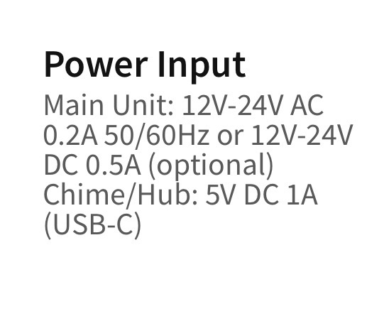

I would like to connect the Agara G410 to the power supply.
I would install a 2 Amper DIN fuse in the cabinet with 12V DIN adapter. Does the 12V adapter have to be 1A?
Hello @Mirkej
If your adapter is a little more powerful, this is not bad, the call will take as much as it needs and no more, so do not worry about this.
I will not connect it to the usb c port. I would like to connect it in the electrical box.
How is this best done? 2A fuse + power supply for example like in this picture?
Yes, you can use the power supply as in your photo and it meets the parameters
