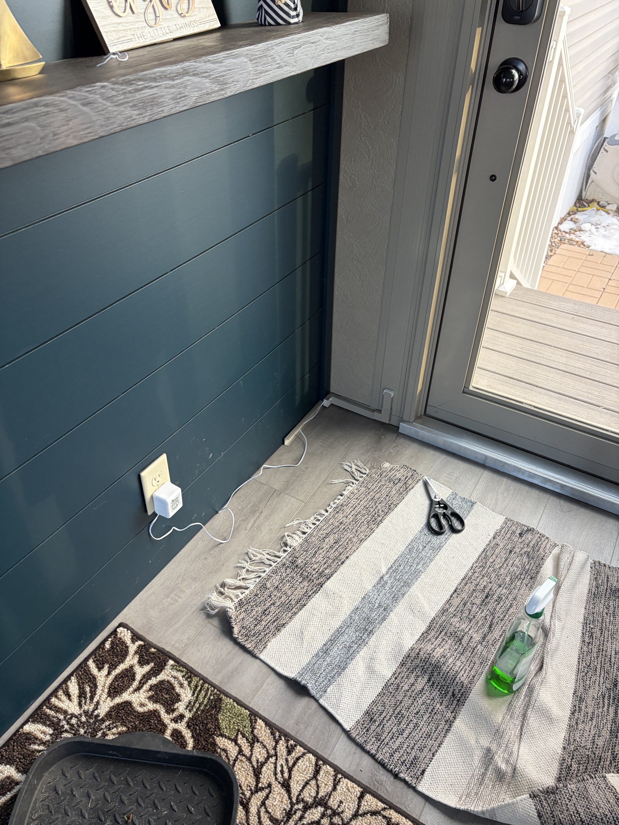

Installed the doorbell camera a few months ago and ordered a plug in adapter from Amazon for 20 bucks and this camera is picking up everything. I was having trouble prior with it missing people if they were moving too quick.

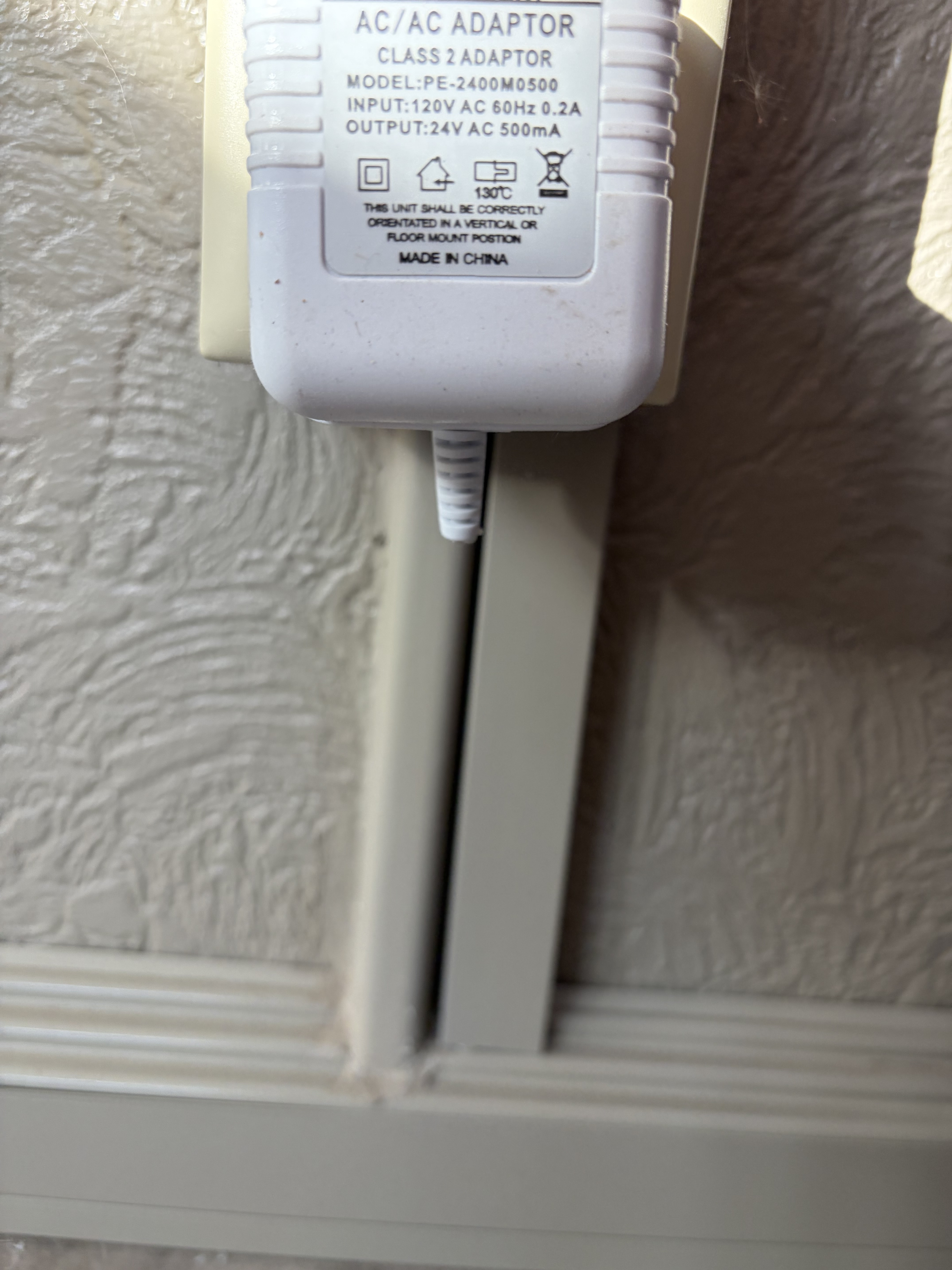

Search Amazon for a Doorbell Transformer 24V Adapter for Ring Video Doorbell
Totally agree. I had Blink cameras and doorbells and replaced everything with Aqara. At first I had batteries in G4 and G410 doorbells. The 410 went through the batteries in about 2 weeks so I decided to buy plug-in transformers for both on Amazon
. I ran the wires in some wire tracks that I painted to match. I also got those on Amazon.

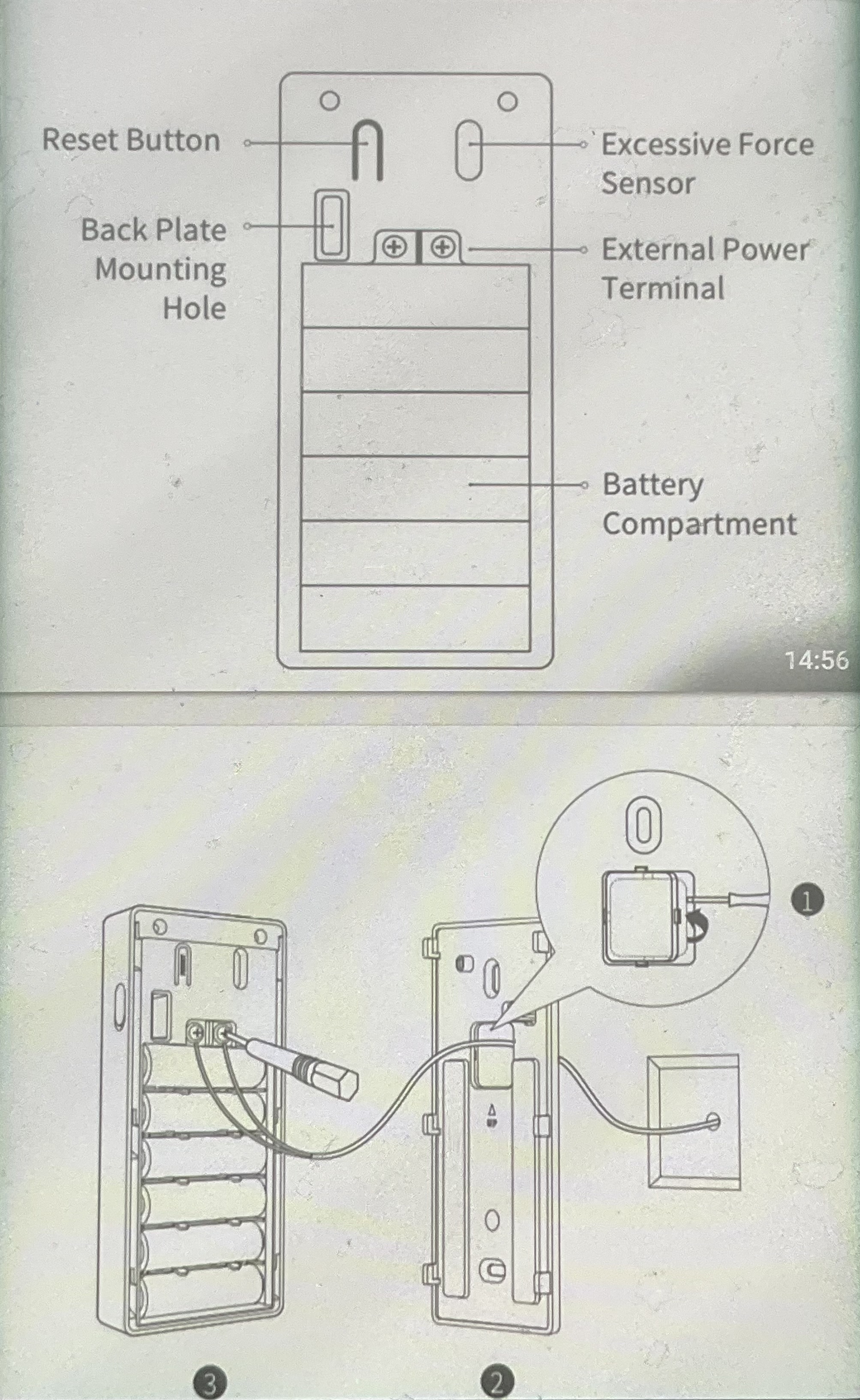

Can you tell me which of the wire connectors inside is “+” and which is “-“. i dont see any marking on them. Tks
I intend to connect it to 12V DC supply.
It doesn’t matter.
I was fortunate enough to be able to put this where there was a traditional doorbell and I agree it works a treat when wired
Was yours AC or DC?
As replied, does it matter?
DC has positive and negative.
AC has live and neutral.
We are generally told to connect to the correct ones to avoid damaging the electronics.
AC there was a transformer from my original bell that fortunately send the correct voltage and I think for low voltage electronics and certainly the G410 the polarity isn’t a problem you can connect either way round unless someone wants to correct me. Just don’t follow that advice with 240v mains socket then it’s super important :rofl:
