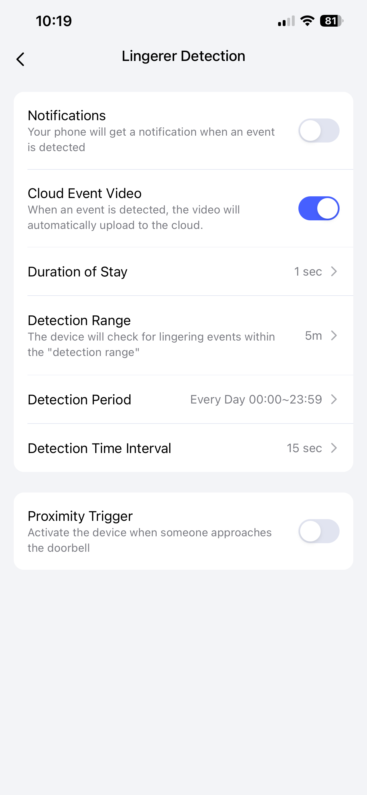

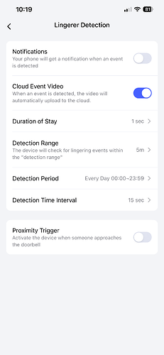

  1. it is on external power mode
  2. Loitering detection is not present in the app. There is Lingering detection and it is enabled, see screenshot.
  3. When set to 0s it records some videos during the night but only to local storage. I never see anything in Coud videos (I have no subscription).
  4. I enabled Proximity trigger and it does not help.
