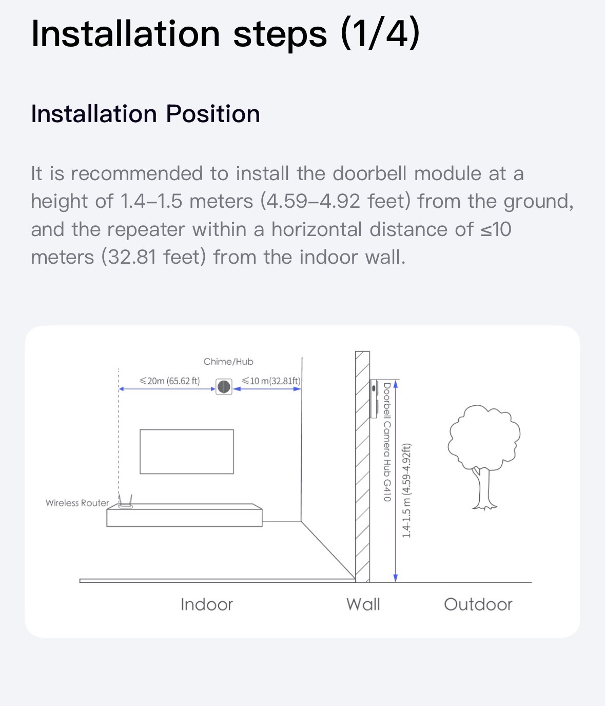

Hi, my G4 doorbell is pretty far from the nearest point I can have the hub. So the signal is weak and batteries are drained every month or so.
How does the range of G410 compare? I couldn’t find any spec to justify improvement expectations (like zigbee 3.0 vs zigbee or other)
Hello @akis_papadopoulos
G4
G410
G4 and G410 use wifi for communication and even if there is a zigbee hub nearby, it will not improve the quality of the wifi signal.
If you still have zigbee devices at a long distance near your G4, then the G410 is more suitable for you because it is a Zigbee hub and Thread border router.
