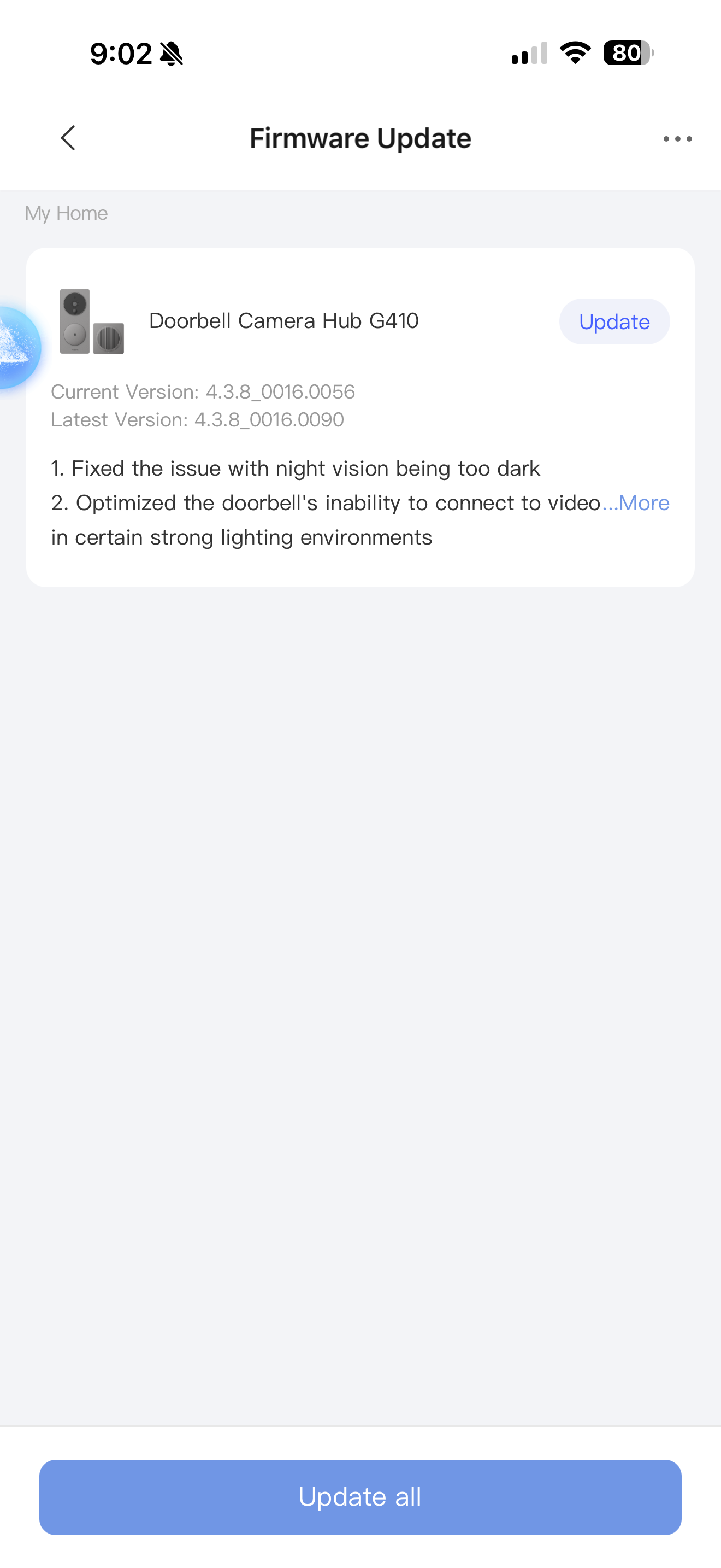

Firmware won’t update. I’ve forced the unit to a 2.4 band. I think it’s time to give up
Are you trying to download the update via the Aqara app or another system, such as Apple Home? Did you receive a specific error message? What version is displayed under device settings in the Aqara Home app? Could you take a screenshot of the firmware version or error message?
I’m using the Aqara app to “update”. I’ve probably tried to do it 25x. It says it downloads and installs sometimes, but when I come back to it it’s still on the old version. I cannot believe how difficult this doorbell is to work with.
The failed update strongly suggests connection drops during the installation process.
Did you manage to check any of the points I mentioned above? Let me know what you’ve already ruled out (especially regarding the mesh network or power supply) so we can narrow down the issue.

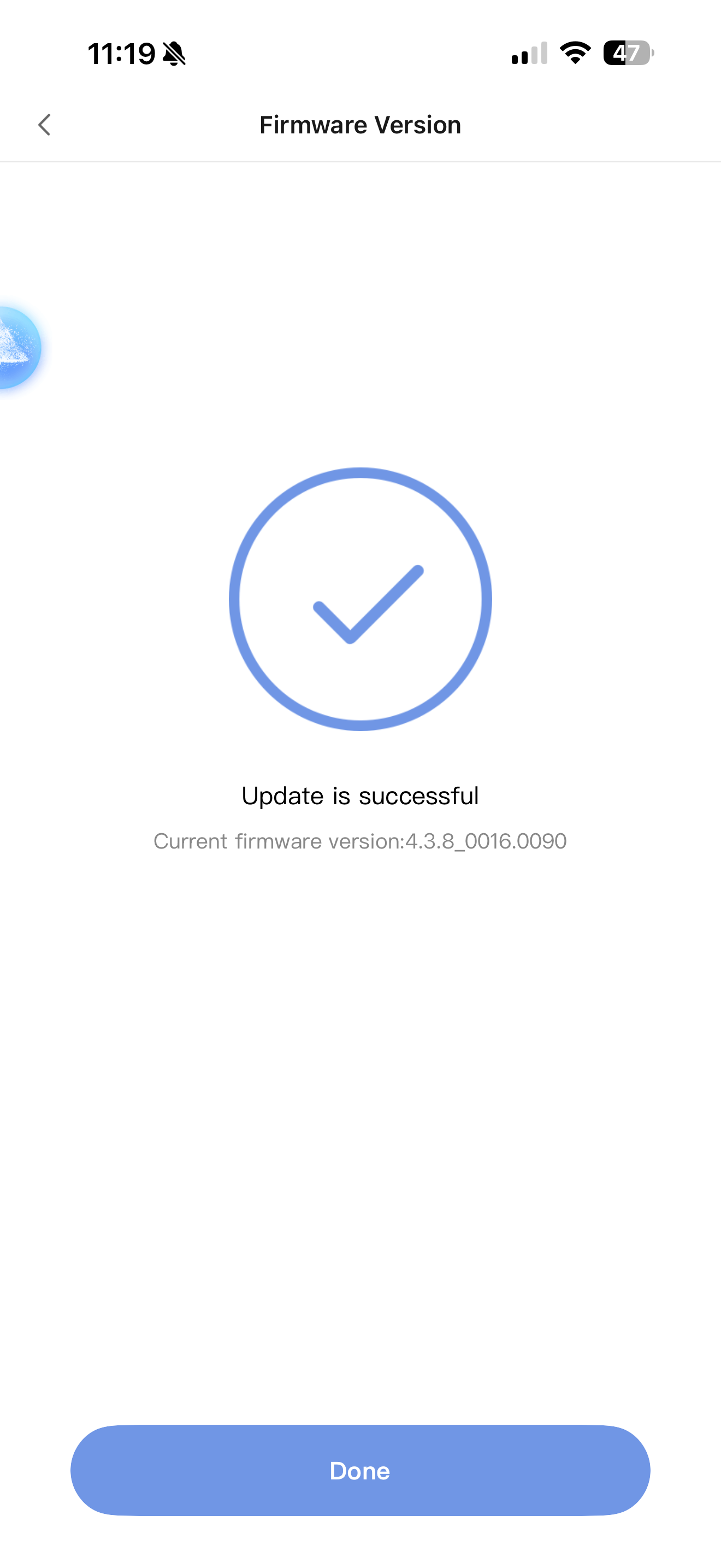

I installed my G410 about a month ago and love it. But I have had a few frustrating experiences with my home automation journey. A couple of times I found that deleting a device and then reinstalling it fixed everything.
The one thing I have found during this journey is that the people on this forum are truly helpful and, dare I say, kind. A rare commodity these days!
But it still always shows that it needs updating
