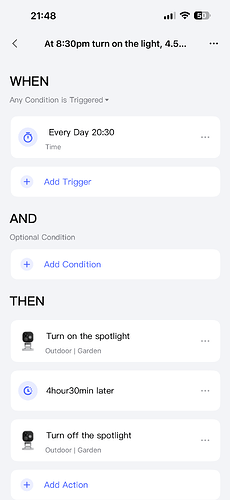

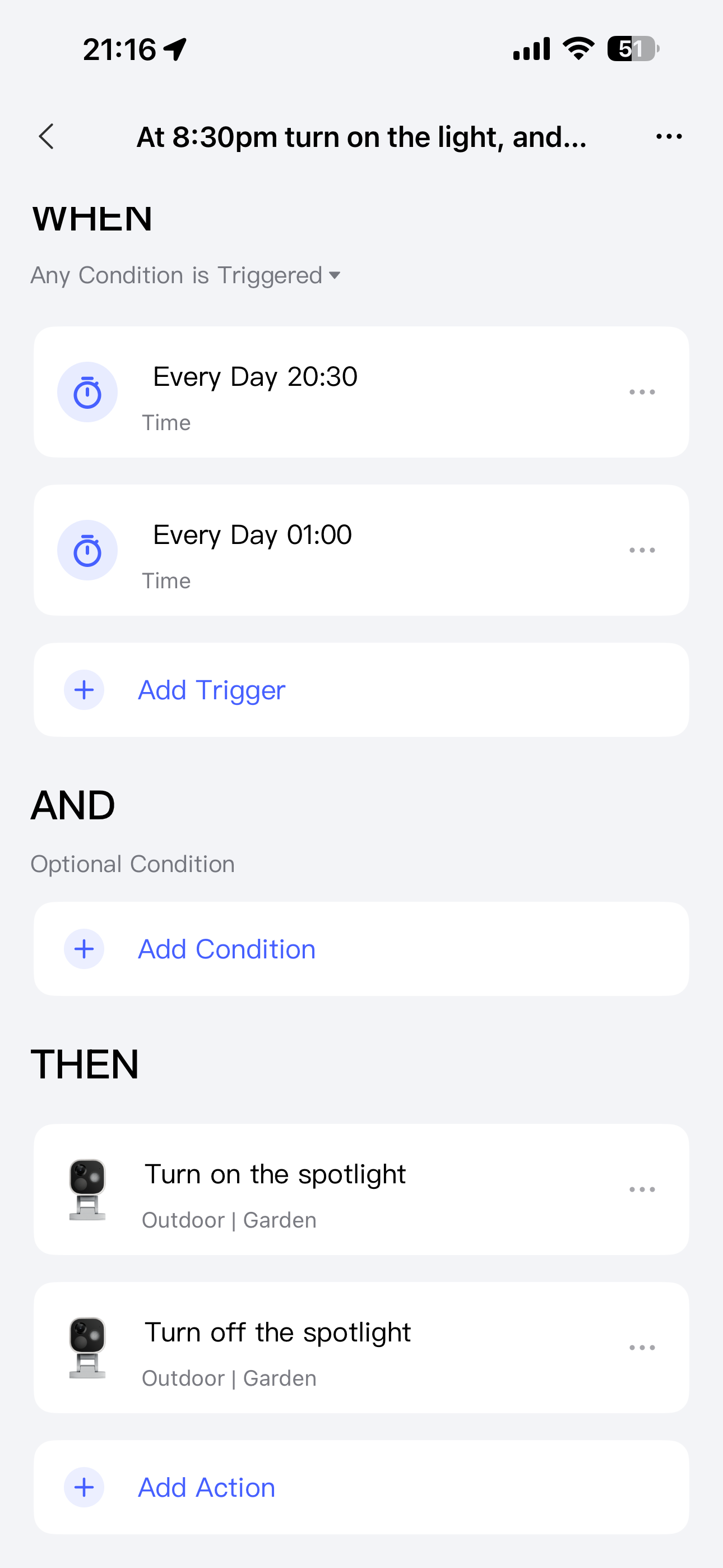

I set up an automation to turn on my camera light at 8:30pm and go off at 1:00am but it does seem to work at all.
Any ideas what I’m doing wrong please.

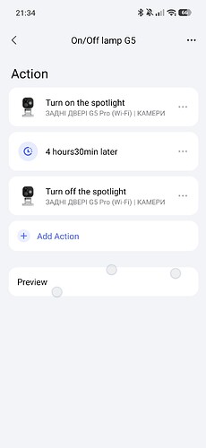

I would recommend making the following two adjustments:
  1. Remove the option “every day 01:00” in the “when” section.
  2. Add a duration between the two options in the “then” section. Set this duration to 4 hours and 30 minutes.

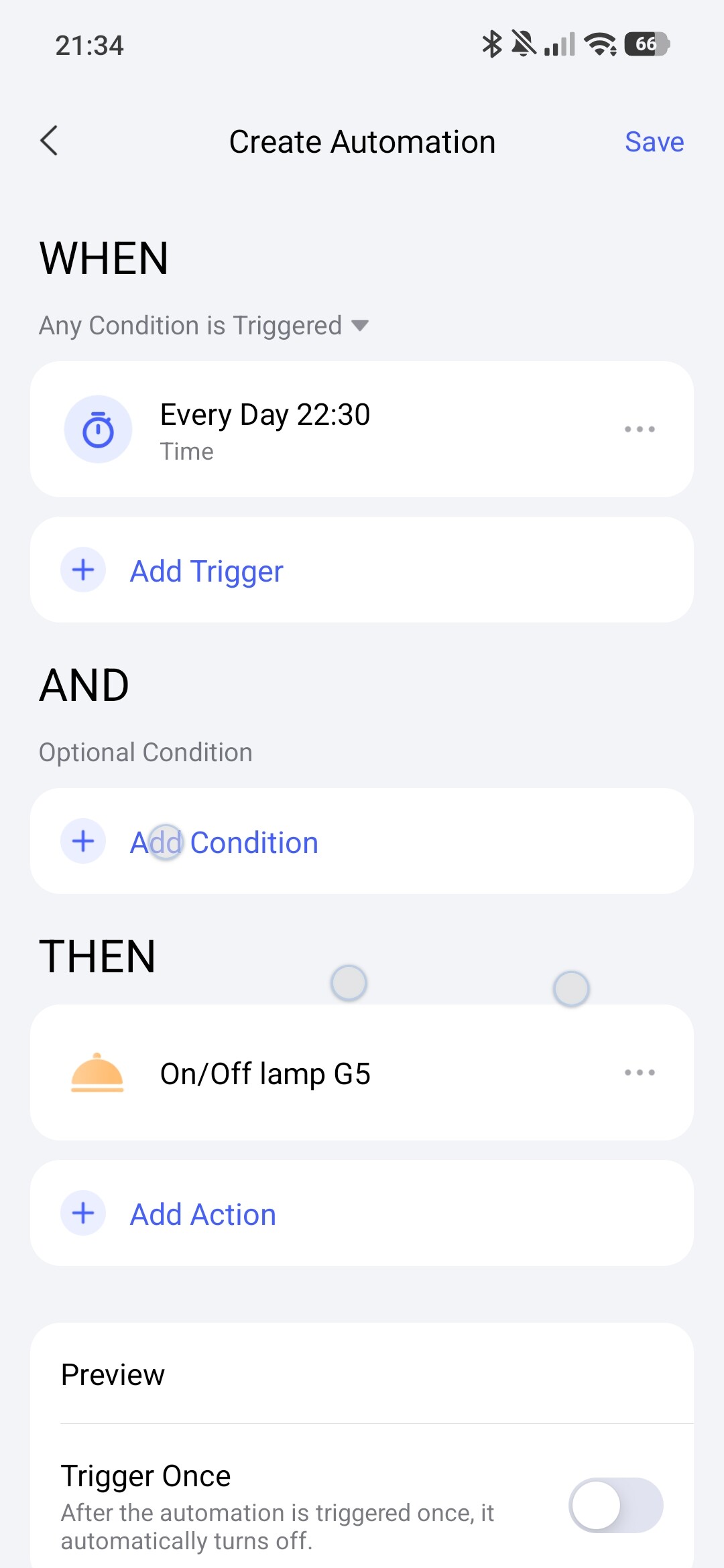

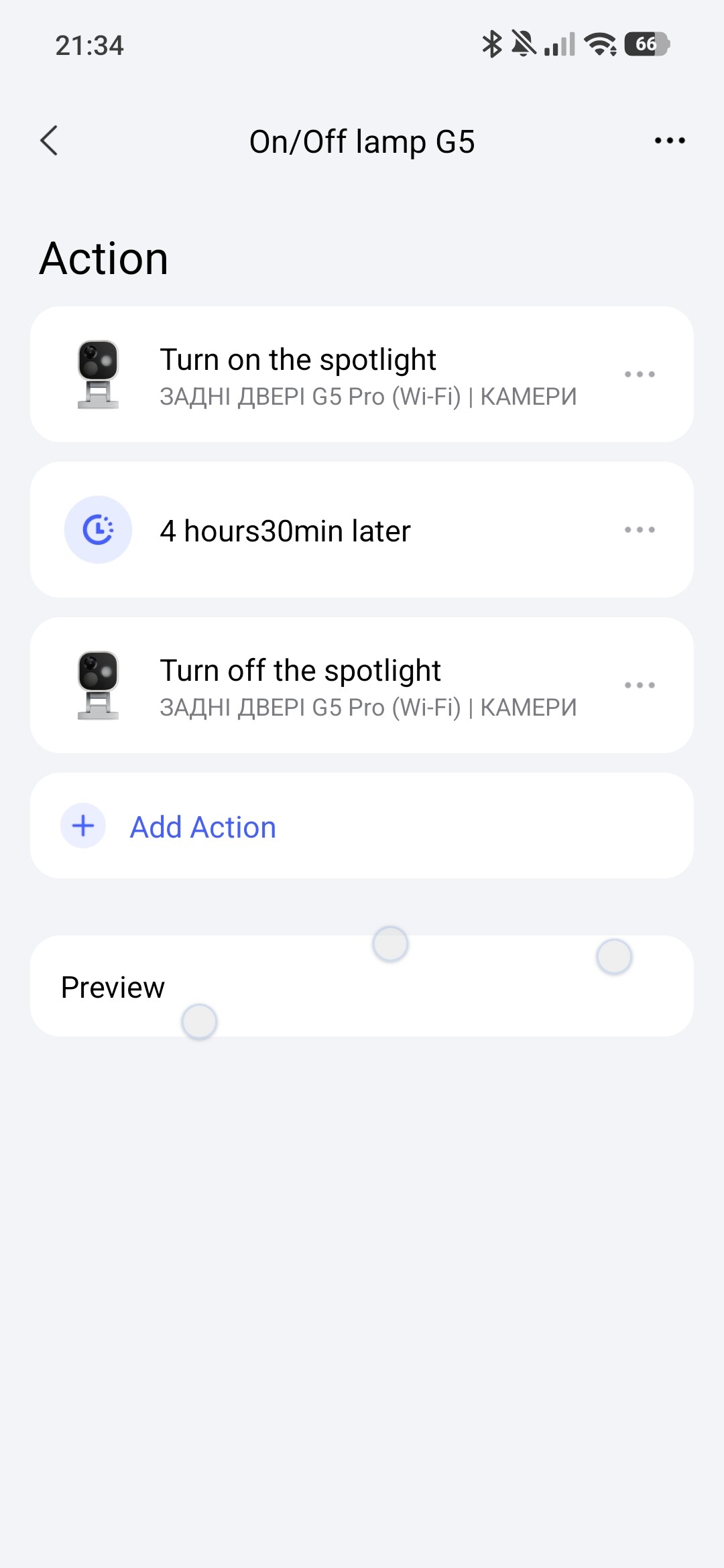

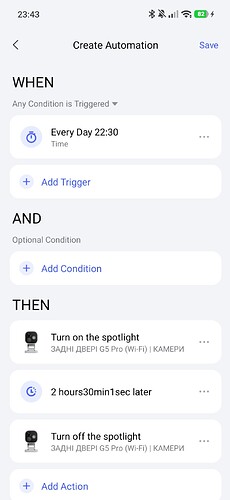

Hi, welcome to the forum. Make this automation.

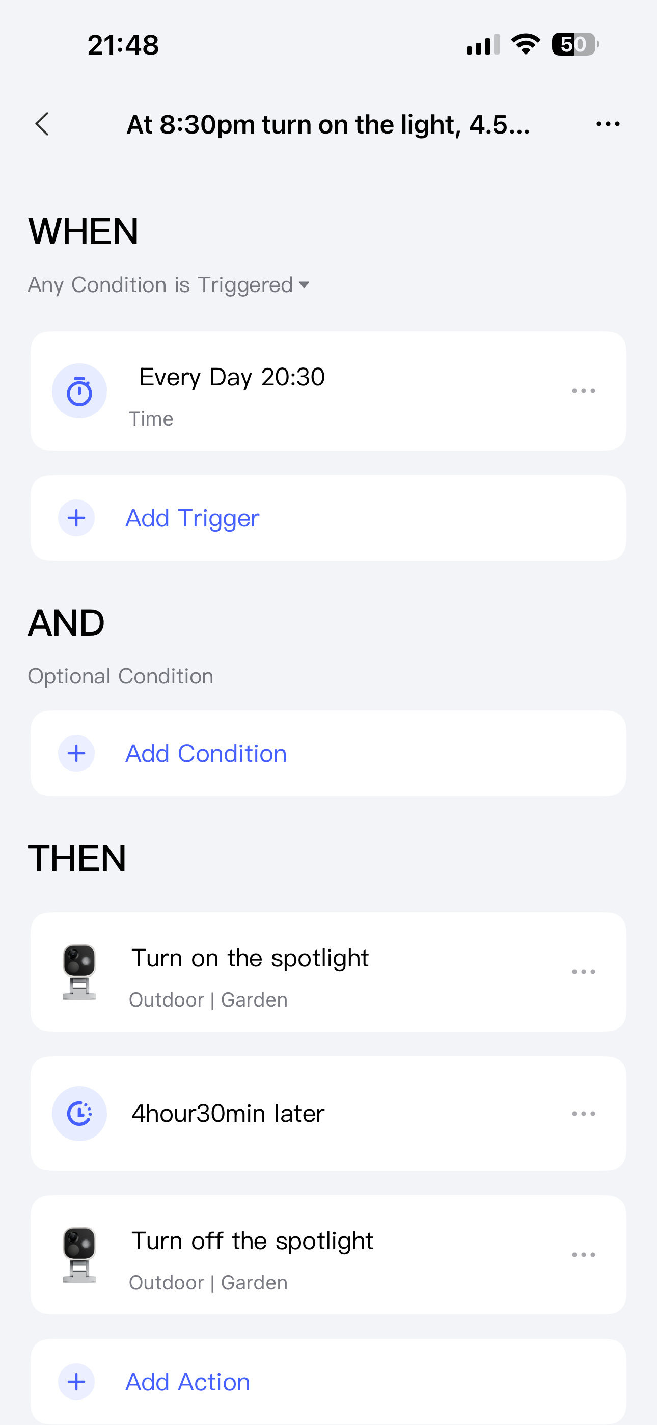

Thank you to both of you for the very quick reply.
I have set this up and will test it out.
I did try “at sunset turn the light on” first of all but this never worked either.

Just to say the automation with the delay set to 4.5 hours did not either.
The light was still on this morning.
Thanks

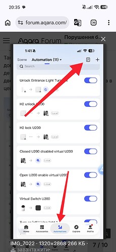

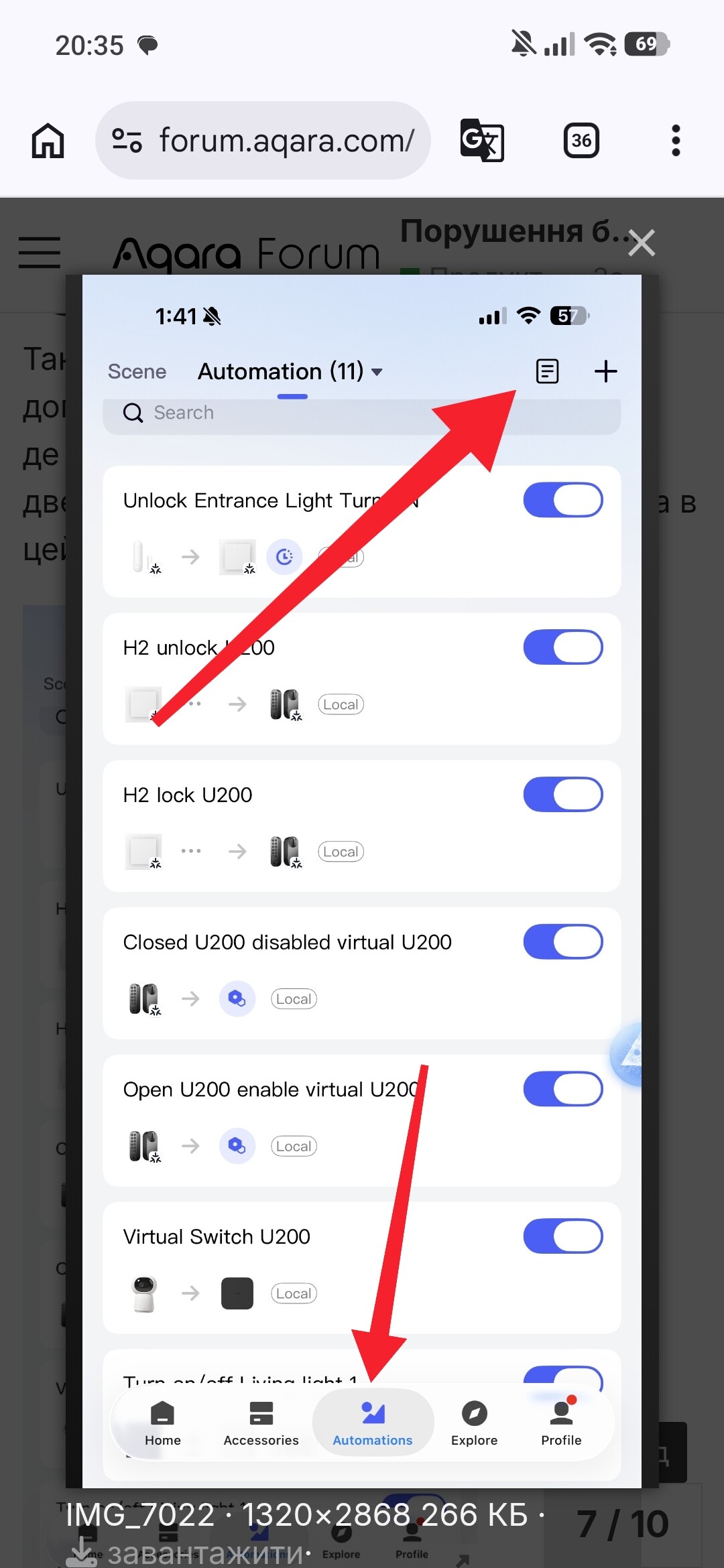

Check the event log, maybe another automation (old one) has started the lighting again. You can see this in the automation event log.

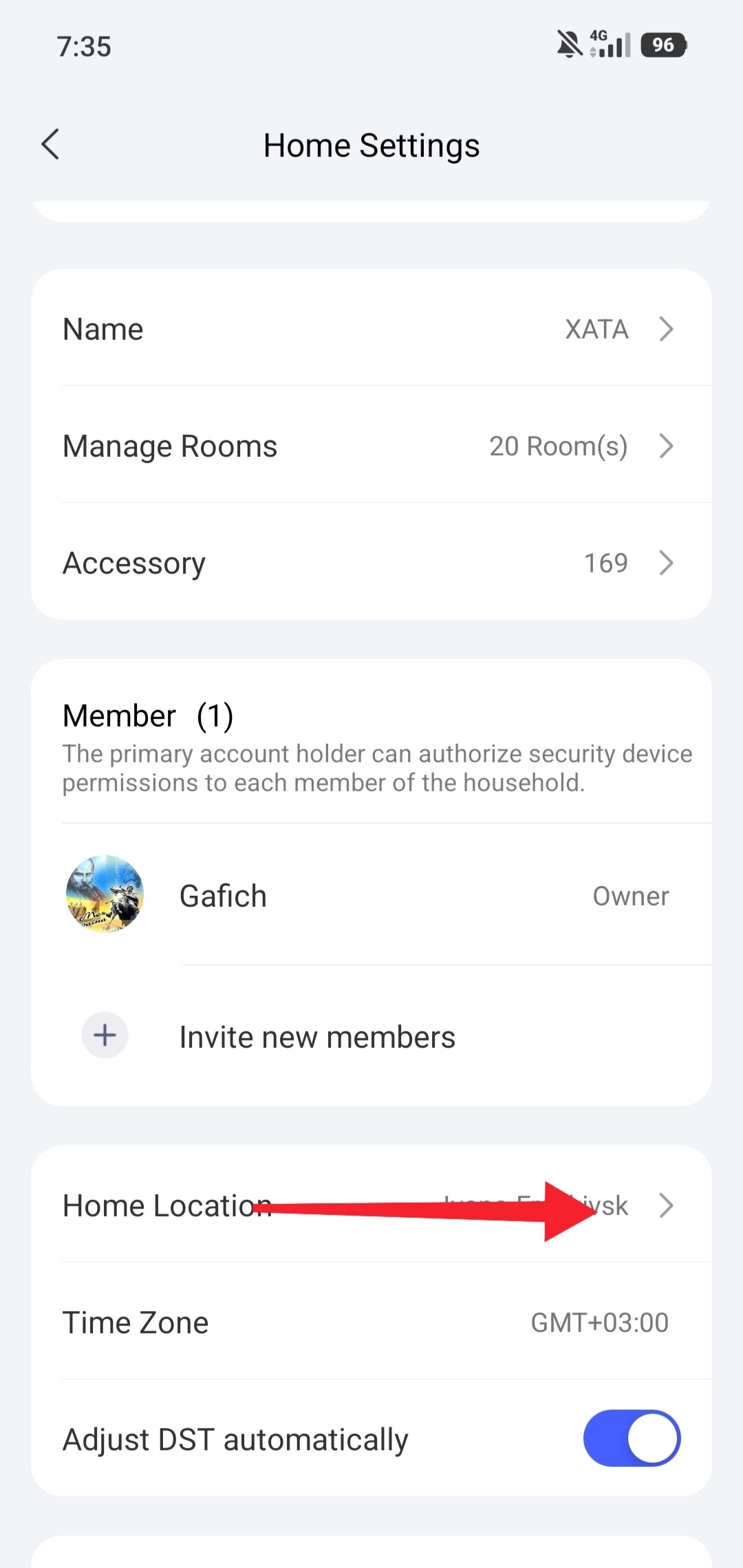

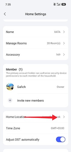

Also check your location, linking the house to your region.
Ok thanks will check soon.
Nothing in my logs, I only got the g5 pro a few days ago as well.
I can’t find the home location setting ?
you have to come here.

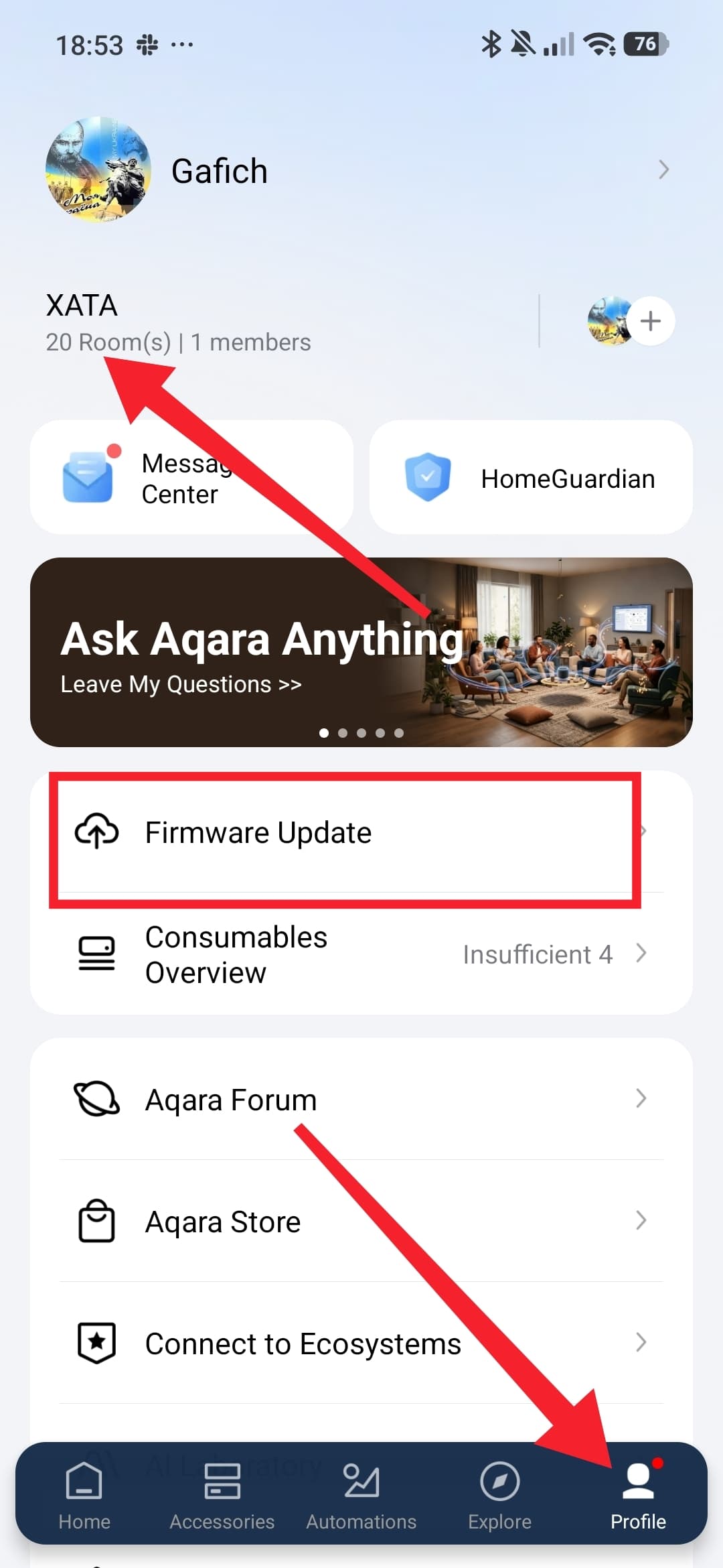

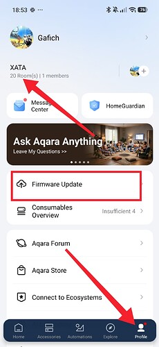

Also check if you need to update the G5 camera firmware
Ok thanks, yes the location is set to my home town, so this is correct.
Firmware all up to date, I do this whenever I get a new Aqara device and also check regularly.

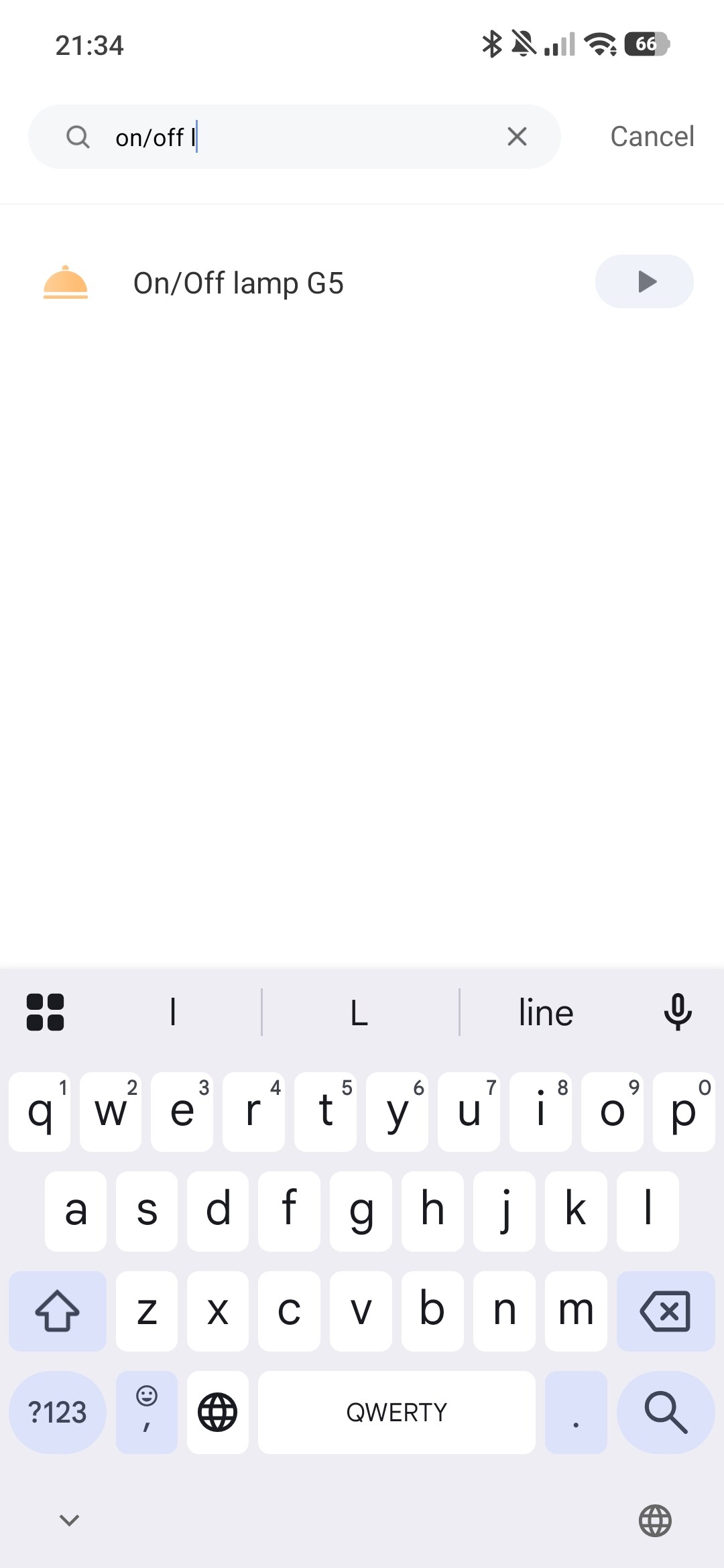

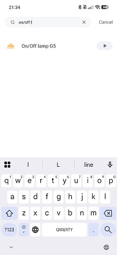

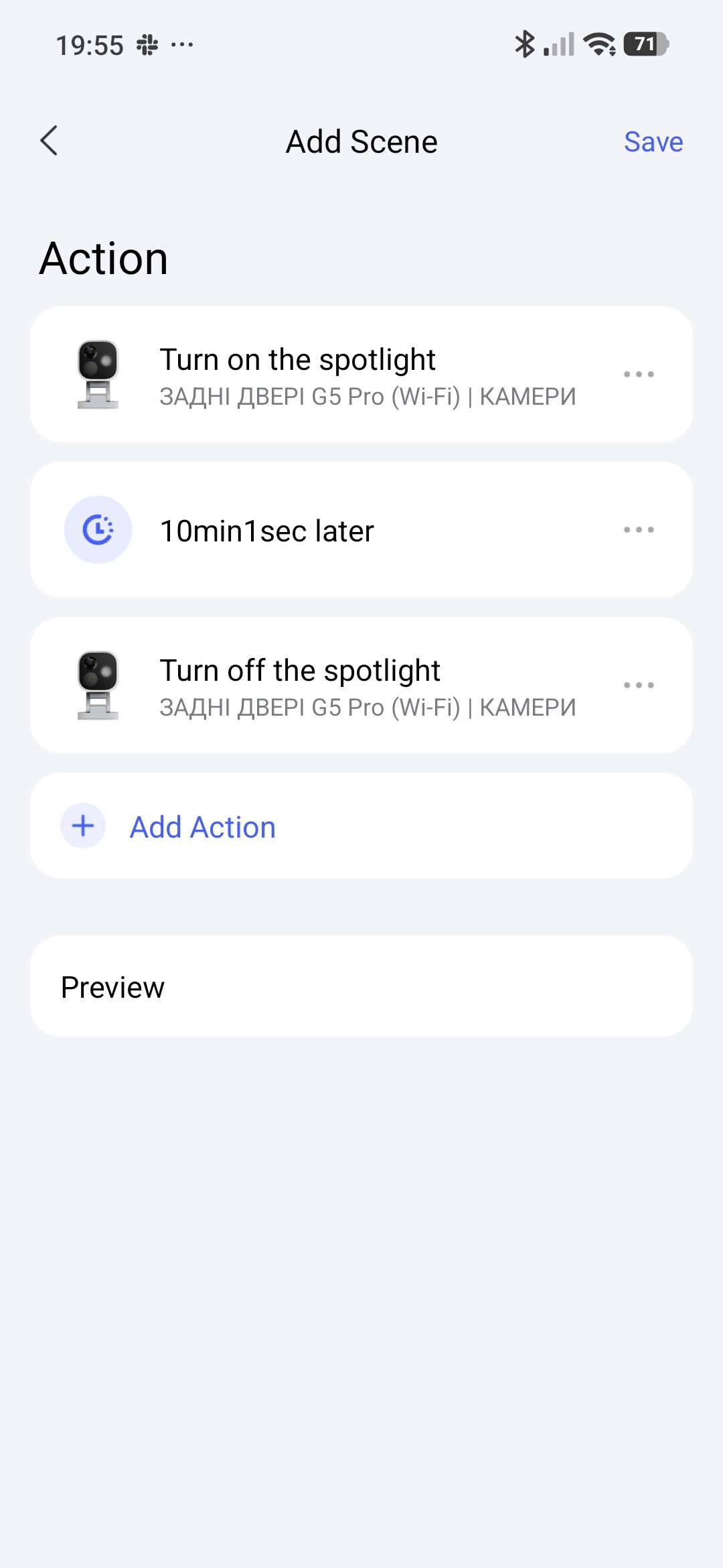

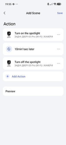

Then make the following scene to check the On/Off operation of the G5 light. As a test of correct operation.
Yeh that works fine, I set it to 3 mins instead of 10.

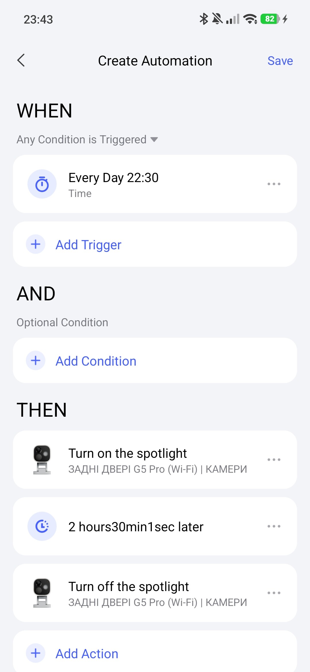

Make this script with your time (4.30 hrs) and use it in automation.
WHEN 22.30,
THEN run scene .
Sorry what do you mean by make a script ?
