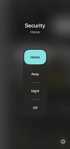

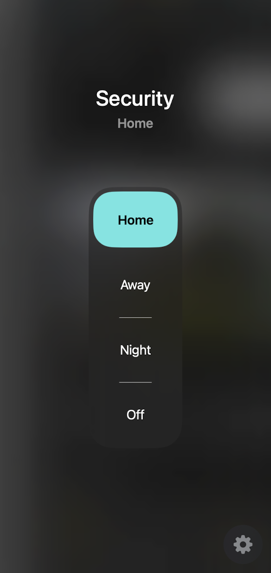

So I have my G5 Pro (Wi-Fi) connected to HomeKit, and I now have “Security” but have no idea what it is and what to do with it. I visited my local Apple Store and they said I needed to speak to Aqara, so here I am.

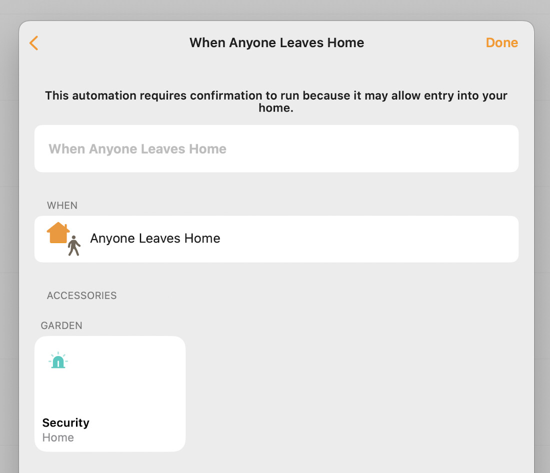

There are 4 options - Home, Away, Night & Off. Interestingly, if I create an Automation to turn any of these on I am told “This automation requires confirmation to run because it may allow entry into your home.” That’s NOT an Automation in my book!
I’m baffled, anyone have any idea what this is?

  • But automations still need confirmation (Apple’s rule, not Aqara).

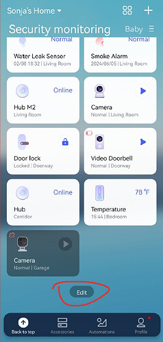

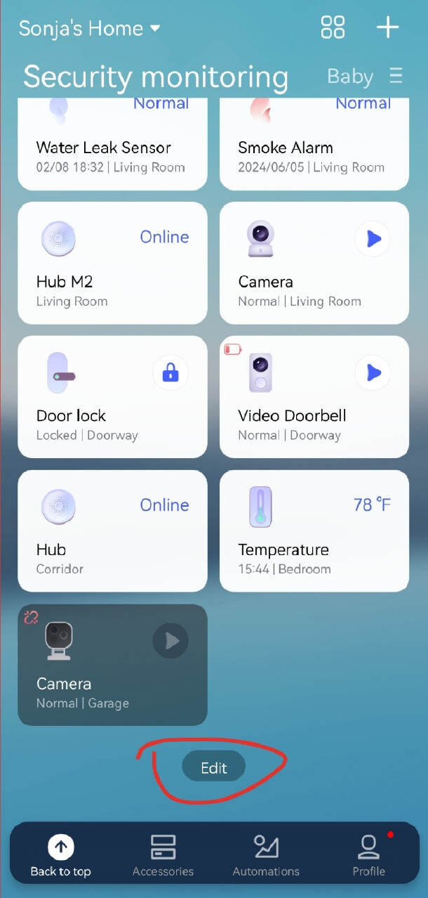

  2. Tap “Edit” at the bottom,

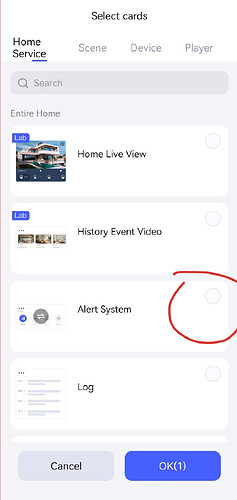

  3. Add the "Alert System“ card,

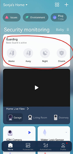

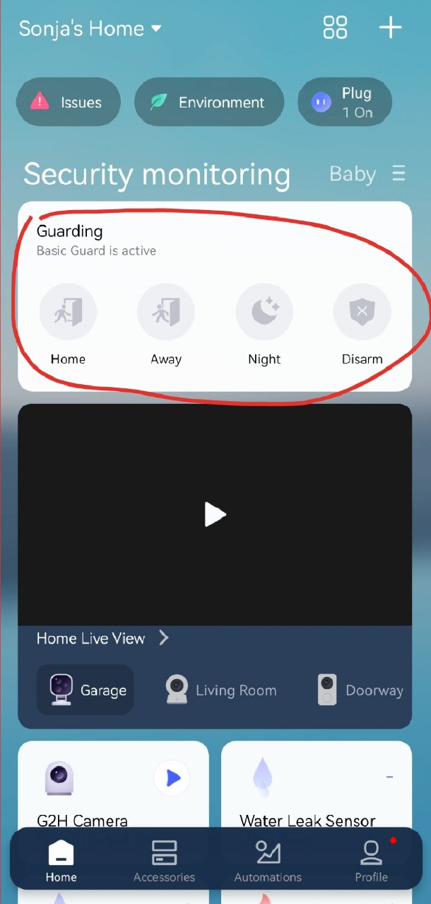

  4. Then access the security details page via the card to configure it.
Hi Sonja, thank you so much I’ve added that card and got it all setup.
