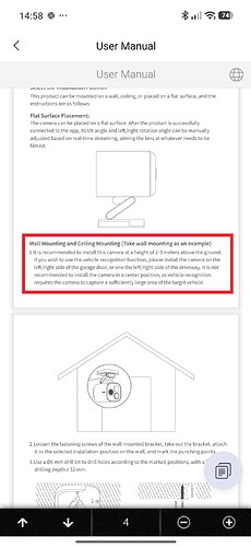

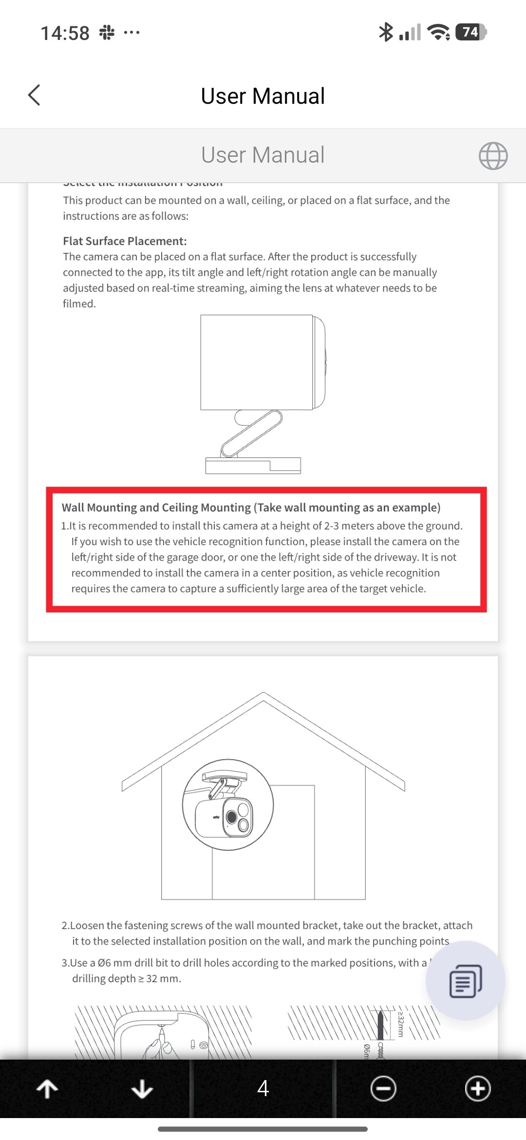

Hello, welcome to the forum. The problems with artificial intelligence you described are related to the height at which the G5 camera is placed. I had this problem until I placed the camera lower. The recommended height is 2-3 meters.
Hello gafich, and thank you both for the reply and welcome.
The camera is at a height of 2.56 meters inside to have overview of the garage. But good to know the operational height limits, so thank you!

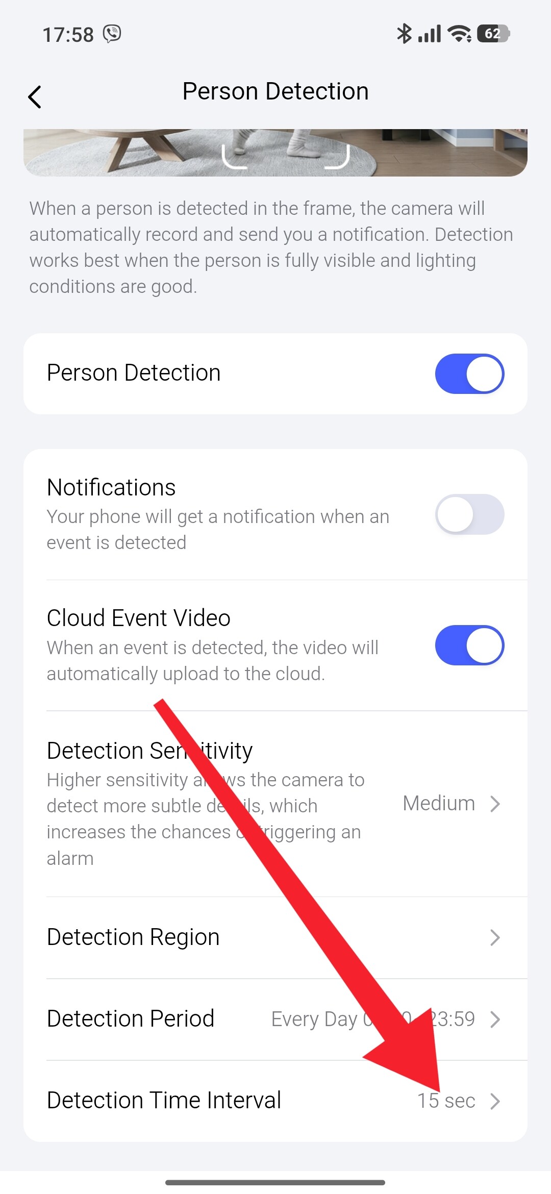

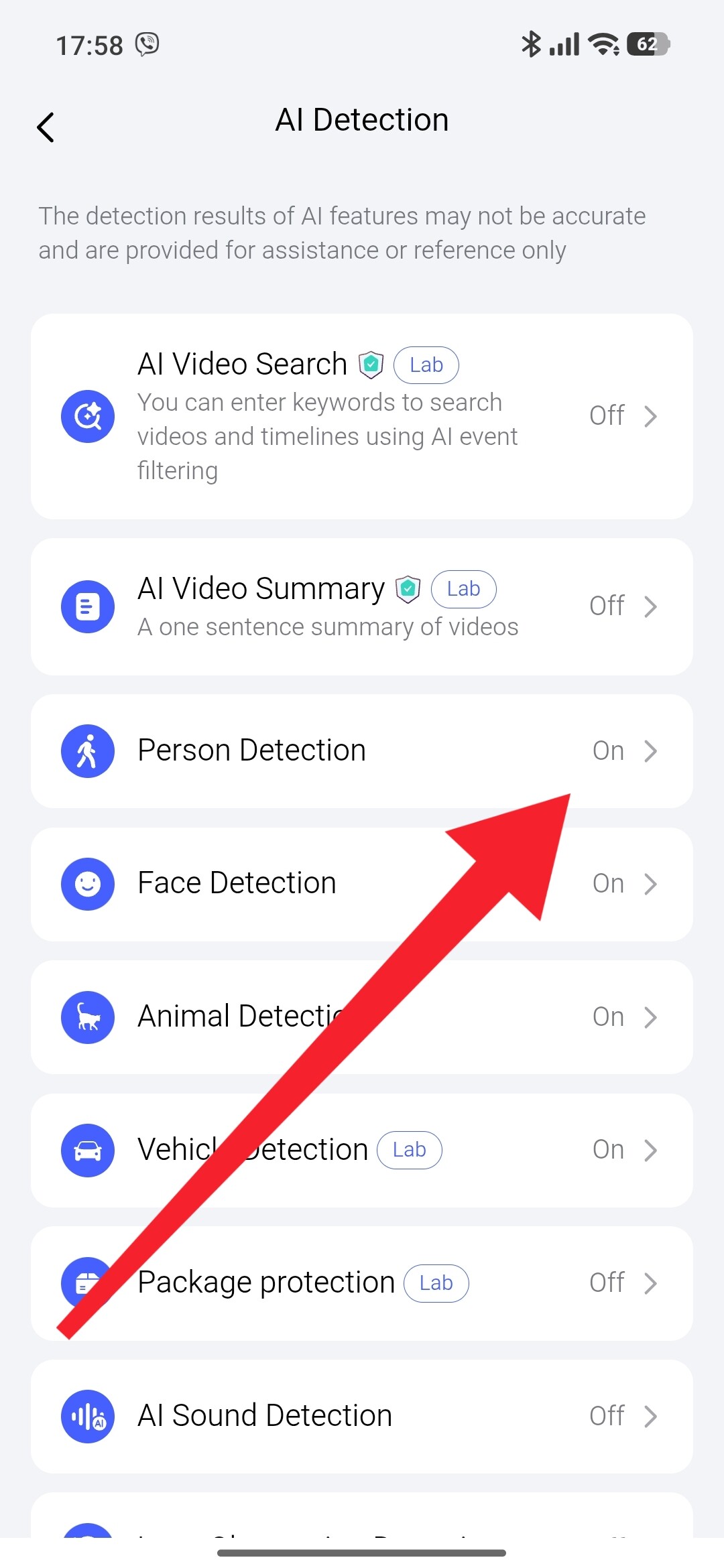

Check these settings to increase the observation interval.
Using this automation, you can automatically turn on the spotlight when moving at night.
